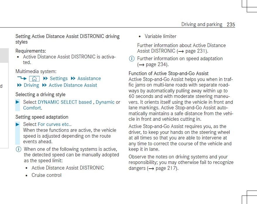

Doing away with the car responding to speed limit signs
Here's what my complaint is. Your driving at a posted speed limit of 75mph. Then a speed limit sign says 55 mph speed limit. The car drops from it's distronic set speed limit to down to 55 mph. Is there anyway to eliminate the car from doing this ?
In ECO mode it's dangerous imho. Just mush if you floor the pedal in ECO. Thanks for reading this.

Yes, and it's all in the owner's manual. Just need to read it. On page 235 it explains where you can turn off all the various speed adaptations. The owner's manual can be downloaded as a PDF as well, so you can search it: https://www.mbusa.com/en/owners/manuals for USA. Go to the respective MB site for your country if not in the USA.

Go to the assistance section of the settings menu. Under traffic signs or something like that you can uncheck limit adoption which will stop the car from changing speed based on signs.

Ok. Found it under ADOPT SPEED LIMIT. Had manual online prior to buying the car Thursday and have the car manual that came with the car.
Sat in the car one night and tried to find a setting that would remove speed limit signs and missed it under Distronic.
So thank you SUPERSWISS.
