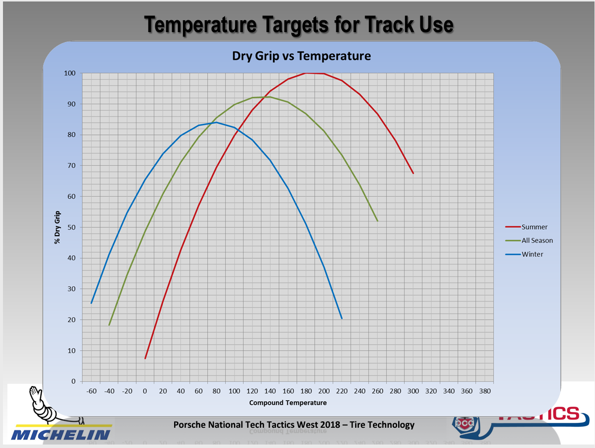

I am surprised that parts manager recommended summer tires, esp when winter approaching. This is warning from Michelin, not to use summer tires below 40F:
You can see when the tires performance with temp. Summer tires turn to ice pug in winter...

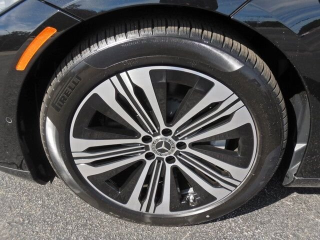

P ZERO ALL SEASON PLUS ELECT-Tirerack
P ZERO ALL SEASON PLUS: THE ELECT REVOLUTION ALSO FOR REPLACEMENT
Pirelli P Zero All Season Plus Elect on Tesla
Car listing shows the tires as 255/45HR20.0
https://www.centennialimports.com/ne...9b580a765c.htm
You can also call:
https://www.mbusatirecenter.com/
Contact a Tire Expert:
833-919-1614
Since they are new tires, you may not find them in stock for a while. It took nearly 9 months for Michelin 21" AS T0 tires to be available at tire rack...I even called Michelin last year as they were planning to manufacture winter tires before A/S's. I ended up getting winter set, because there was no A/S stock available. Maybe Pirelli supplies might be better.
