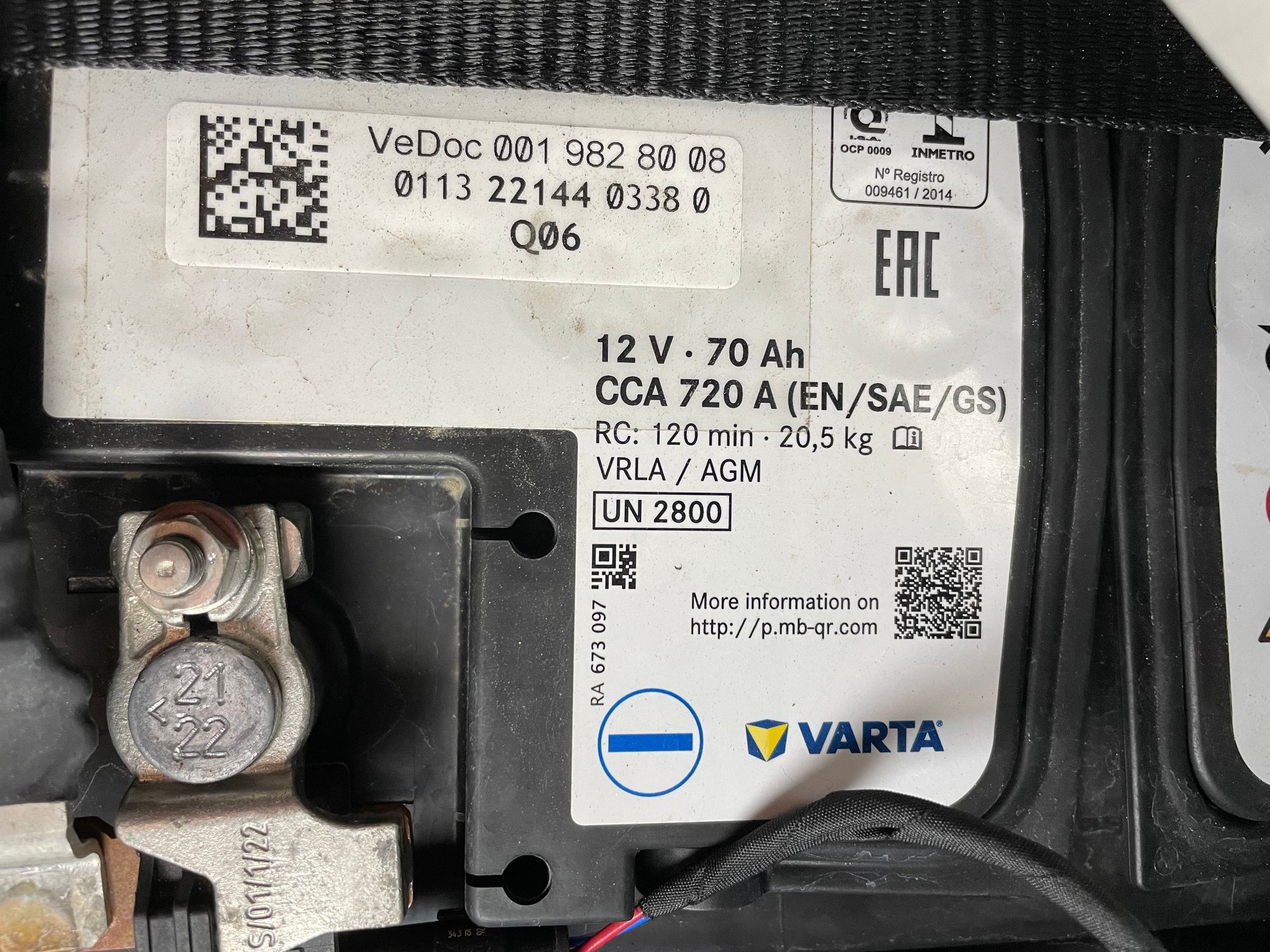

The 12v battery is not like a regular 12v starter battery in a IC vehicle. I believe in the EQS it is much smaller in size and capacity.
I have not personally opened up the hood on my EQS so I can’t verify the size of the battery but I asked my service manager that question. First response was smaller battery, then I was told it’s pretty much the same size as starter battery. So basically I have no idea what size it actually is.
720 Amp hours Cold Cranking is big but a 70 Amp hour capacity is very small. Someone correct me if I am incorrect. I get some of this mixed up…

Originally Posted by Crito
I've read that some EV BMS stop charging the 12V when the high volt battery's SOC gets too low. Would be interesting to see if that's the case with Mercedes too.
I do not see why one would need a 700+ Ah battery, as you do not need to power a starter motor for a large engine. The EQS 12V battery only runs the various computers, displays, etc., and perhaps the heating/cooling system. Starting the car is turning the multiple computers on.

Interesting....never looked at mine. Makes sense, though, since it does not have to crank an ICE.
The air conditioning compressor, heater coils and cooling pump for the batteries are probably sources of large power drains. Also the battery has to be sized for those rare occasions where the majority of 12V items are on at the same time including headlights, radio, massage seats, windshield wipers, defrosting etc.

Some confusion with figures here. It is not 700 Ah but 700 A current delivery capacity (for ICE cold start cranking). 70 Ah is the battery capacity and this size is used by many Mercedes ICE cars (gasoline engines/no cold country). Starting the ICE car needs a lot of current, not that much energy (Ah) as starting takes a short time.
The EQS does not need this high peak current capability. High power accessories are run from the high voltage battery (heating circuit, AC compressor etc.).
Thanks for pointing out the obvious error. Ooops. Of course, a 700 Ah battery would supply ~ 100amps for 7h, which of course, cannot be done with a small lead acid battery. I assume the 70Ah battery supplies ~100 to 300 amps for a few seconds at one time to the starter motor of an ICE.
