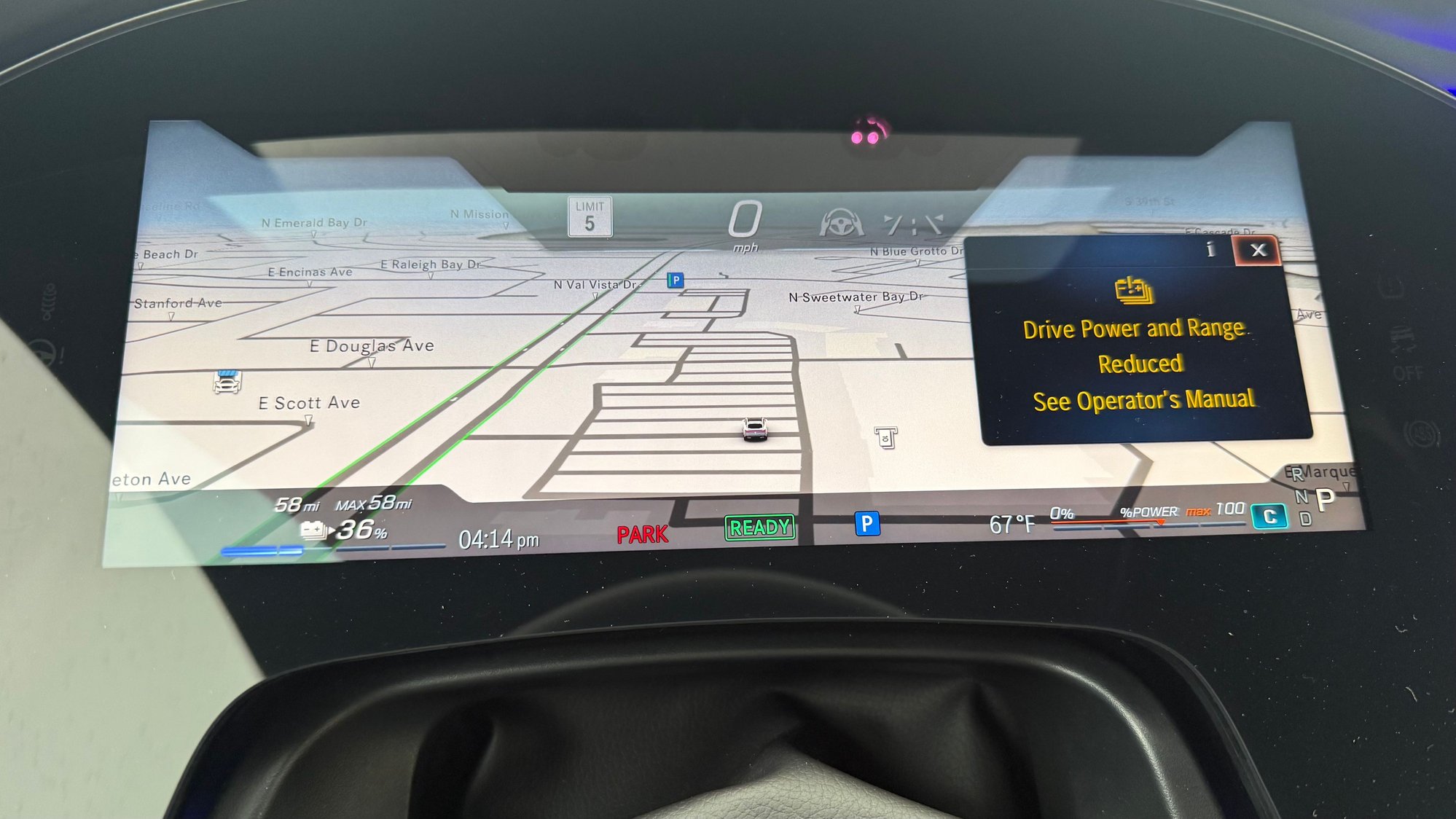

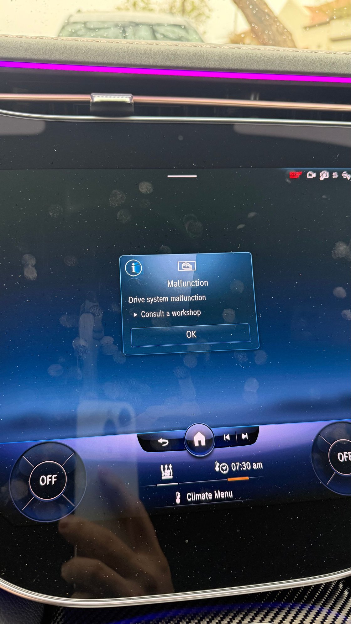

Picked up my 23 EQS AMG a couple weeks ago. Noticed a battery malfunction error popping up, so dropped it off at the dealer last week for that the driver door handle which has been non-responsive. It will present on approach, but doesn't lock the car when touched. About a week into being at the shop and still no real updates. Germany's engineers are involved and the Mecerdes Me app is doing a great job of keeping be posted on the prodding.
I'll attach some pics of the error messages. Looks like these are fairly common amongst the EQ lineup and range anywhere from needing a new 12v to an all new high-voltage battery.

Dash Error
Dash Error
Home Error
Home Error

Mar 20, 2025 | 10:16 PM
Received an update from the SA today. Looks like Mercedes is recommending a full HV battery replacement. Parts are already in route. Which is kind of exciting to be honest. No real details yet on what the determining factors were to warrant a replacement, but it'll be nice to have a clean slate battery.
