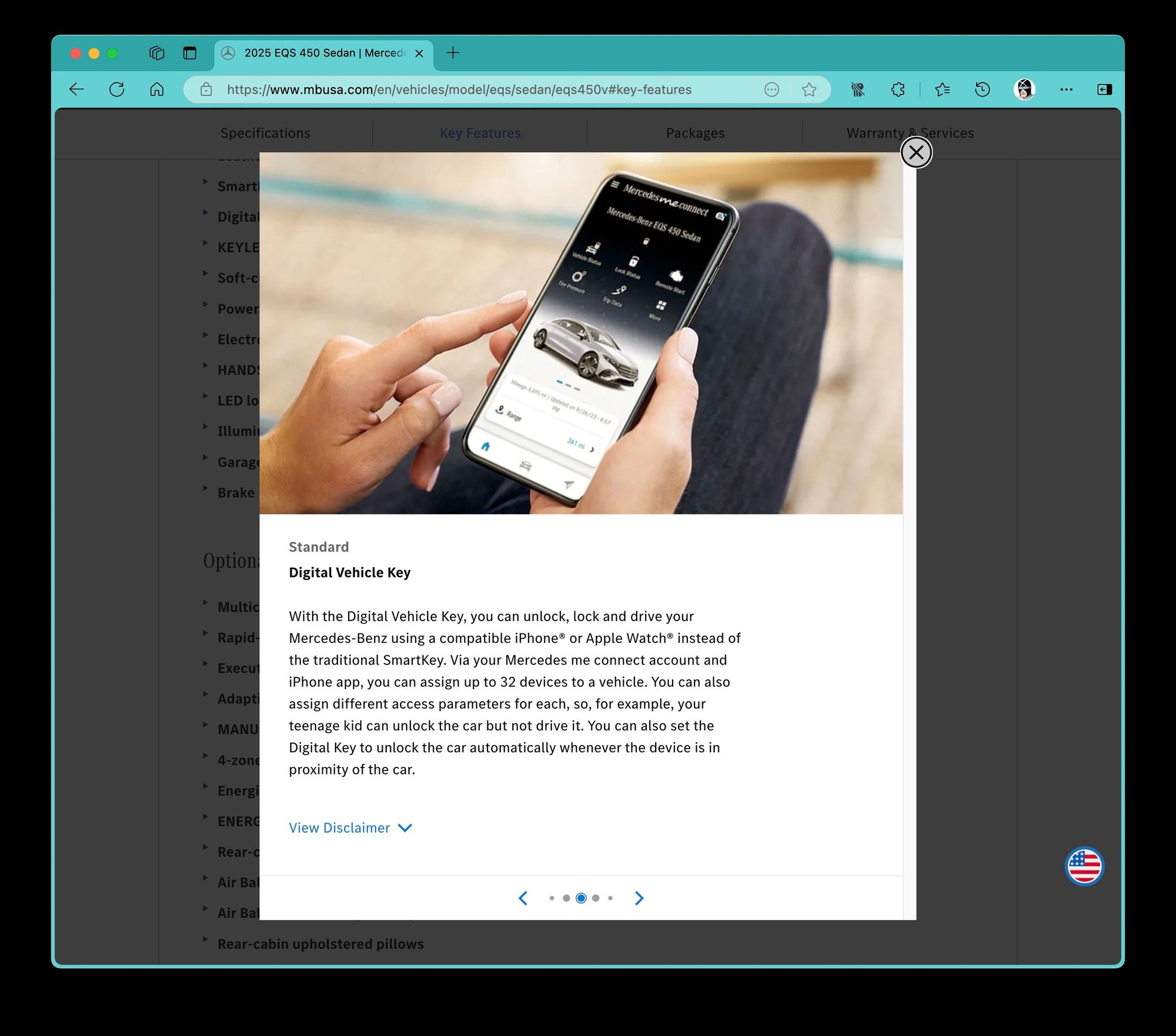

There is probably a very simple answer on the EQS models (Sedan and SUV) along the lines of "If your car was produced on or after this date, it has Digitiall Vehicle Key. We're overthinking this. Pretty easy guide is online.
https://www.mbusa.com/en/owners/manu...al-vehicle-key
