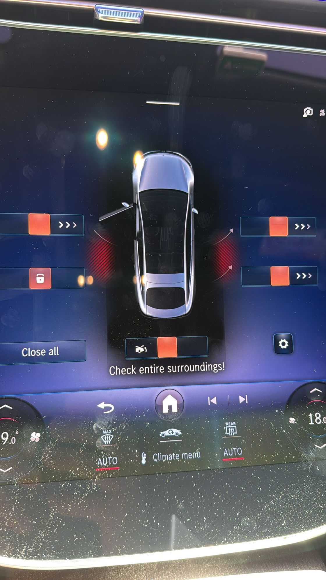

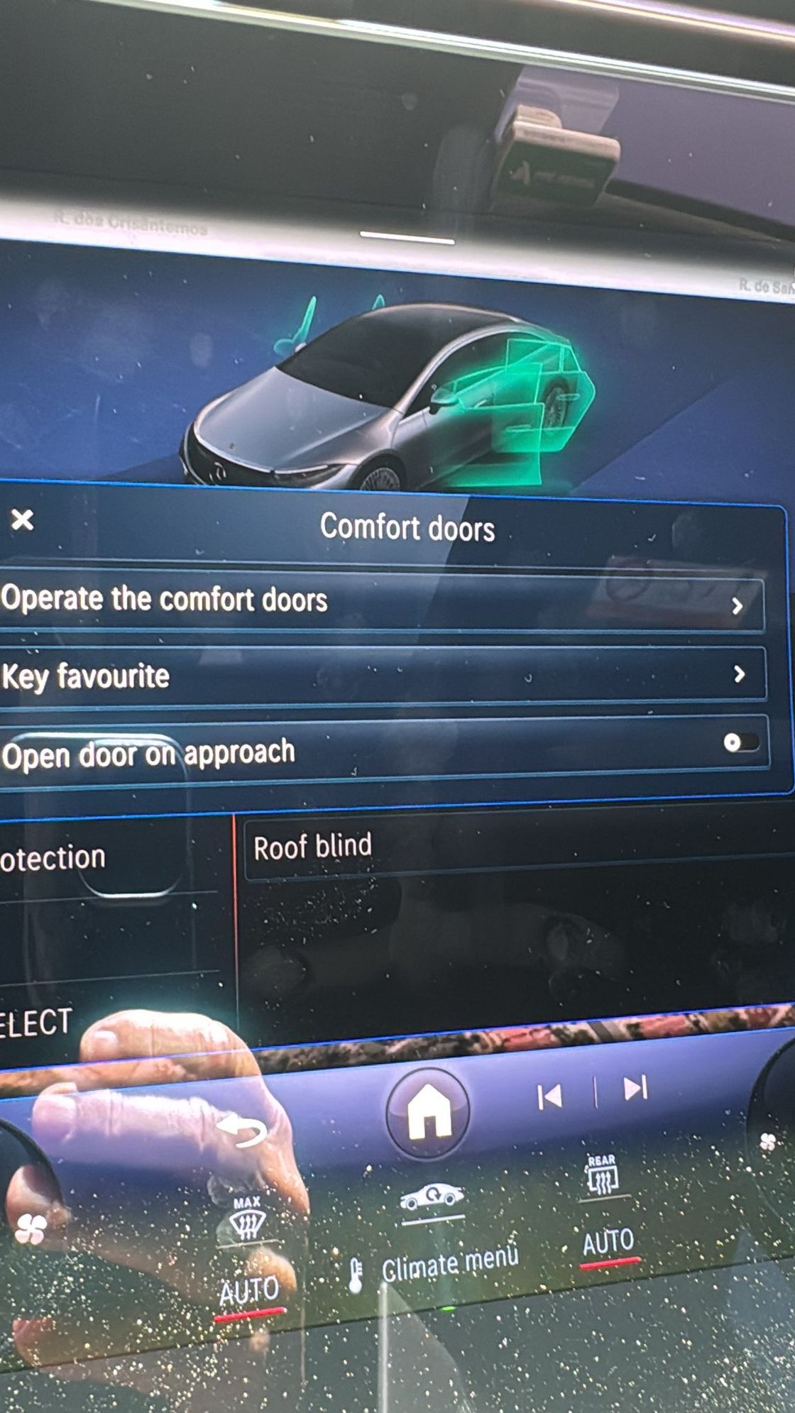

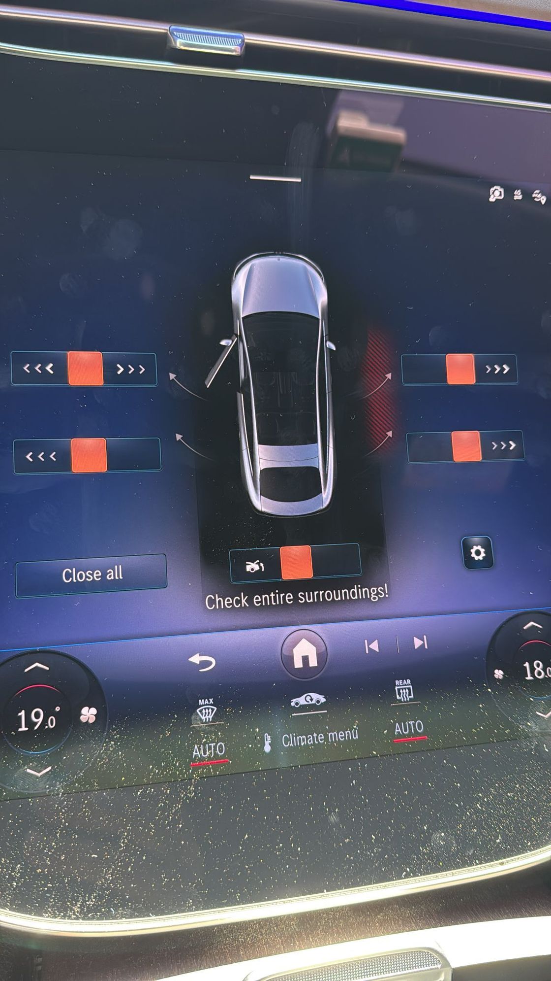

Comfort Door Activation for EQS from Europe, yes, just by coding!
Dear all EQS owners, if your car has no Comfort Doors like below video: do check with us with your VIN, or you can do VIN decoder to see whether your car has option 9S8, 67B, 68B.
you can now get these features working by just remote coding:
1: Step on brake and hold to close the driver door.
2: Use Key button (hold unlock button to open the driver door)
3: All four doors are controllable in MBUX screen, open and close by your finger, one button to close all doors.
4: Touch door handle sensor to close and lock the door.

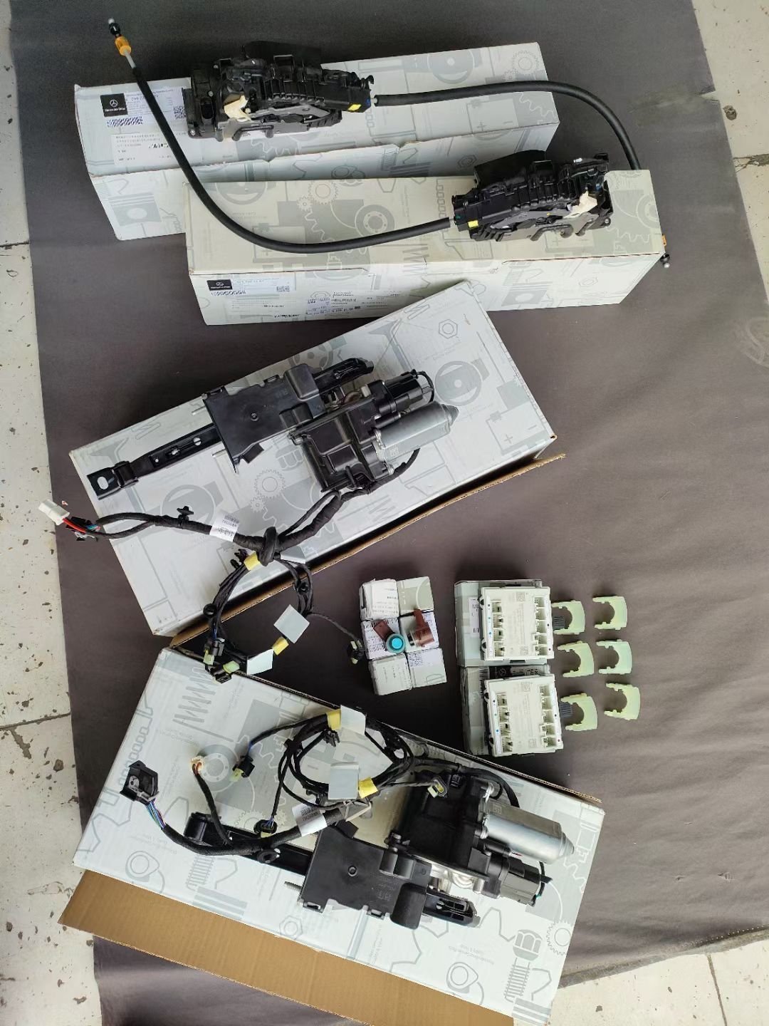

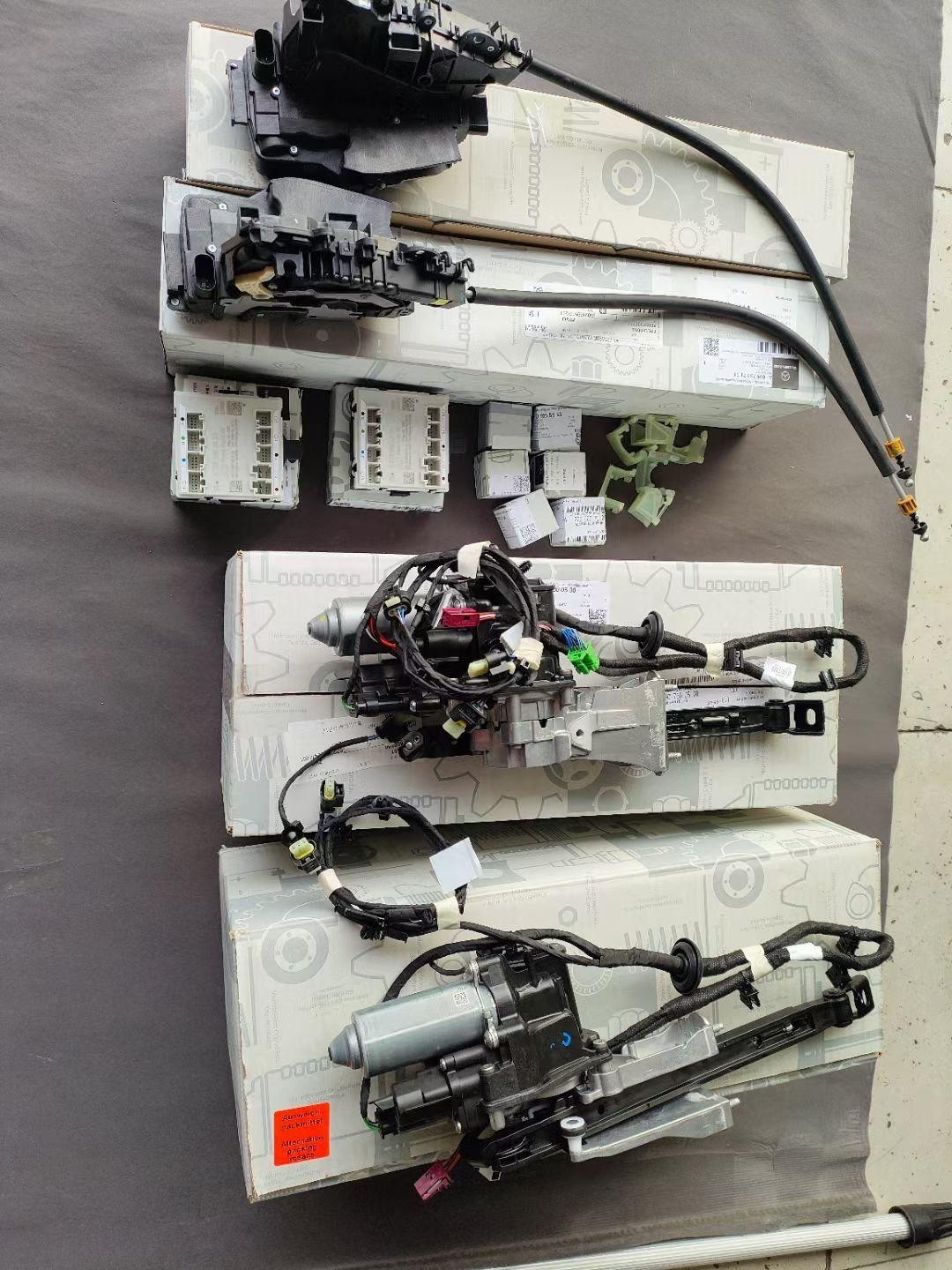

Whole kit available for sale: all genuine Mercedes brand new parts.
How easy (complicated) is it to install those?
Is it all "plug and play" or does it require drilling or some other intrusive options?
Can these be installed in all EQS or are there certain requirements?
Thank you
Thank you
According to my experience, relative difficult job. Yes, can be retrofitted in all EQS, all 296 297 can option for this Comfort Doors.

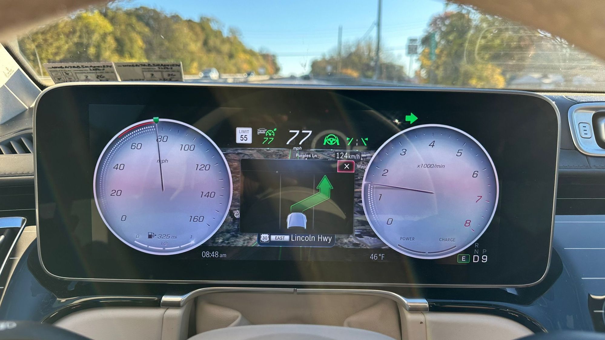

Something new to those EQS without K46:
K32 to K46
K32 to K46
W223 S580 USA 2021
W223 S580 USA 2021
K32 to K46 Activation ✅ ✅ ✅ Active Lane Change Assist to Automatic Lane Change Assist - MBWorld.org Forums
Sorry i'm confused.
Is a 2022 EQS 580 a EZS223 model?
Can a 2022 EQS 580 be upgraded form Active Lane change Assist to Automatic Lane Change Assist?
Yes. No Prob. this K46 is for all EQS (296 297), EQE(294 295), SL (232), S (223), E (214), GLC (254), C(206), CLE (236), as long as you have P20 or 23P, then you can activate K46*.
*K46 is country dependent, if your car is not from USA, CHINA, EU, Singapore, please check with me for availabitily.
Cheers!

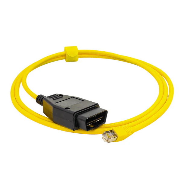

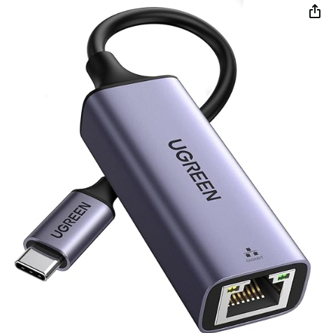

enet is ethernet cable?
Do i need a specific enet cable for MB or any simple enet cable will do?
See above photo, enet cable is not normal ethernet cable for laptop to router. it connects laptop RJ45 port (ethernet port) and car OBD2 port (16 pin). If your laptop doesn't have RJ45, then you need buy USB-to-Ethernet adaptor like blow
Type C
or Type A
Old Nov 3, 2025 | 06:57 AM
Got it, thank you.
Is the OBD2 port something generic? (i see some ads say it's for BMW, but i haven't found any for MB or EQS)
It is generic, suitable for all DoIP device: BMW, mini, Rolls Royce, Mercedes, Maybach, Audi, VW, Volvo, Land Rover, Jaguar, Lamborghini etc. All use this same enet cable, I think bmw is first one so people called bmw enet cable.
Mercedes has its official enet cable but cost around €150+, the only difference is looks a bit higher quality, who want to buy original Mercedes one, we have one pc in stock.
