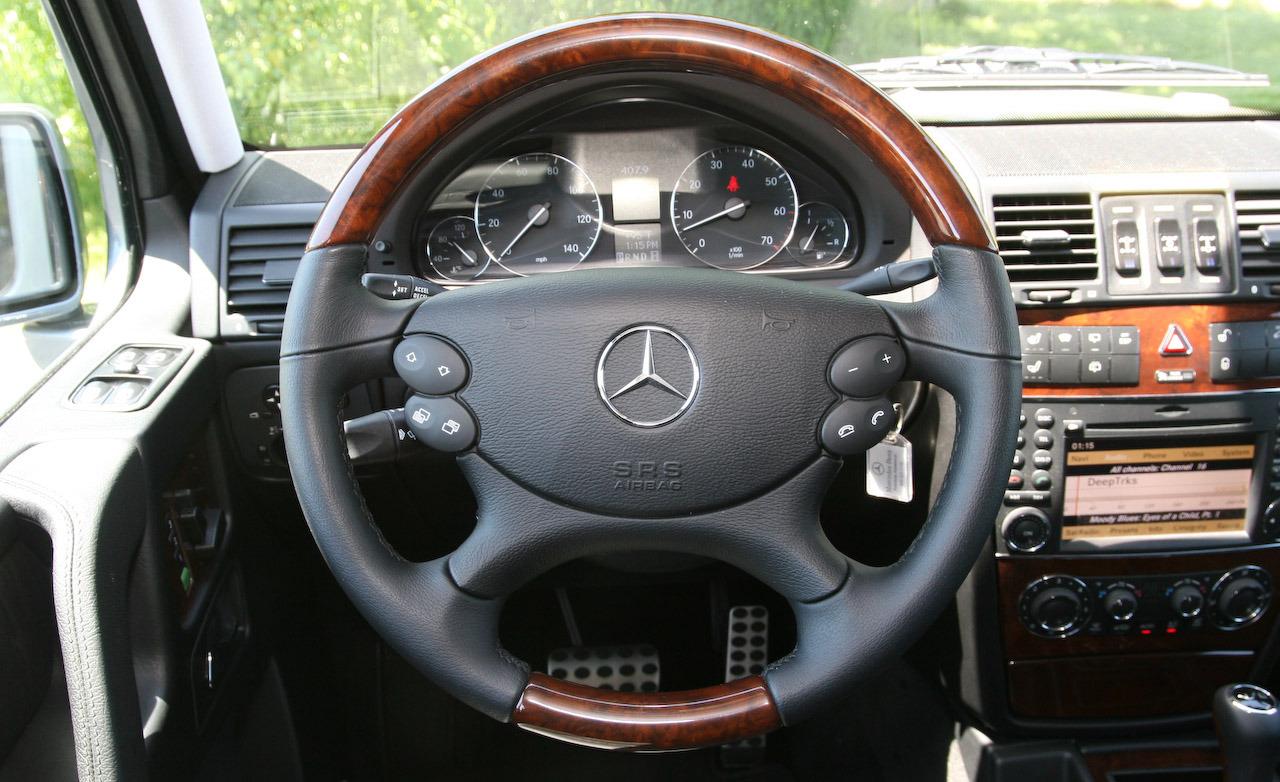

OK so I have a 2011 g550 with 11K miles on it its like new and I don't like the steering wheel. I just bought a new 2014 style wheel and need some help figuring out how and if I can make it work? Pics of old and new. Any help I really appreciate, has anyone done this before? I can't find anything like it online?Upgrade steering wheel 2011 G550 to newer style 2014 HELP-2009-mercedes-benz-g550-steering-wheel-photo-282753-s-1280x782.jpg

it is impossible to do. you will need the newer steering column and that won't even fit. also the air bag plugs aren't the same. sorry about that

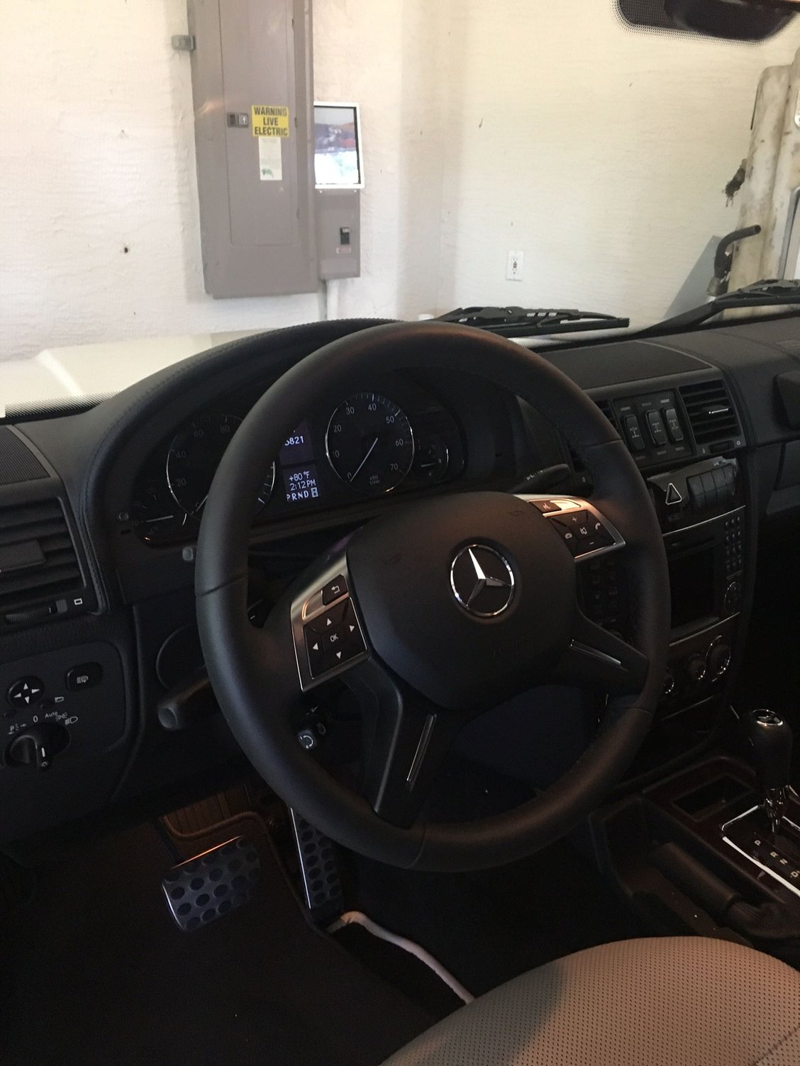

New OEM Face Lift steering wheel installed.
As of now nothing us plugged in but honestly I don't even care. Can anyone plug into the computer and bypass the airbag and Esp to disable it so the codes don't show up? It was a easy swap and i like the look and feel of the new wheel so much better. If I can find some one to make all the electronics work with the new wheel I would be happy to do it as well!
Old May 8, 2017 | 07:37 PM
RA050524's Avatar
Joined: Oct 2016
Posts: 127
From: southern california
g500
oh wow, looks great! looks like i was wrong. i still have yet to try this. thanks!!
