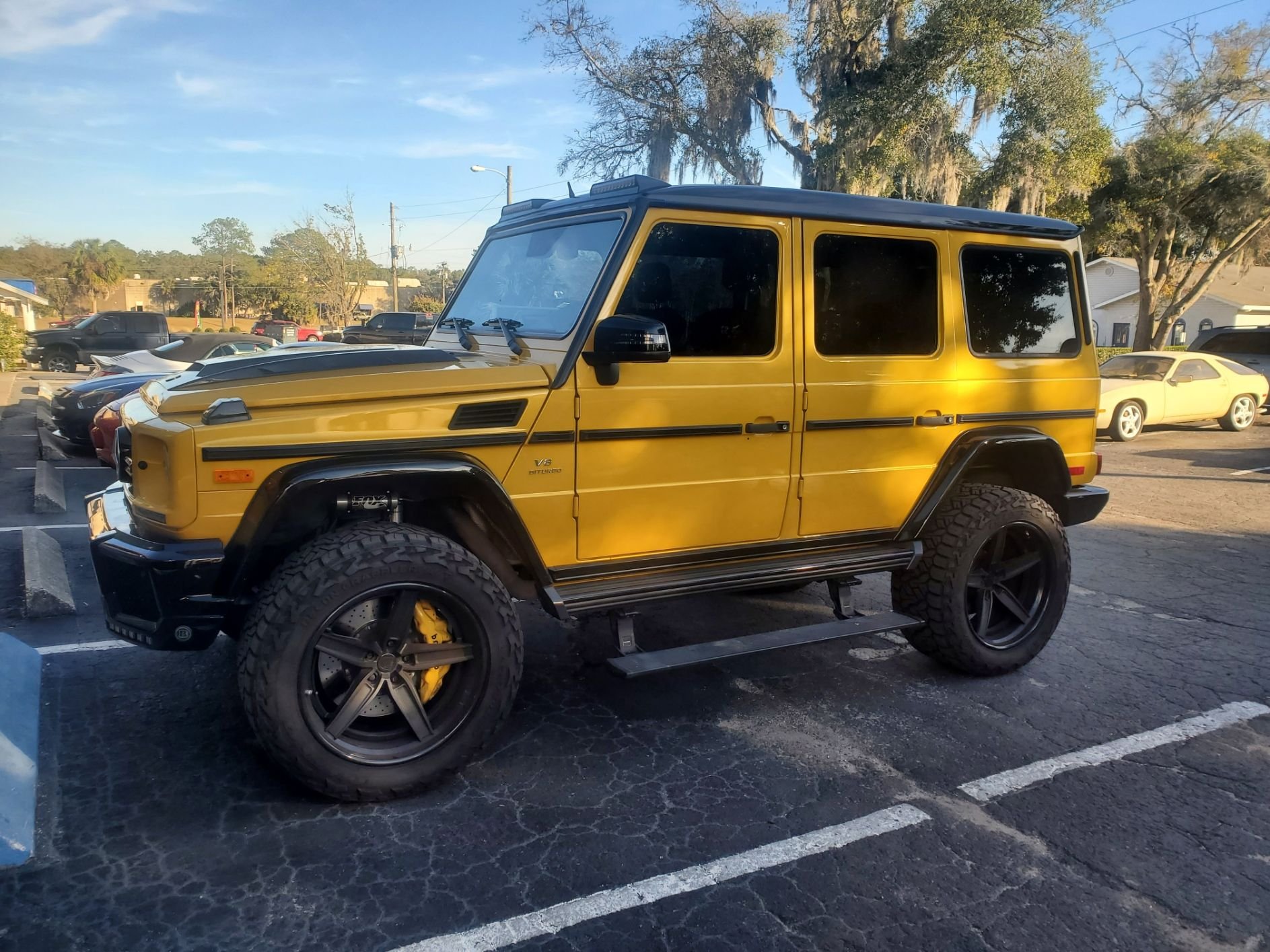

Looks a ton like one that is near me....owner said it drives for crap....my Indi is trying hard to get it back to functional.

That's because it's not a Squared. It's a converted regular G. The tall lift kit is likely the issue. Probably has ridiculous torque steer.

Actually, that was me. To clarify, I said it "previously" rode like crap with the WB lift. The caster was WAY off and the lift caused significant rubbing in turns; it was borderline undriveable, particularly turning at any speed above 40. Despite their build description, it was 100% NOT a 4.5" lift; more like 2".. maybe. I tried contacting them about it via email and never got a reply. Granted, I bought it years after they sold it, but I figured they'd have some interest in at least giving me the actual specs of the lift.
Prior to taking it to Tucker, I had the full suspension replaced with a true 4" lift from Jackwagon Overlanding, including new shocks, Eurowise caster arms, adjustable panhard rods, etc. Zero issues since then, and frankly it handles "tighter" than a stock one now. When we met, it was in to track down a wiring gremlin or basic service; Tucker didn't touch the suspension (not that I wouldn't trust him), as I had that fixed some time prior.
Here's WB's original build thread: https://mbworld.org/forums/g-class-w...treatment.html
It was nice meeting you, but I hope it didn't cost you a new AMG GT for you wife... LOL

Nice stance. What offset are the wheels
