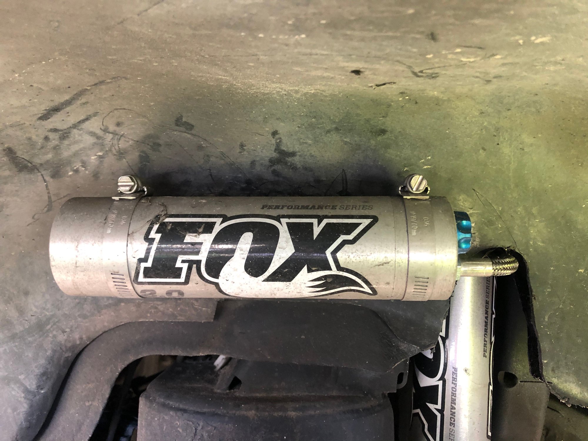

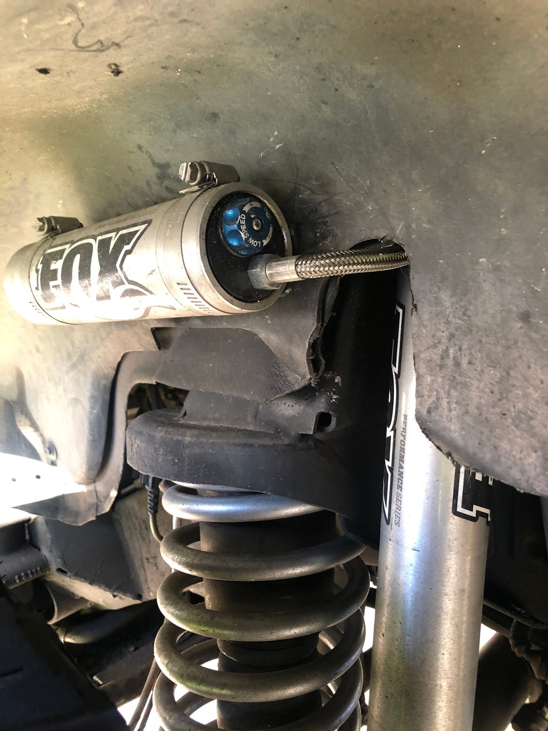

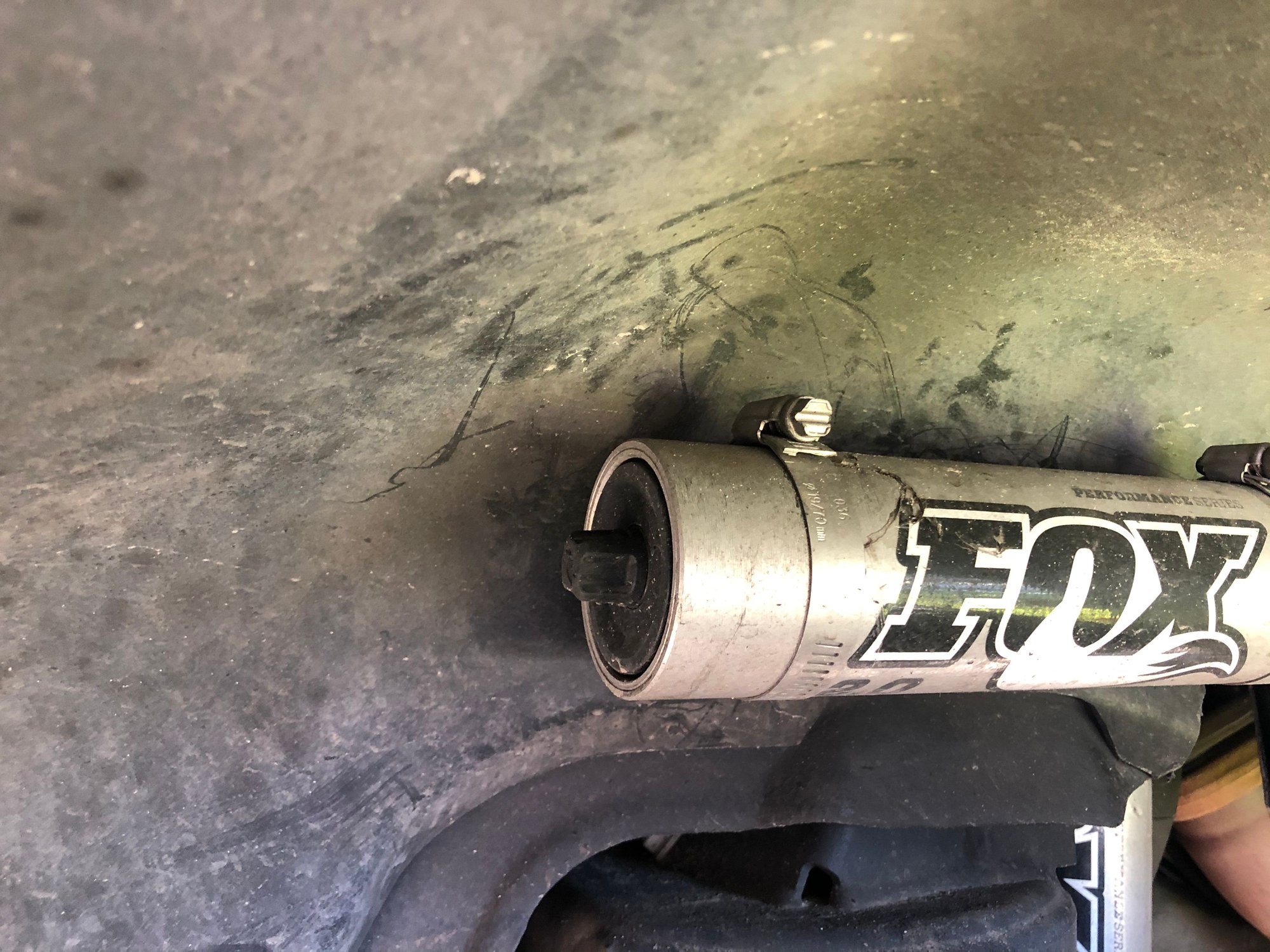

Originally Posted by HtownG
Hi new to the board. Installed 2” lift with springs and shocks on 35” Toyo tires. Trouble free so far.
Can you please post some closeup photos of the Fox reservoir mounted with the brackets mounted in the horizontal position?
I have the same setup and want to mount the fronts the way you have yours mounted.
Thanks,
David

Here you go Dasurfa:

HtownG,
Thank you so much for the pics!
Now I have a good idea on how I can mount my reservoir. I went offroading during G-Amboree here in Vegas and tried to adjust the Fox 2.0 in the front and it's almost impossible to reach the adjusters from fender and top was same. I don't know why Fox had to make these with such a short braided line.
David

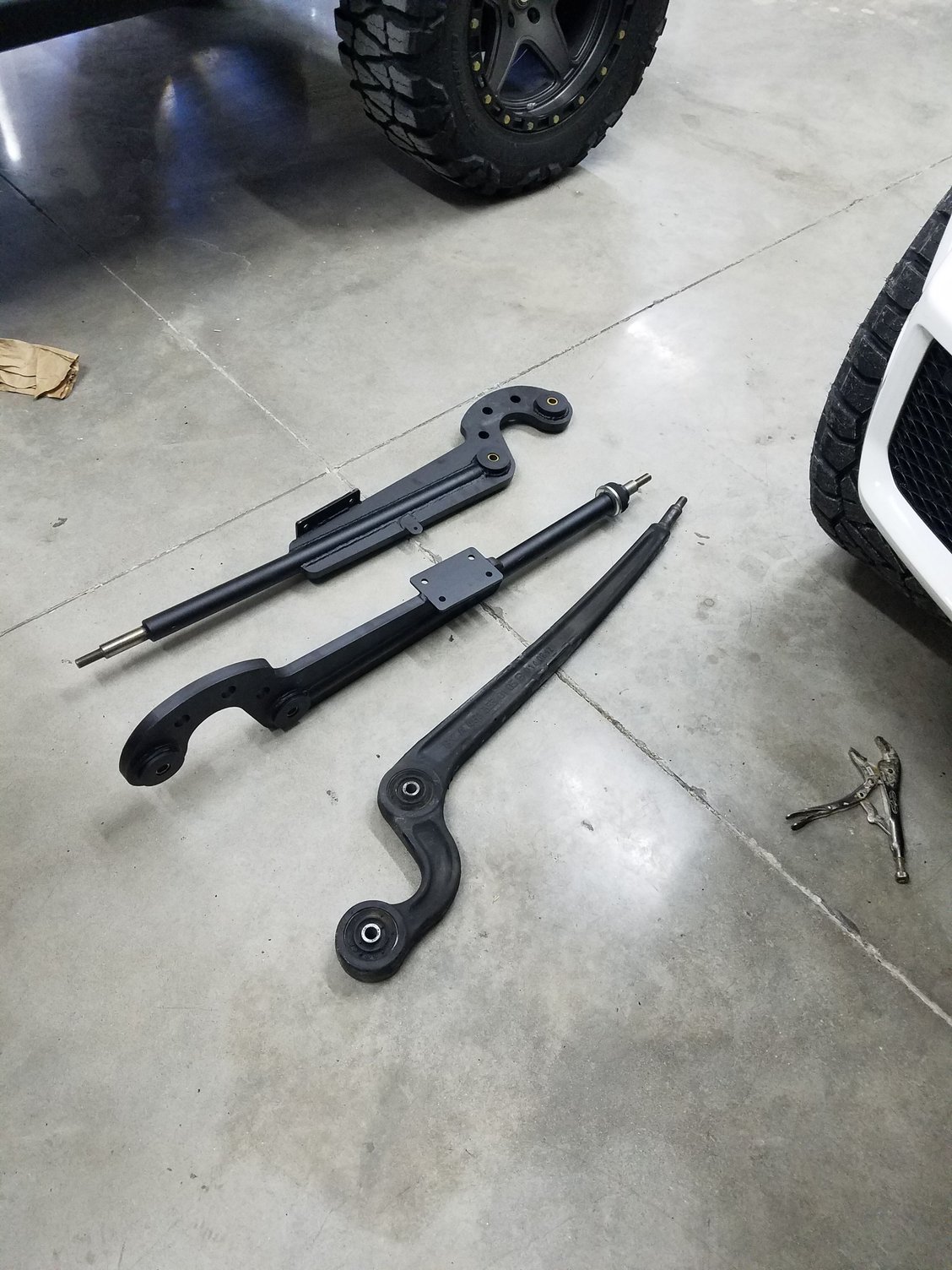

In order to get to zero caster, (still not ideal) I ended up using the G-wagen Accessories mil-spec radius arm brackets (high quality part, but make sure you find a legit, professional offroad --preferably race builder--shop to install) and caster adjusting bushings...and still only got to zero caster. It is stable at highway speeds and self centers with 35x12.5s, but not as much as I would like. Driveability is totally good, and it handles nicely, but it would've been easier in hindsight to go the new radius arm route (but at the time I installed a few years ago, wasn't really an option).
Definitely takes work to dial back in caster once you go above the normal 2" lifts..I am running a similar setup (thor springs and 40mm spacers on 35s)
