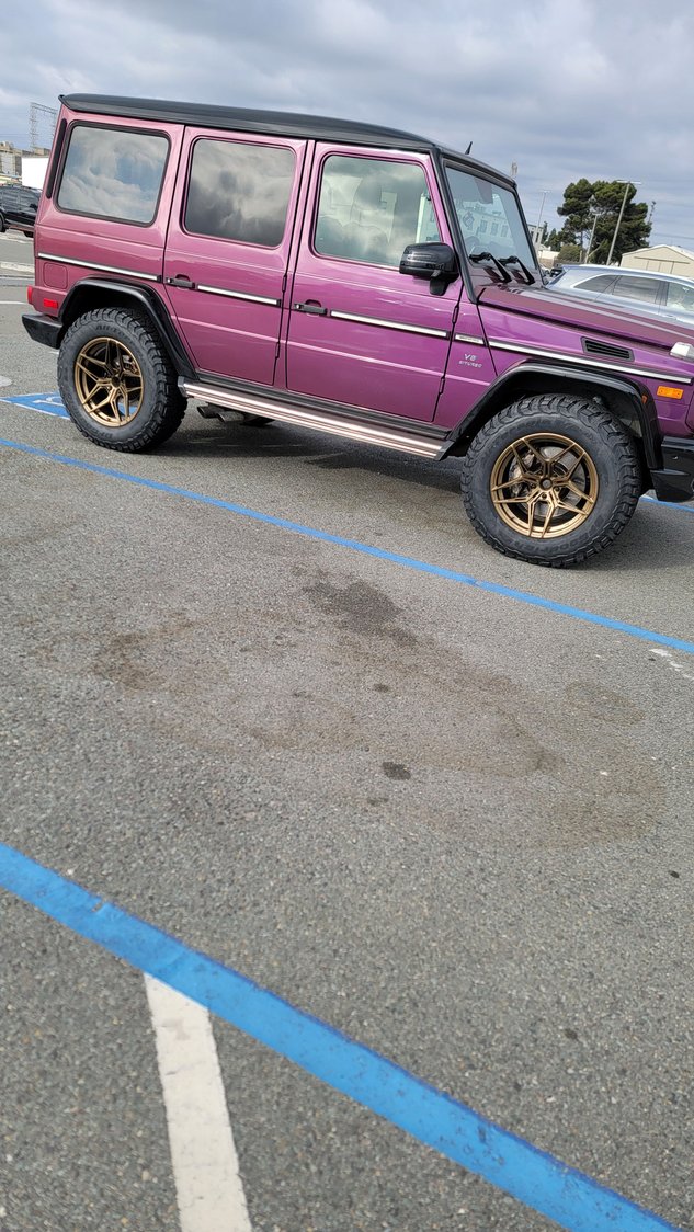

Lots of hot builds here! I just finished installing my lift last weekend only to have my wheels show up this week(2" OME springs, Bilstein shocks w/external reservoir, 20x10" Variant Wheels. 35" KO3 tires) Will probably leave it alone for a bit but I think next I want to do the front bumper/winch. Anyone seen a complete bolt-on winch setup for the G63?

Awesome look! Is that a purple wrap?

Nope! Thats the original paint. They called it Galactic Sunbeam Purple. Looks even better in direct sunlight. Depending on your angle it shifts between purple and red.
