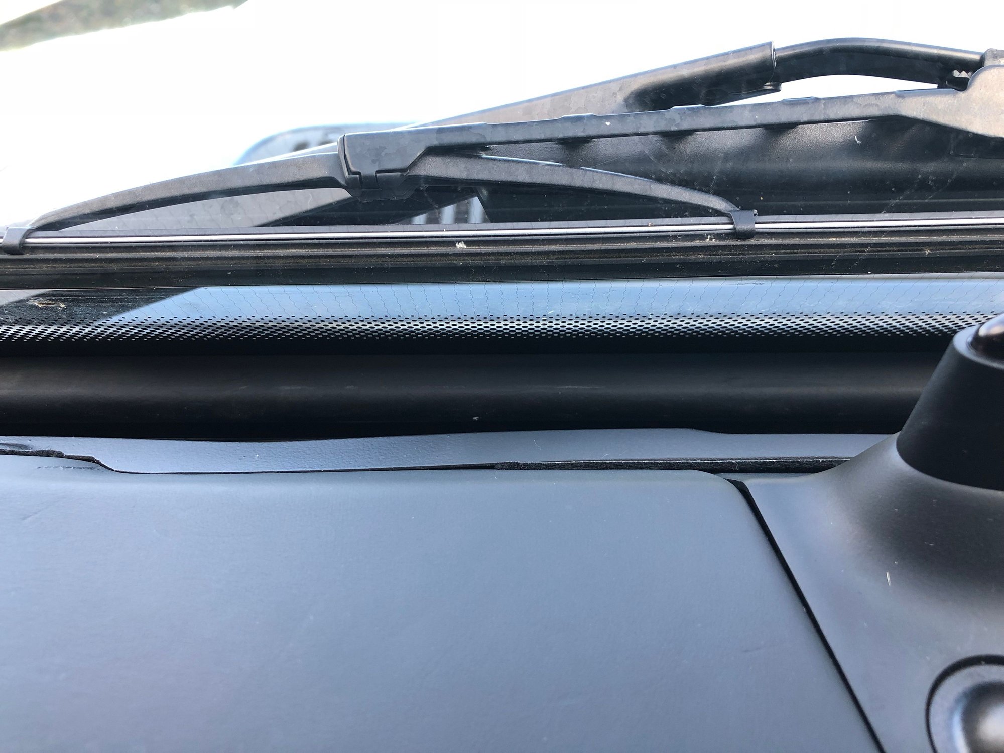

Can you send a quick pic of exactly where you slid some felt tape in? I have LOTS of felt tape, LOL. Thank you!

Will do. The good news is that my felt tape has cured the squeak! I'll take photos tomorrow.

Here is hopefully where you can see I have some felt tape, its a close up of where the plastic vent cover rubs up against the leather.

THANK YOU!! Did it snap off, break on one side? The plastic piece looks jagged. Appreciate the picture.

I have the same issue on my W463 G63 2013. It has been making this noise for over 6 years and driving me crazy. I tried the hood bushes and I am sure it’s coming from inside the car. I will give this a go! Is it just a matter of sticking some felt down between the leather and the plastic vent covers?
