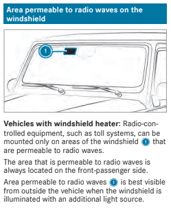

Grabs from the manual. See what it says about being able to see a clear area with a light - anyone try that?

Interesting - I wonder if it is a temperature controlled "auto on"? Or "on with defrost only" function.
Thank-you very much for that! I did some more research and discovered that our windshields have embedded tiny silver thread inside that are not visible. The "radio permeable area" of the windshield to the right of the rear view mirror will allow a radio signal to go through......but these windshields act a lot like Faraday cages!
As a result, your radar detector will not work if you mount it to the windshield like I did on the top left drivers side. I had thought that there was something wrong with my new Uniden R3! Nope! I just doesn't detect a radar signature unless the signature is quite strong! Only choice is to mount it in the permeable area as is in your picture.....or get a professionally installed one mounted in the front of the vehicle.
Personally, I'm happy to just turn up the sensitivity of the Uniden and will keep it mounted on the top left.....it's just good to know about this quirk!
Thank-you!
