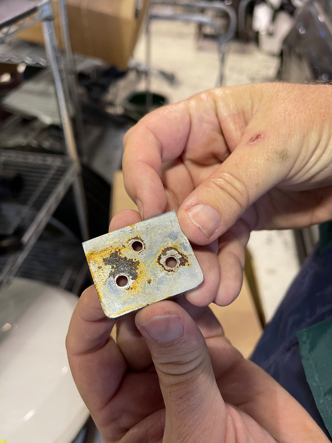

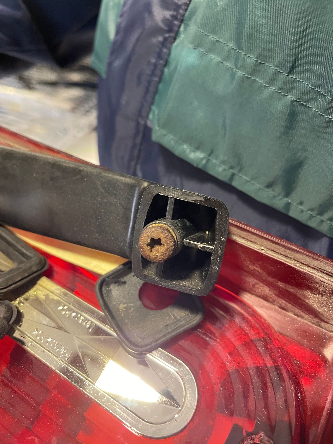

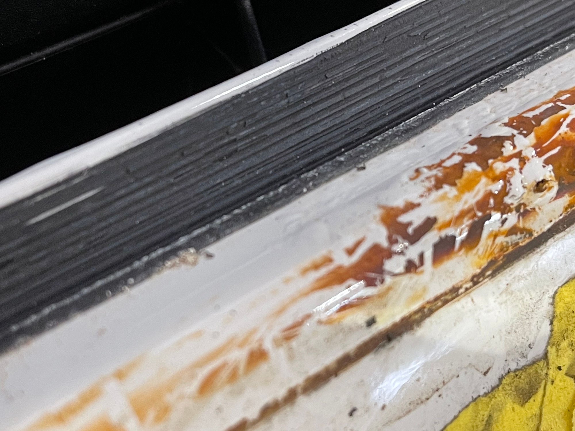

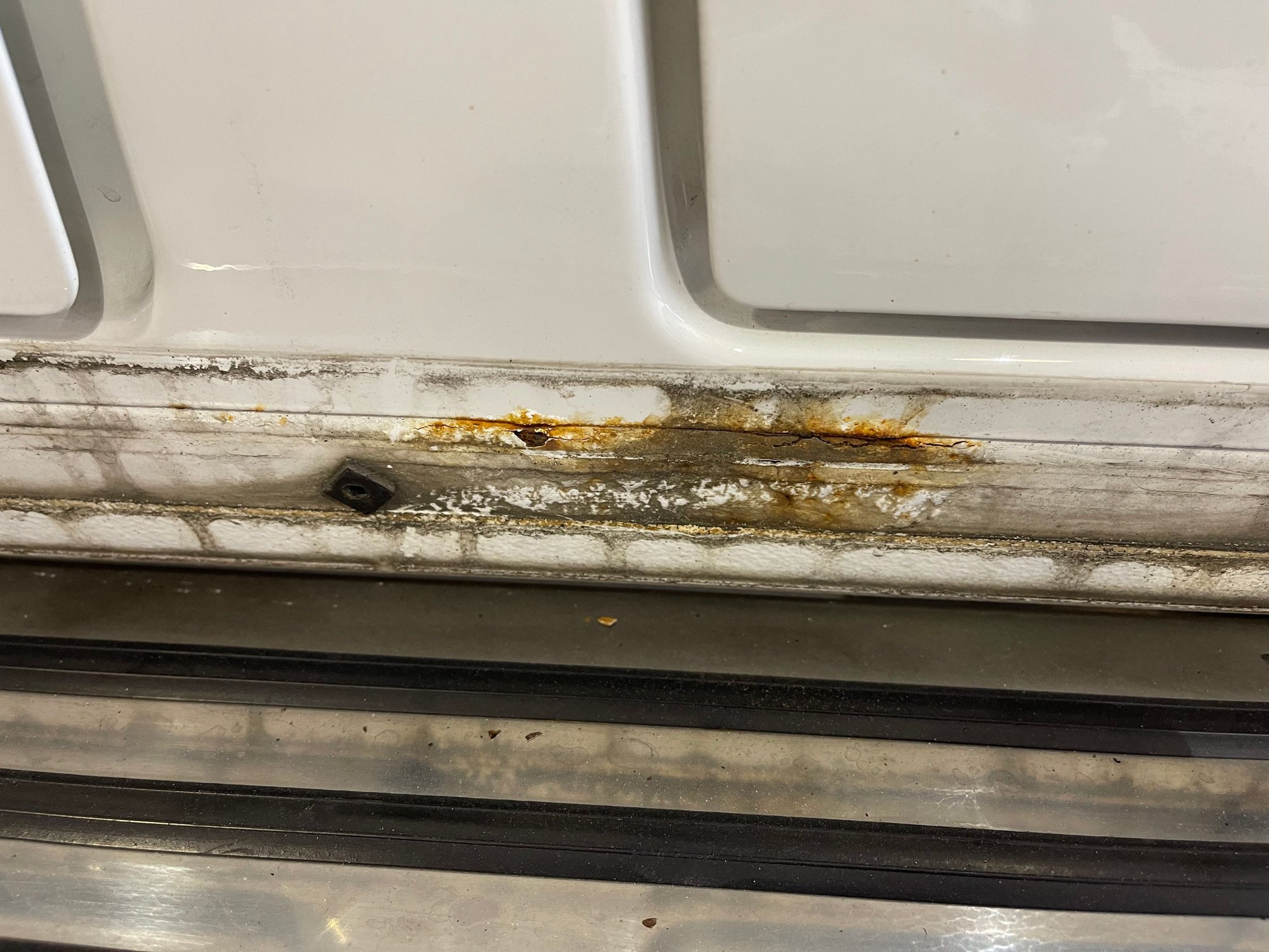

Additional rust under the running boards
Rare look behind the windscreen
Same look behind the windscreen with rust bubbles
Wiper arm has been compromised$$$
Rear door handle
Rear door handle
That first picture in particular is bad.
and completely hidden!!!
we pulled the running boards because the trim on both sides needed to be replaced

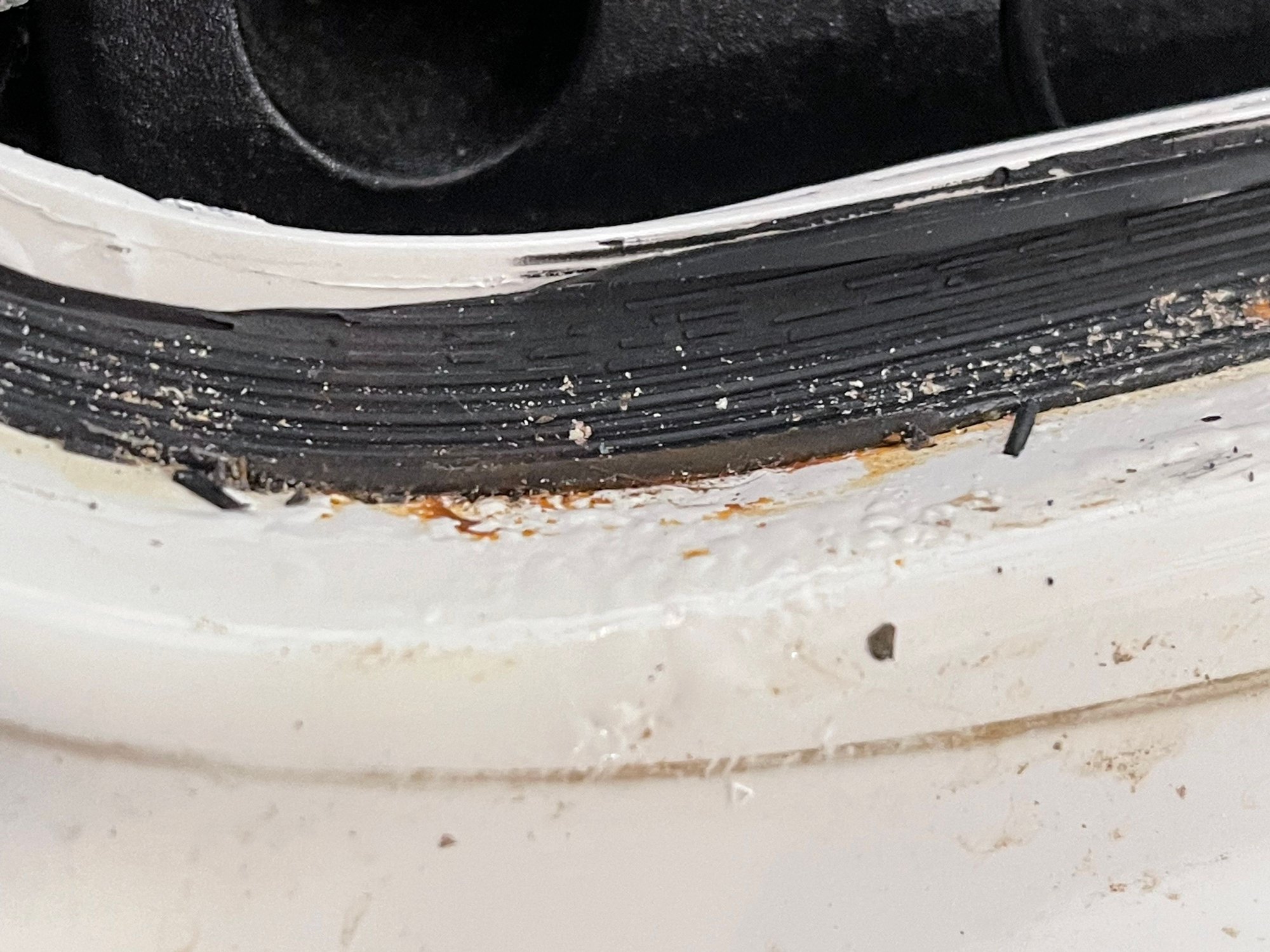

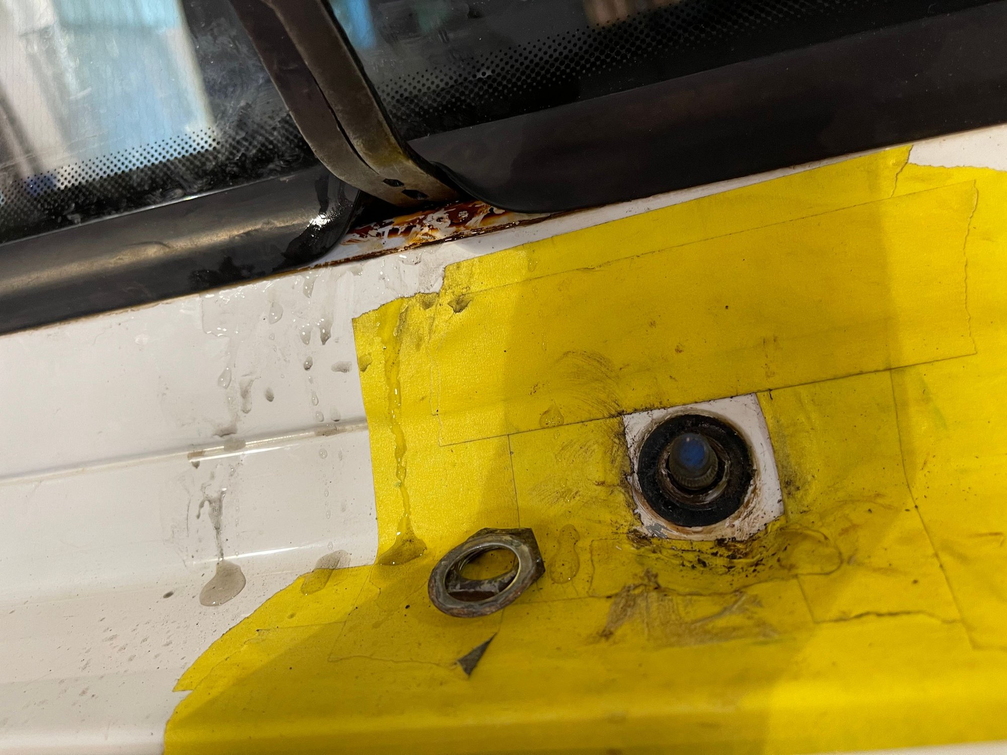

Tiny rust paint bubbles around the windshield and look what's lurking underneath the seal and the glass!
Whenever you see paint blistering (bubbling), even without any visible rust, you can anticipate the problem being really bad.
Was this G driven in a region where salt is preemptively spread liberally on winter roads?

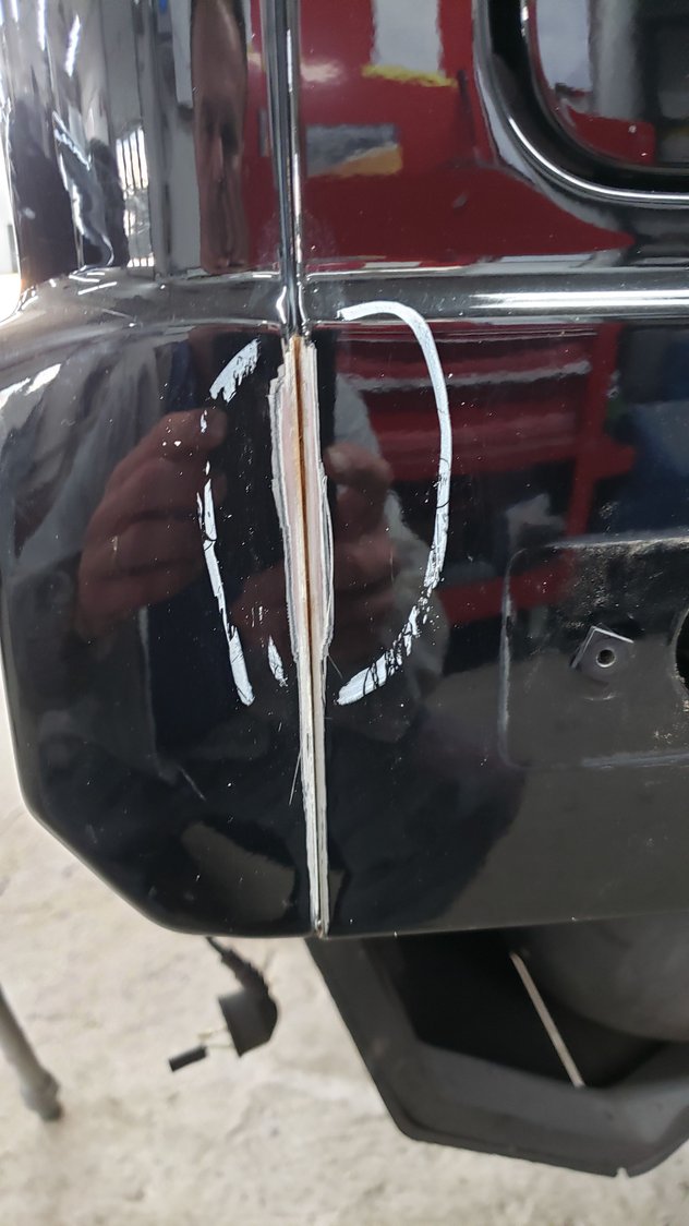

Finally brought the G in to get the rust spots fixed.
One thing to note is that it is very difficult to remove the windscreen without cracking it, so I'm getting a new windscreen. This isn't a bad thing because the windscreen was pitted and scratched (the drawback of having a flat and upright windscreen).
Oh and the bumper isn't rusty (it's fiberglass), it just needed to be repainted. Then again, the G is special so fiberglass may in fact rust on it

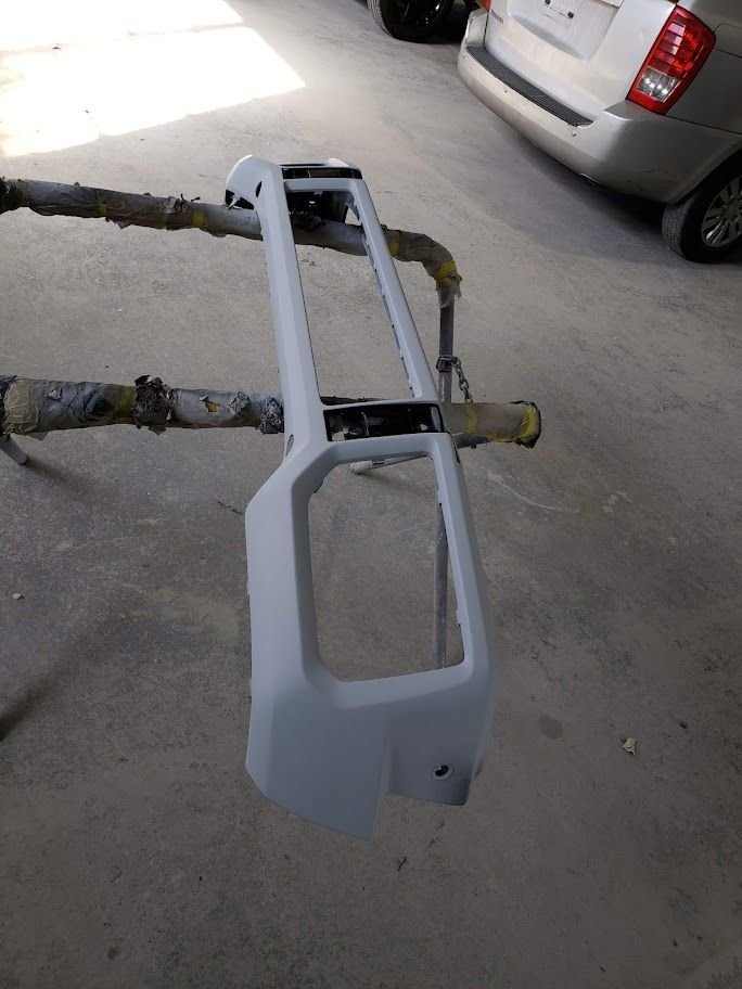

Awesome! mine is also at the shop getting the front glass frame and glass replaced and all the other rusts taken care of.
and rust on my special fiberglass bumper getting repainted too

Update: ready for paint
