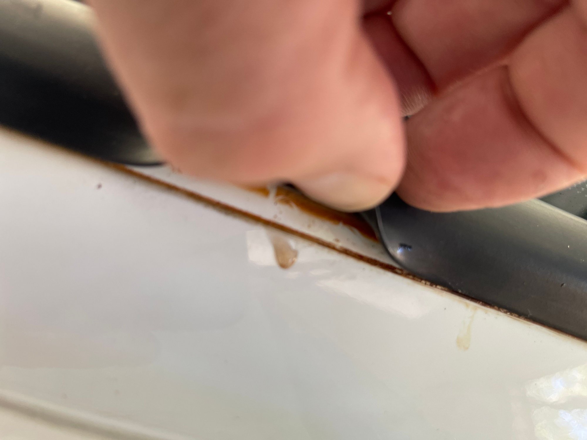

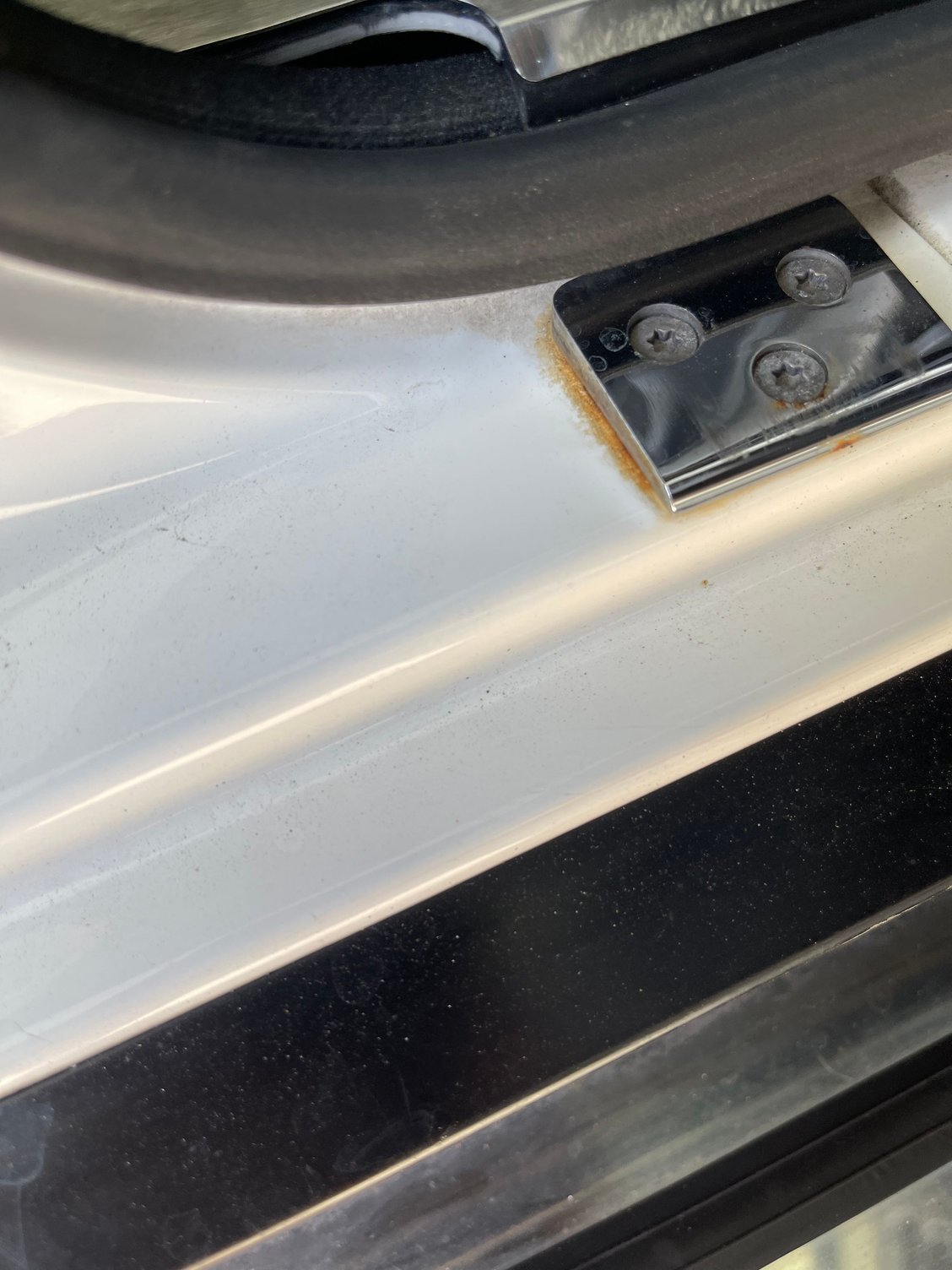

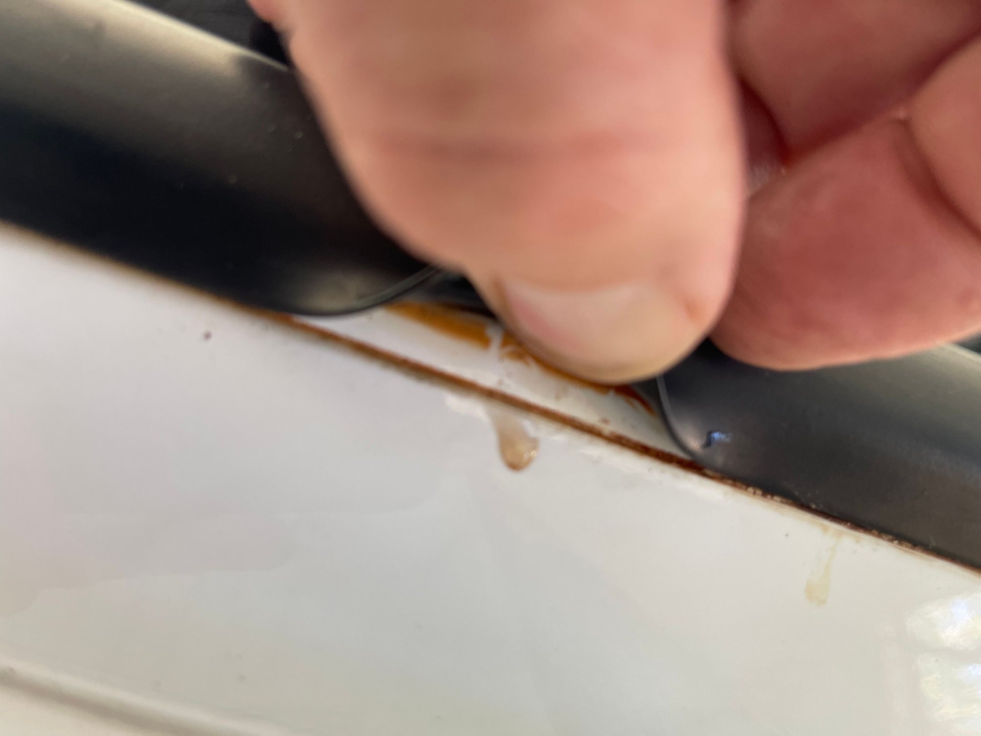

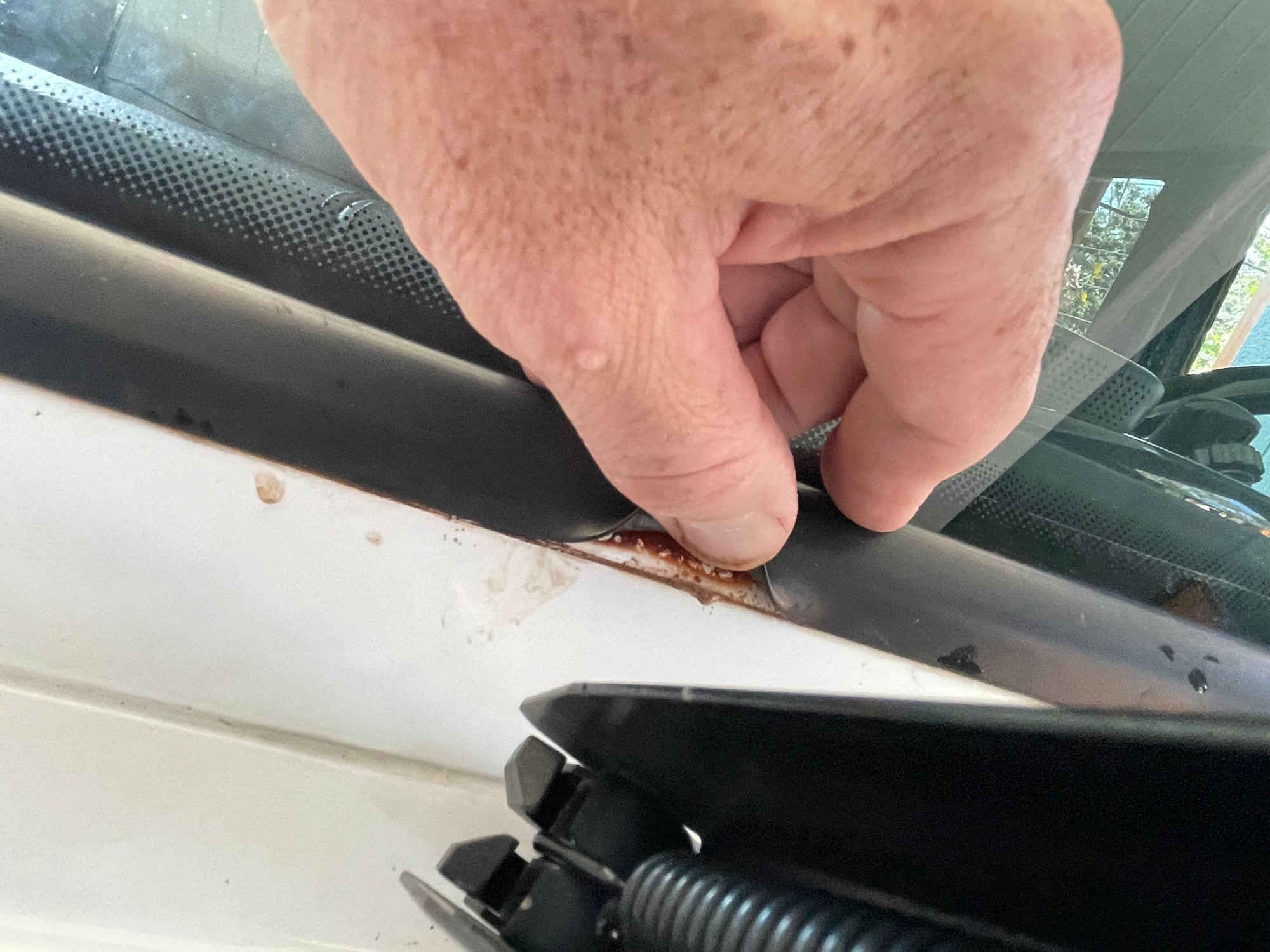

2014 g550 45k miles - small but important rust issues
Public service announcement
EURO MOTORCARS
Germantown MD
Just delivered my Pre owned 2014 G550
Rust under the windscreen
Rust on door hinge
Rust on wiper retention bolt
Stained headliner
In need of a oil/filter change
This stuff was either missed ( I doubt it) or just ignored with the expectation that we would “shut up and color”
This is a MB dealer !!!!
THE BEST OR NOTHING-or below expectations

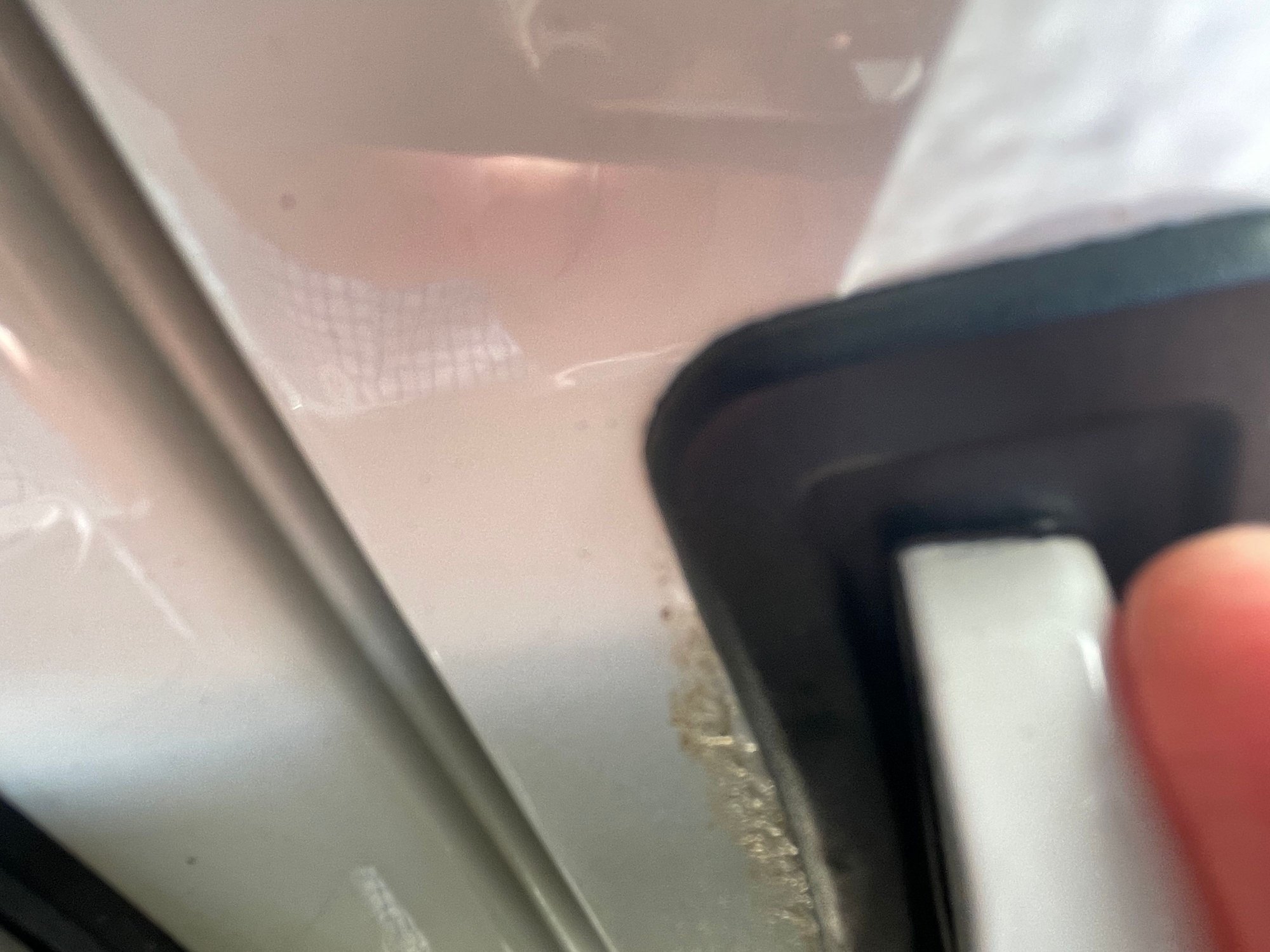

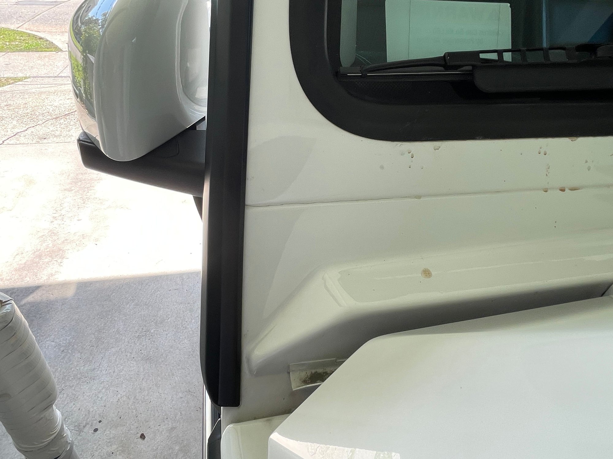

Found two more areas of rust. One on the passenger side rearview mirror post, and one between the passenger side rear light assembly and fuel filler door (in the crease on the sheetmetal between these two areas):

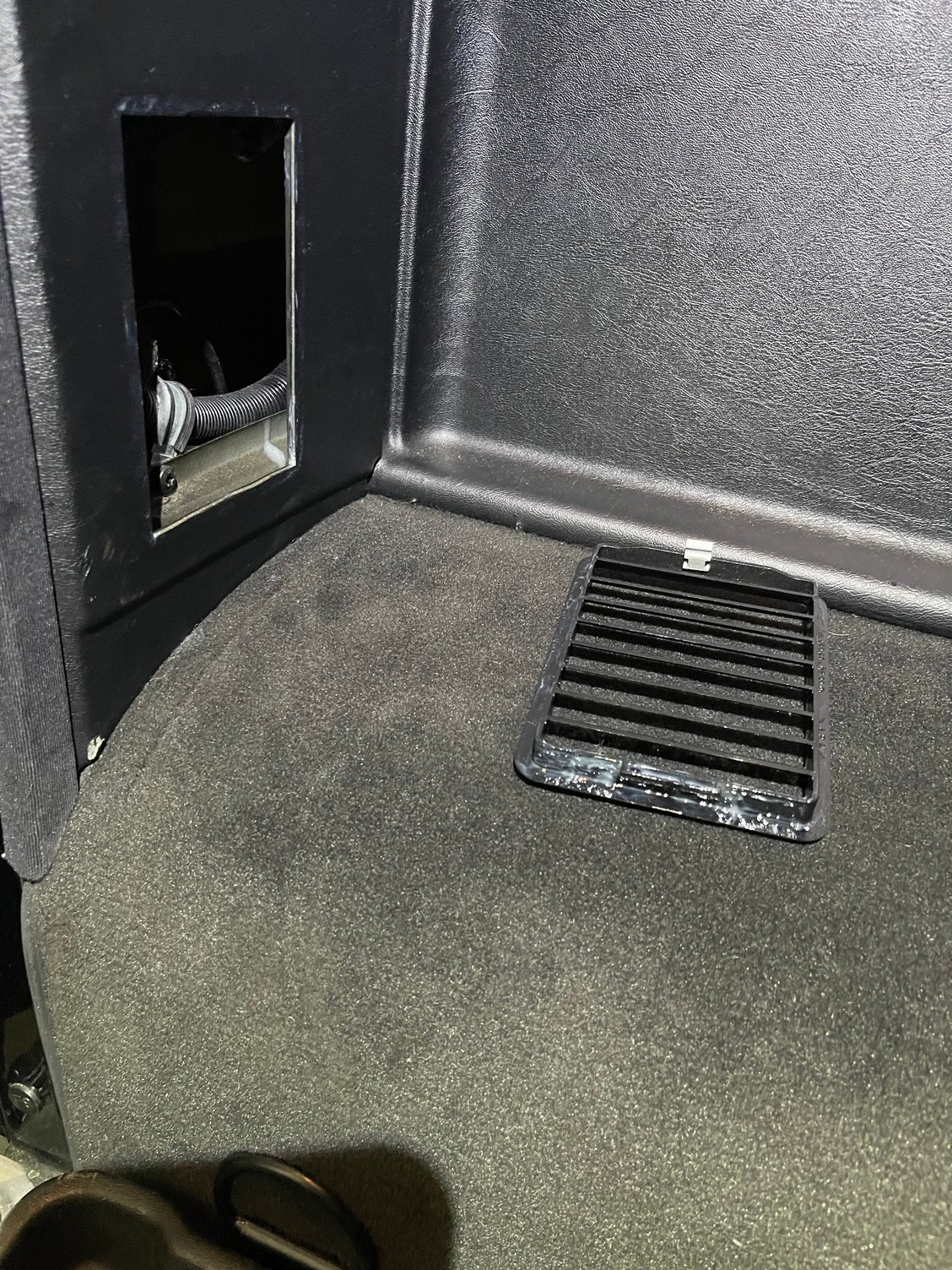

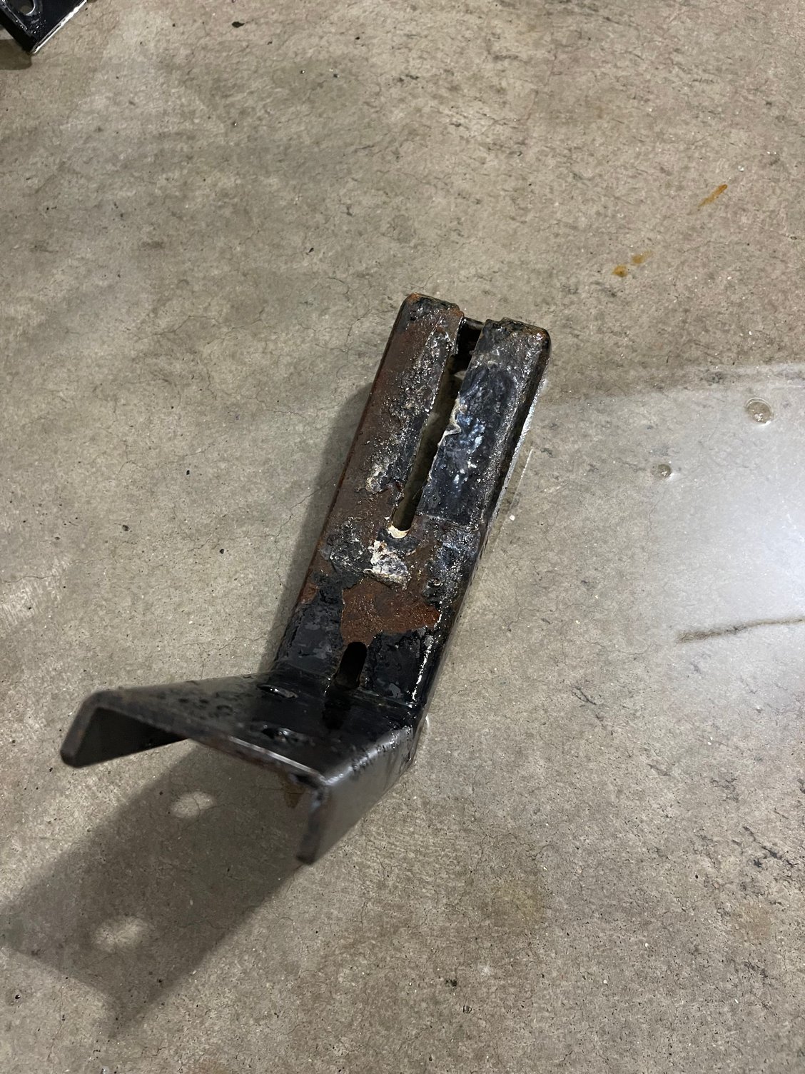

Old Sep 15, 2021 | 02:32 PM
  #218
JD101b's Avatar
Joined: Oct 2017
Posts: 699
Likes: 149
2015 SL550, 2017 GLS 550, 2010 G550, 1995 E320 Cabriolet
Here are some pictures of what I was talking about in the previous post:
Vent to access rear door hinges.
Brackets that hold running board to the vehicle.
This is why I want to get a full stainless exhaust !
Another shot of the running boards and the rusted brackets. The bolts were rusted to the brackets so I had to break them off. I bought all new stainless hardware and put a thick layer of "hot n' tacky" corrosion inhibiting grease on each one before I bolted it back on.

I’m waiting on a response from MBUSA after I sent my estimate to remediate rust I discovered on my “new to us” preowned 2014 G550. From the dealer - it needed two tires due to a deep cut and several areas of developing rust- $$$ in addition to the cost of the truck. I feel like a sucker -I PURCHASED FROM AN MB dealer !!!
disappointing and the feeling of powerlessness is palpable.
EURO MOTORCARS GERMANTOWN MD - don’t patronize this dealer.

So, I got my estimate and submitted to MBUSA. Waiting on them to contact me now. Estimate was about $4,500, but could be more depending on if they find any other issues. This was for the windshield seal area, rear hatch hinge area, and the seam on the rear hatch. About $500 of that is for clear coat repair on the hood, so $4,000 for rust.
I bought this sight unseen from Mercedes of Ft. Myers, and I'm certain they knew about the clear coat issues on the hood, as they were trying hard to push a paint and interior coverage. They possibly also knew about the rust, or should have if they did an actual CPO inspection.
Lesson learned. I'll update when I hear back.
