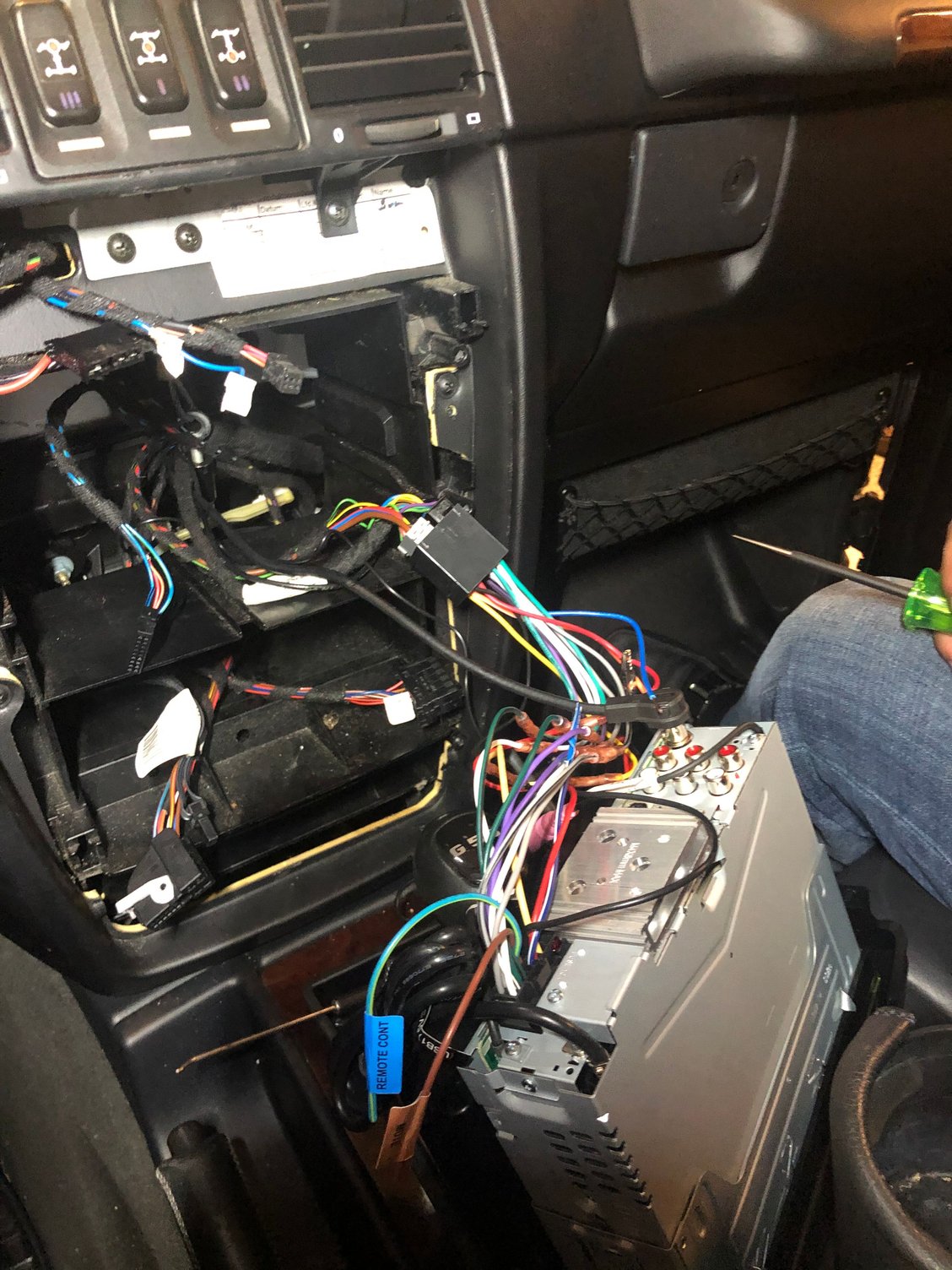

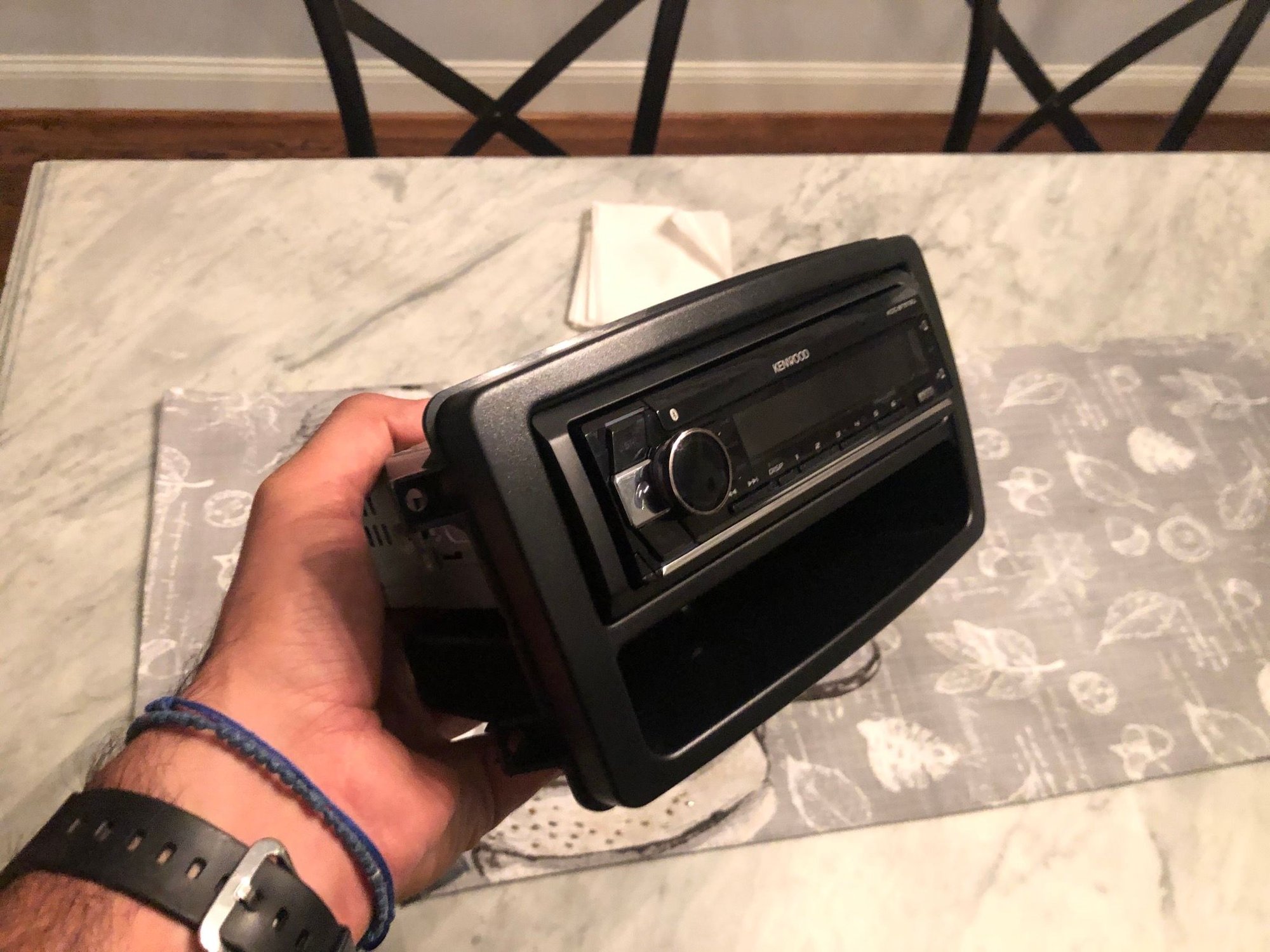

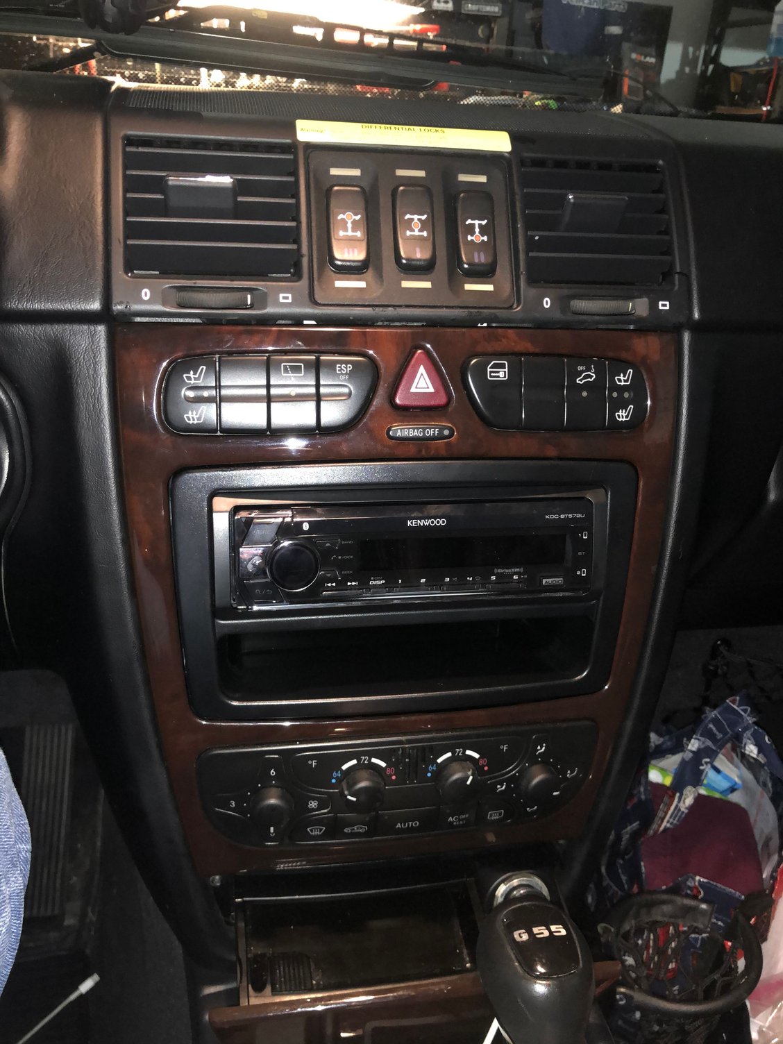

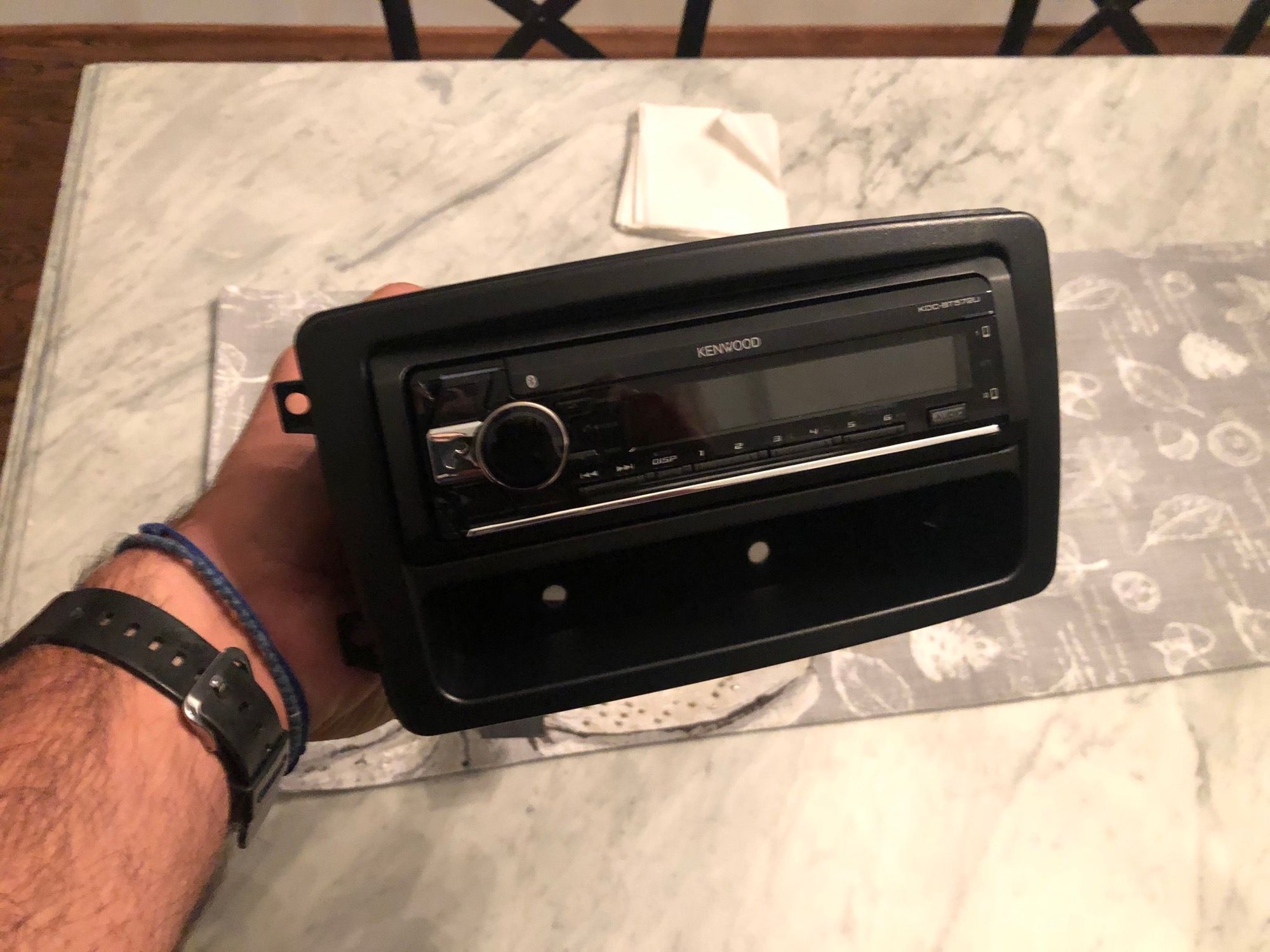

Got some time yesterday and thought id throw in the Kenwood head unit.
Simple enough plan. Match up the same color wires on the Kenwood harness to the adaptor harness. Run the microphone. Connect harnesses, antenna adaptor, etc
Simple enough except unit is not powering on. When I push the “eject” button for the CD it attempts to eject a cd but no power on unit.
It was late last night when I stopped messing with it. I’ll take it all back apart next week to test all the connections I made.
At least the dash doesnt have a hole in it anymore

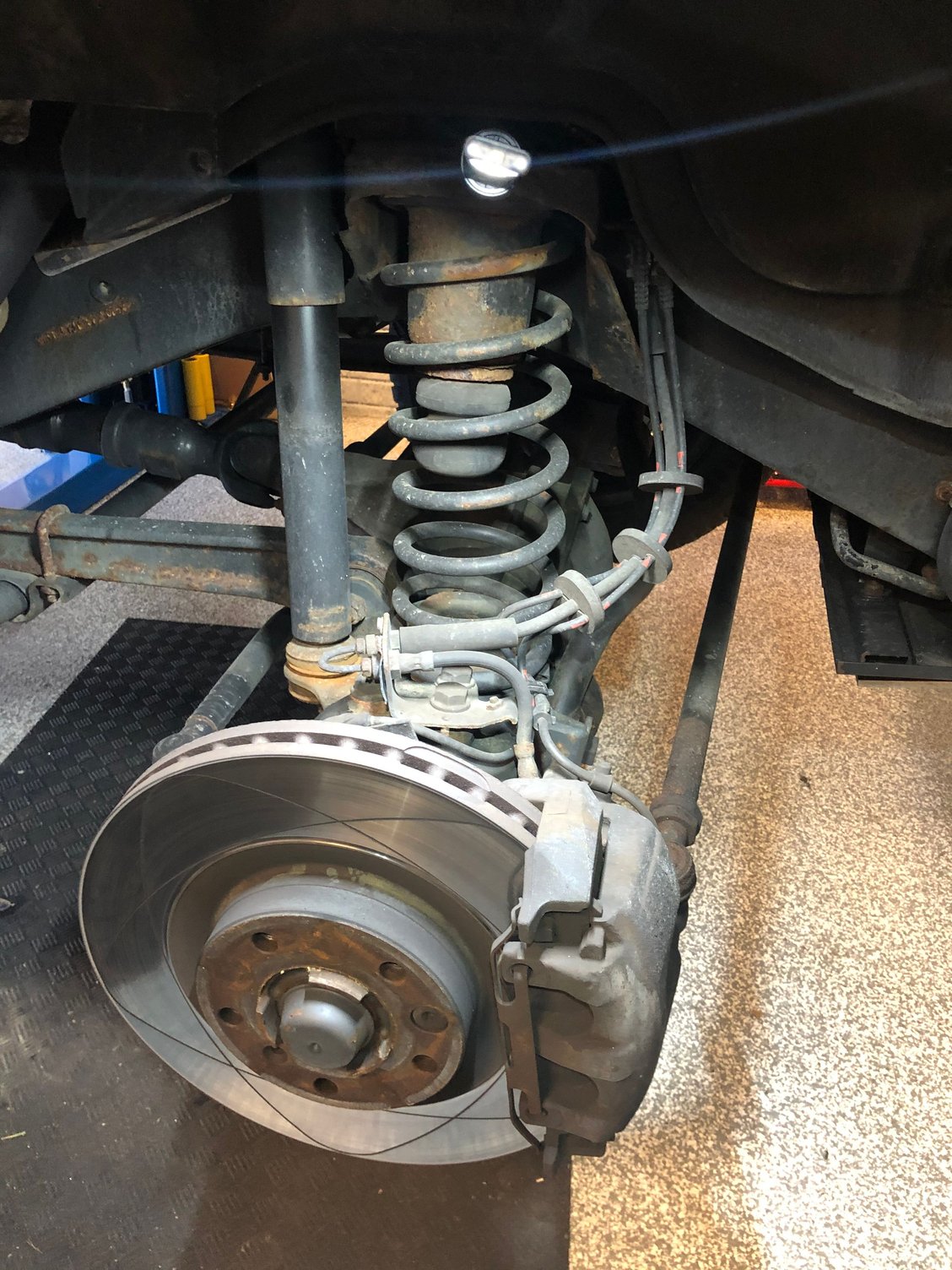

Finally some real work on the truck!
Performed the differential and transfer case services. Pretty straight forward, drain and fill. Truck had 81,003 miles on it. Took about an hour to do all three.
The transfer case drain/fill plugs had washers on them that I was unaware of before hand. Reused what was on the truck and torqued everything down. Will check to see if any leaks appear before I start driving it.
Left the truck on the lift as I want to do front brake pads next and figured it would be easier to just have it ready whenever I get a free moment.

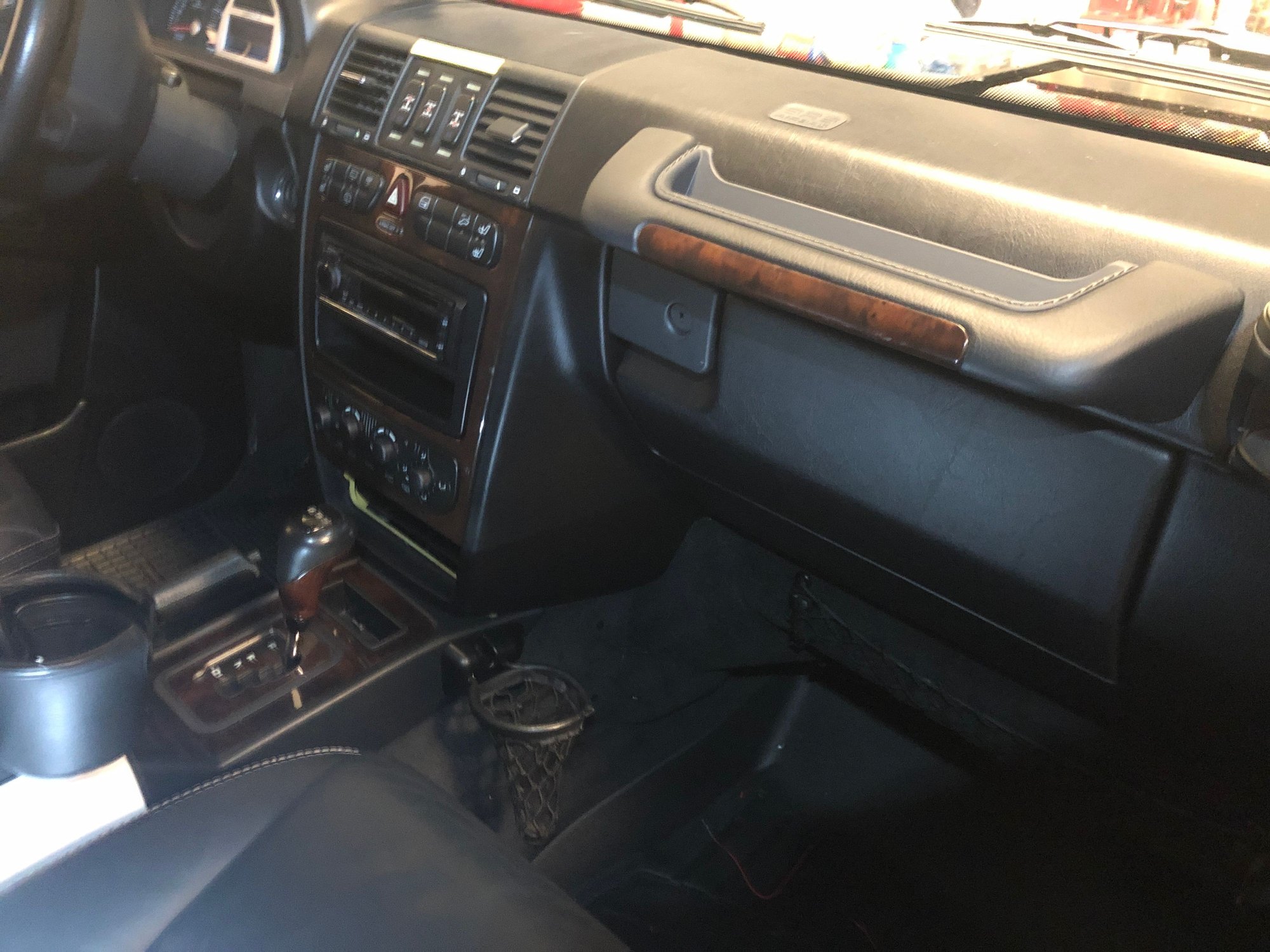

Drinkin with a buddy last night and we were talking about the truck. Hes a mechanic/shop owner. He asked me if it was easy to take the dash apart as I had it buttoned up so it wouldnt look like ****.
3 min later it looked like the above picture.
Some interesting discoveries:
1. There is only constant power coming into the head unit but that slot in the harness is empty so there is NO POWER coming to the head unit other than some low voltage, maintenance power. Theres a Constant Power wire there but unless I want to manually turn the radio on and off (and risking a dead battery) I need to run power from somewhere else.
2. The harness adaptor that I purchased did not connect the speakers to the head unit. Had to connect the "remote" wire to the car speakers... Wierd.
Ultimately I need to run a wire from a keyed fuse in the fuse box under the glove compartment to the radio and that should solve my issues.
Might get to it today but the weather is nice and theres stuff around the house that needs to get done before it gets colder.

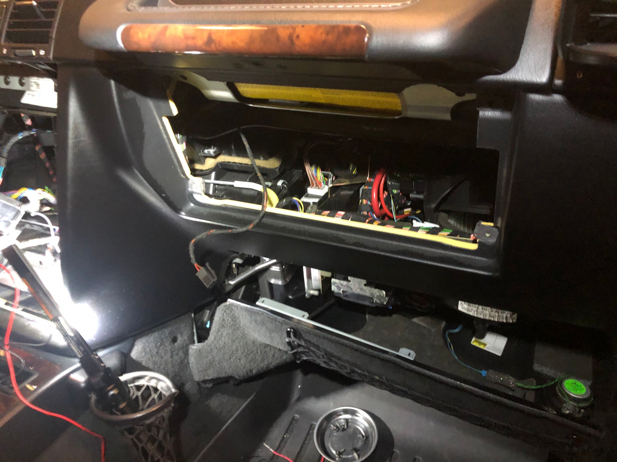

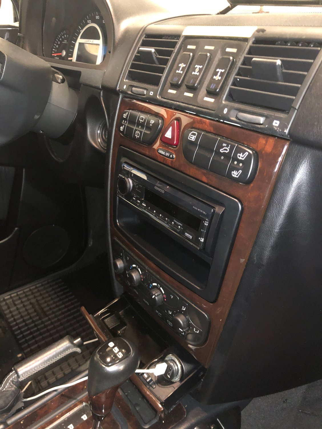

Took half the dash apart but got it done!
Ran a wire from fuse #47 under glove box to run key power to the radio.
Cut a hole in back of glove box to pass USB connection into glove box also.
Everything is back together and works great!

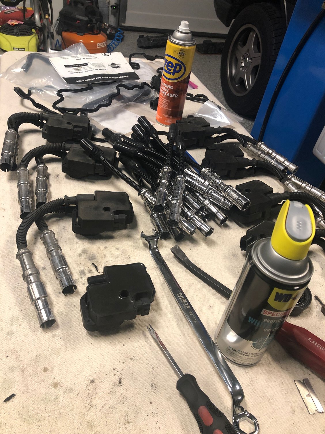

Got motivated yesterday!

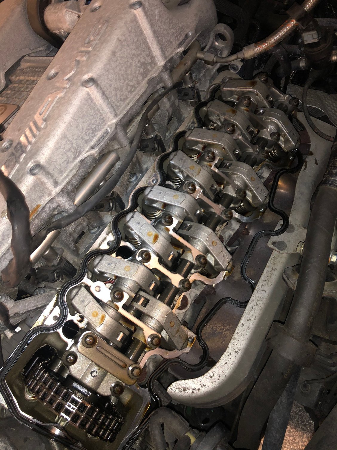

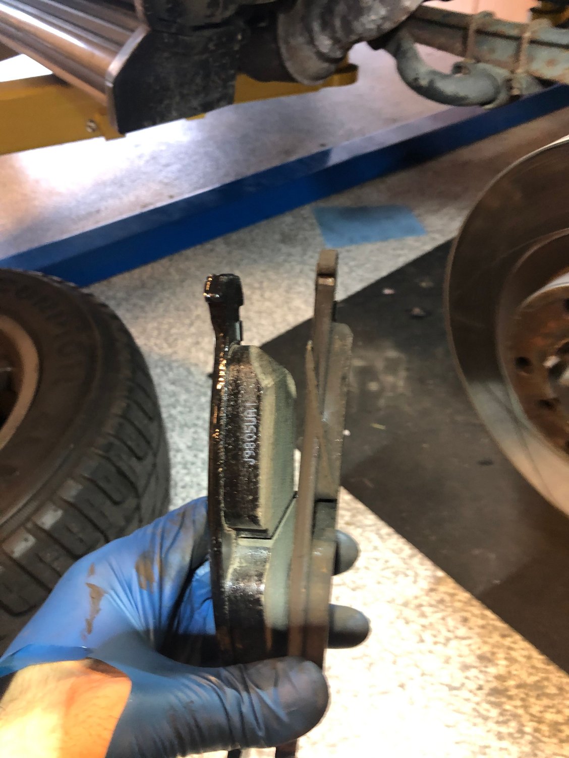

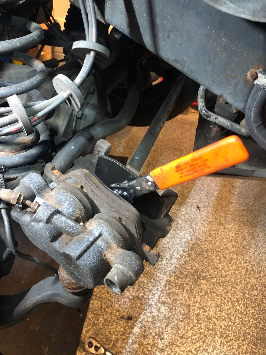

Front brake pads were a breeze. Brake caliper ratchet tool makes quick work of closing brake pistons, highly recommended

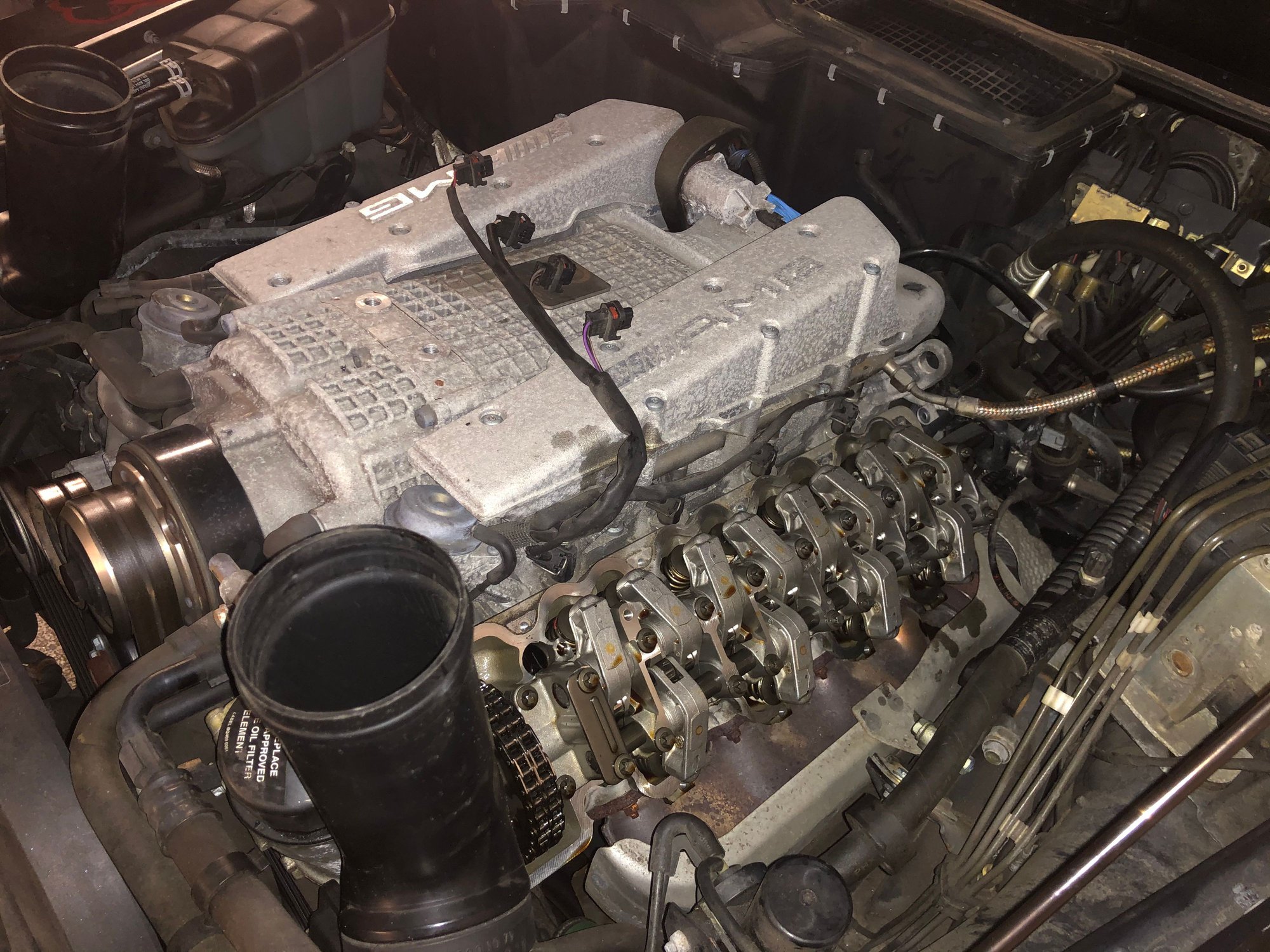

Started valve cover gasket/plug/wire job on drivers side. Top right valve cover bolt a pain as fuel line was in the way.
Plugs near firewall fiddly with steering shaft in the way but not impossible. Swivel/wobble plug socket to the rescue!
Need to pick up some brass brushes today to remove old gasket material off air chambers on valve cover. No time to wrap anything up tonight, will finish tomorrow. And complete other side as well.

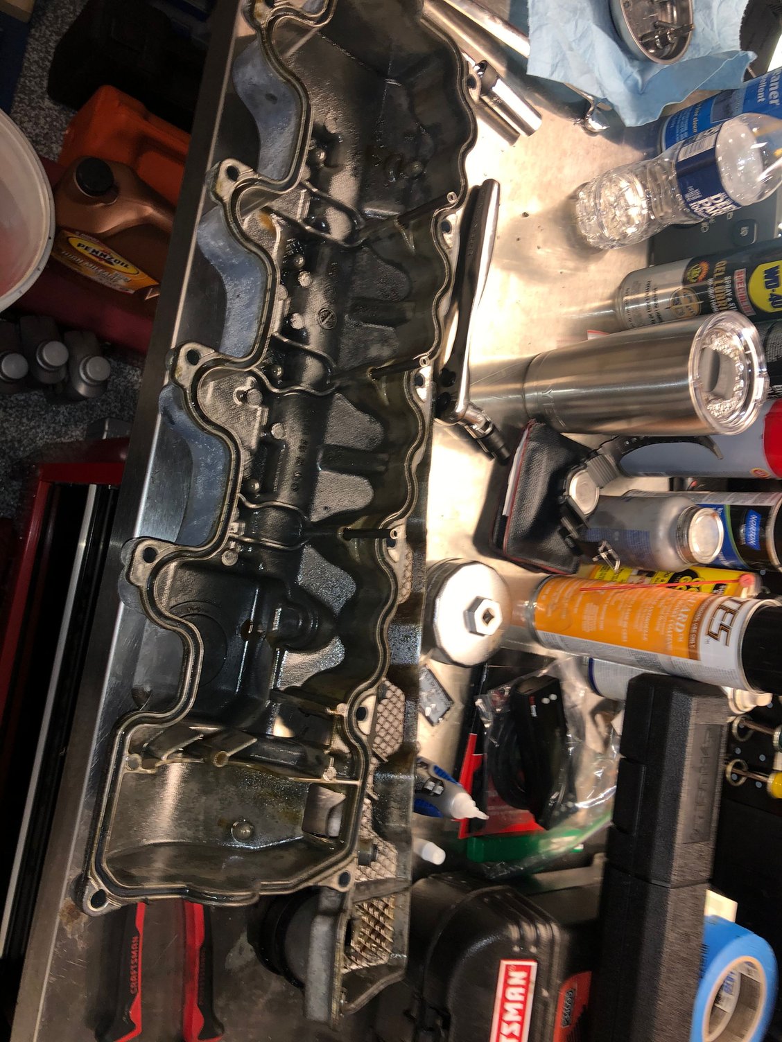

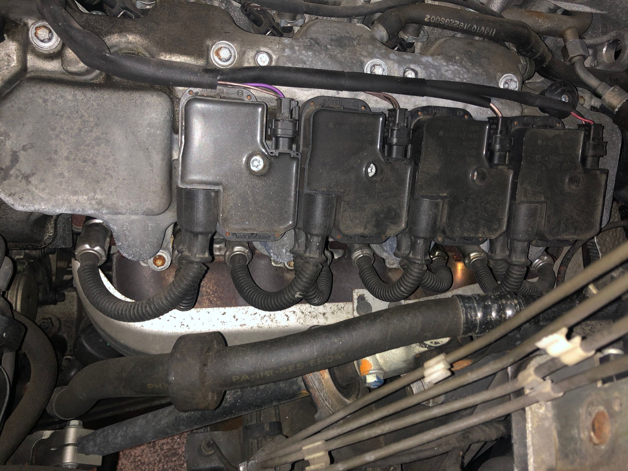

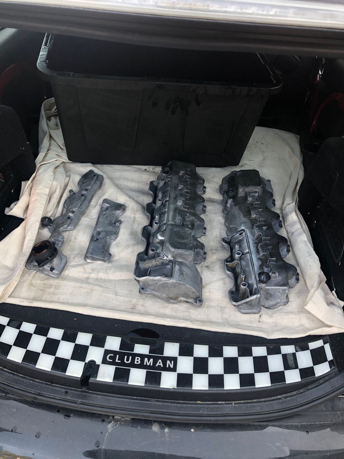

Clean Valve Covers (as clean as they’re gonna get at least) ready to go back on truck:
cleaned all the coils also in prep for new wires
All new plugs installed. Just need to button up everything and do do an oil change.
seems the truck was well loved by previous owner as the plugs are not factory originals. Passenger side breather chamber has been resealed previously as well

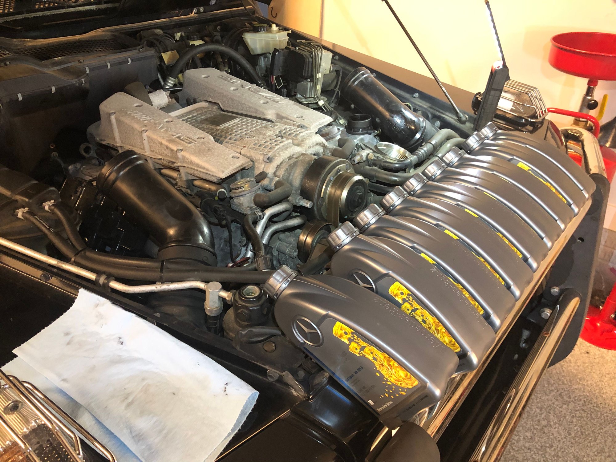

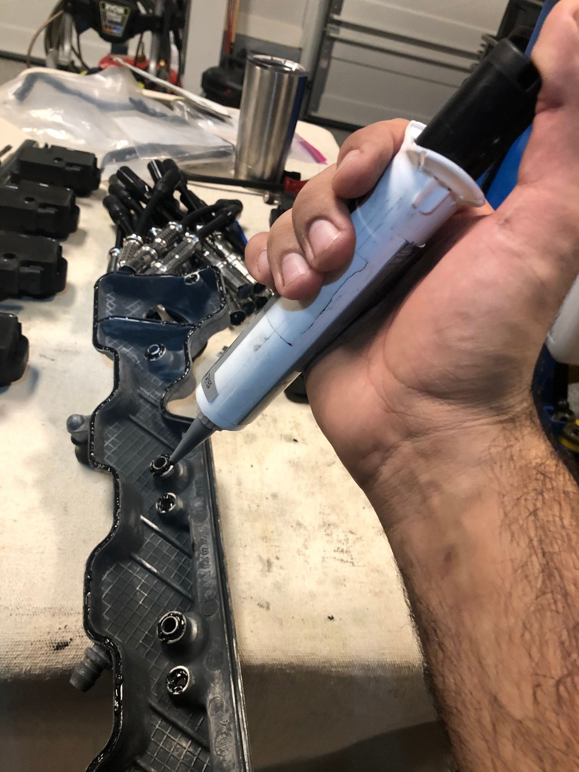

Everything is back together and oil has been changed!
Disconnected the fuel line to access that top right cover bolt on the drivers side, didnt realize how much fuel was held in the rail lol
FCP Euro sent the MB Breather Chamber gasket compound that was extremely difficult to press out of the tube manually but seemed to be very thick and evenly applied.
Performed an oil change before startup. Grill guard makes a handy bottle holder come to find out lol
Truck purs like a kitten! Looking forward to the drive to work!

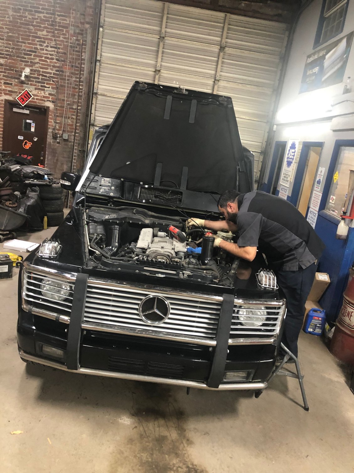

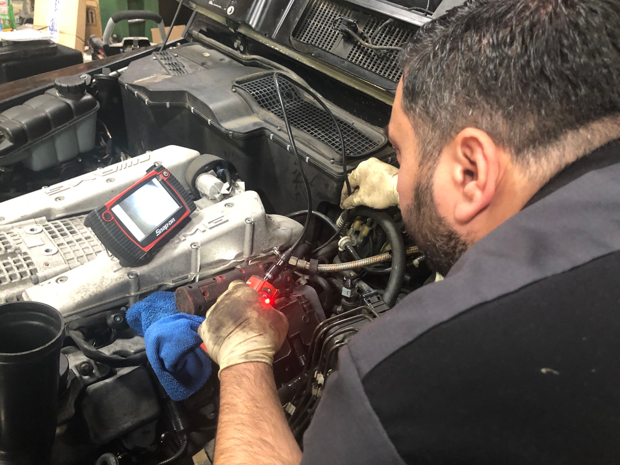

Never fails! Check engine light came on LOL
Code P0507 accompanied with a fast idle
Post #13 here: https://mbworld.org/forums/w211-amg/...-rpm-help.html
Im at work right now and can feel the hose on the back of the blower out of place but dont have the time/space to fiddle with it. Going to stop by a buddy's shop after work and plug it back in.
Drove it all day yesterday though and all is good except for the high idle.
Next stop: getting the head liner repaired!
Old Nov 14, 2019 | 08:43 PM
  #61
pdeacon's Avatar
Joined: Feb 2015
Posts: 1,015
Likes: 342
From: Cape Cod
E450 wagon, C43 AMG Cpe, GLE AMG 63S
Sounds like a vacuum leak???
Old Nov 14, 2019 | 09:26 PM
  #62
dgi's Avatar
dgi
Joined: Feb 2004
Posts: 283
Likes: 69
From: Baltimore, MD
93 Mustang GT, 94 Corvette ZR1, 2004 CL55 AMG, 2012 MP4-12c
Indeed!

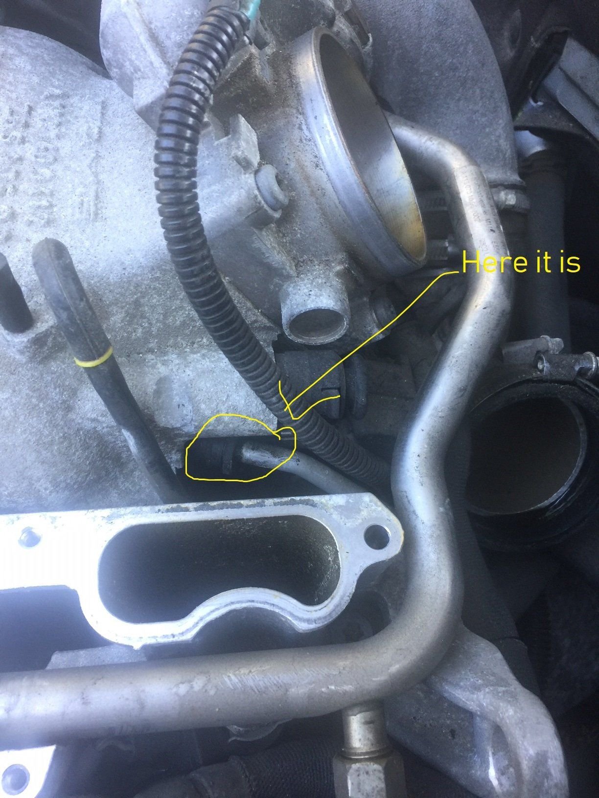

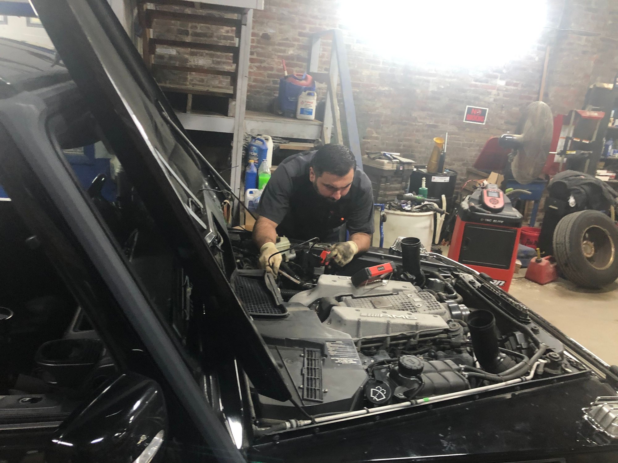

Went by my buddy’s shop after work and what a pain this little metal tube was to get back into the grommet in the back of the supercharger, mainly because you cant easily see where the hole is.
Found out the W463’s hood does have a “service position” lol
Remove hood strut from fender and carefully lay back against windshield
Snap-On camera to aid, little success
This picture from google helped illustrate where the pipe needed to go
My buddy was talking with customers and I ended up laying across the hood with two flashlights and weird angles to get a peek at where the pipe needed to go.
Idle back to normal, CEL reset. Silky smooth drive-ability restored

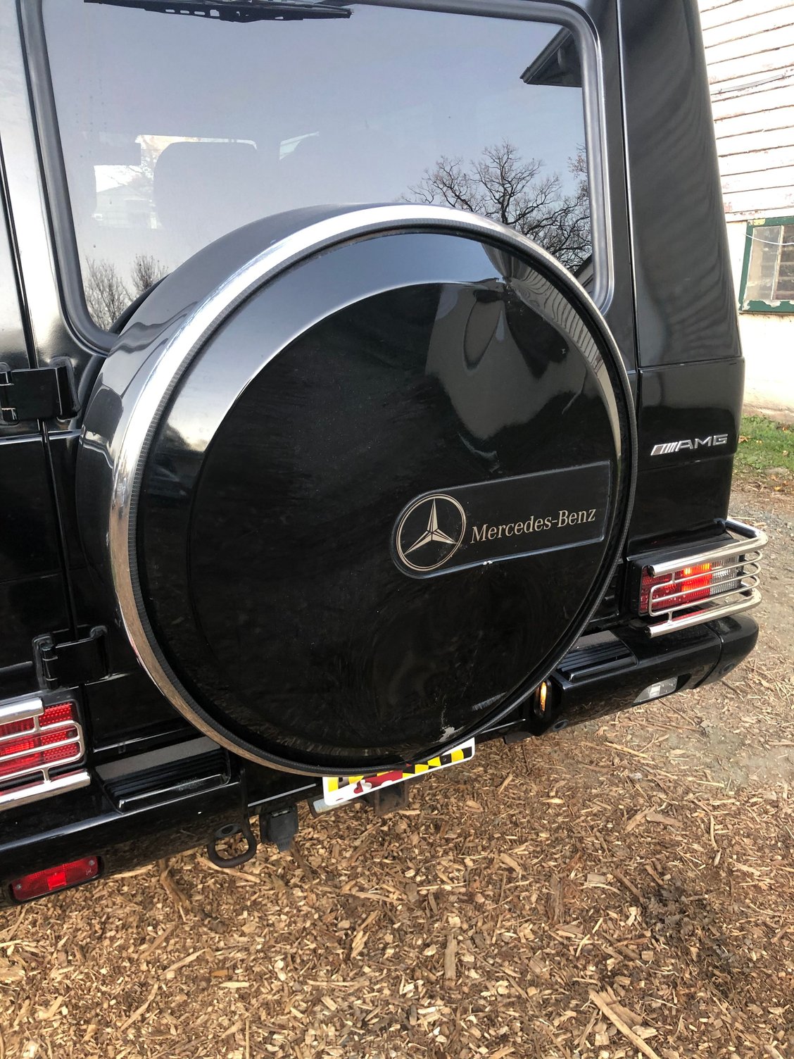

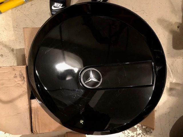

Enjoyed a day out with the family in the G55 yesterday!
The more I drive it after its recent service, the more I enjoy its new smoothness!
Attended a birthday party on a farm yesterday and leaving, I backed into a tree (so much for effectiveness of backup sensors lol)
Now im looking for a spare tire cover... at least the chrome surround was not damaged

We may not be a large group of active members here in the W463 camp but the few who are around are an excellent bunch!
A member here really hooked me up today with some parts he had laying around after upgrading his truck! Cant wait to continue with the rejuvenation of the G!
Turns out the Pirelli Scorpion Zero on the truck currently is a “all season” tire but we’ll see how effective it is this winter. Planning on swapping them out by next winter either way. Found a neat little calculator online and I think a 285/60-18 will be a nice compromise
The Mini Clubman is on my lift waiting for new brakes currently and the my Mustang comes home from an engine overhaul so I may have a friend install the shocks.
Either way, alot of progress happening with the help of good people!
