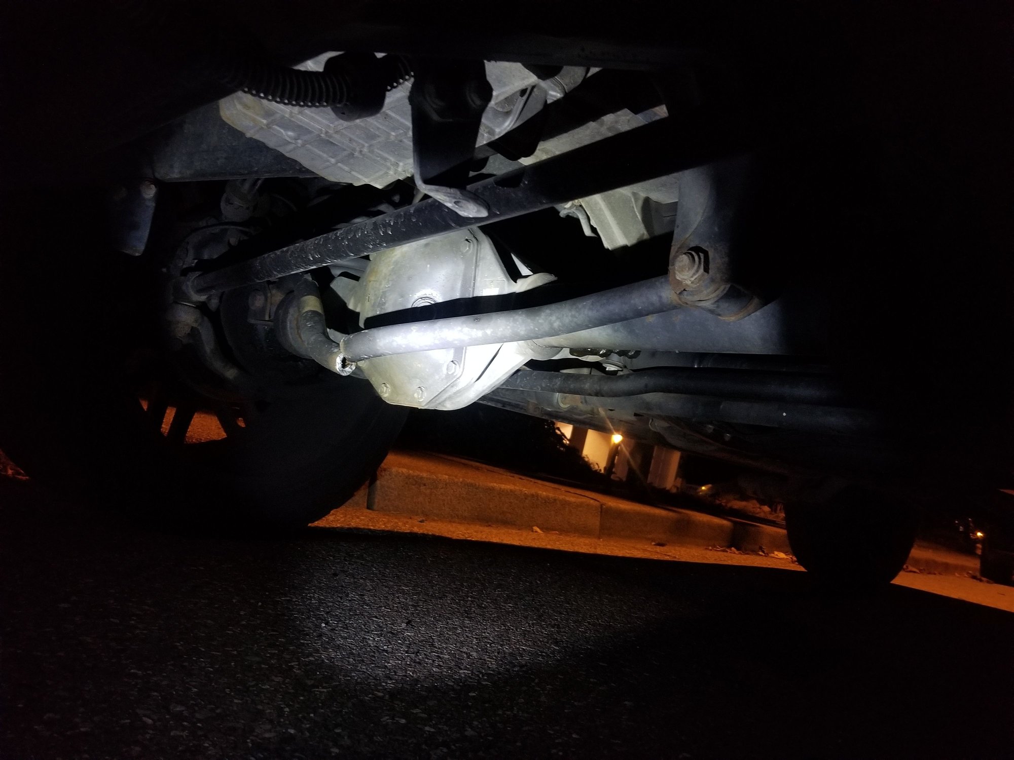

Hey guys my steering has been wobbly for the last week. I made an appointment to have it checked out on Tuesday. I was moving the G last night and felt a crunch. Look underneath to see this track bar broken from the middle. Does anyone know what part numbers are required? Any form of advice would help. Thanks

Thats odd....
463-330-07-07

Heavy duty aftermarket replacement:
GFG Heavy Duty Panhard rod

Wow! That thing is sheared right off?? Were you involved in extreme off roading? Or did you slide into a curb or something? You might want to check other elements of the suspension to see if anything is seized or not functioning properly. Good luck.

Difficult too see, since there is not a close up of both parts, but to me it looks as if the weld failed.

I was not offroading or anything like that. Not sure how this just broke. I've ordered the parts and will have the truck towed to the shop when they arrive. Since I didn't hit anything the rest of my suspension should be ok right?
