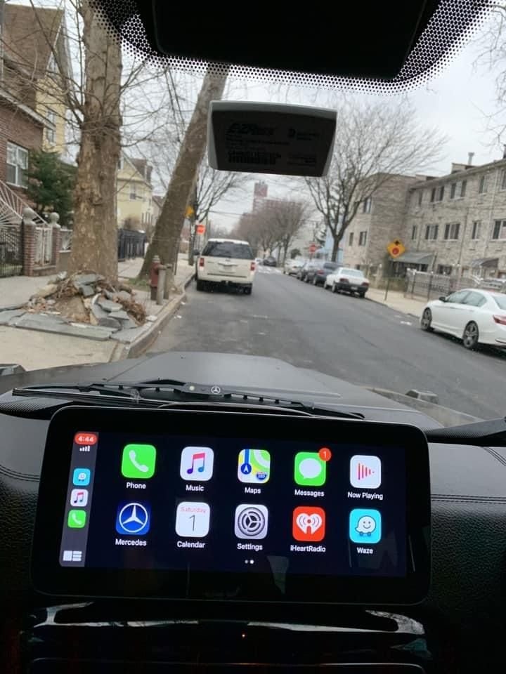

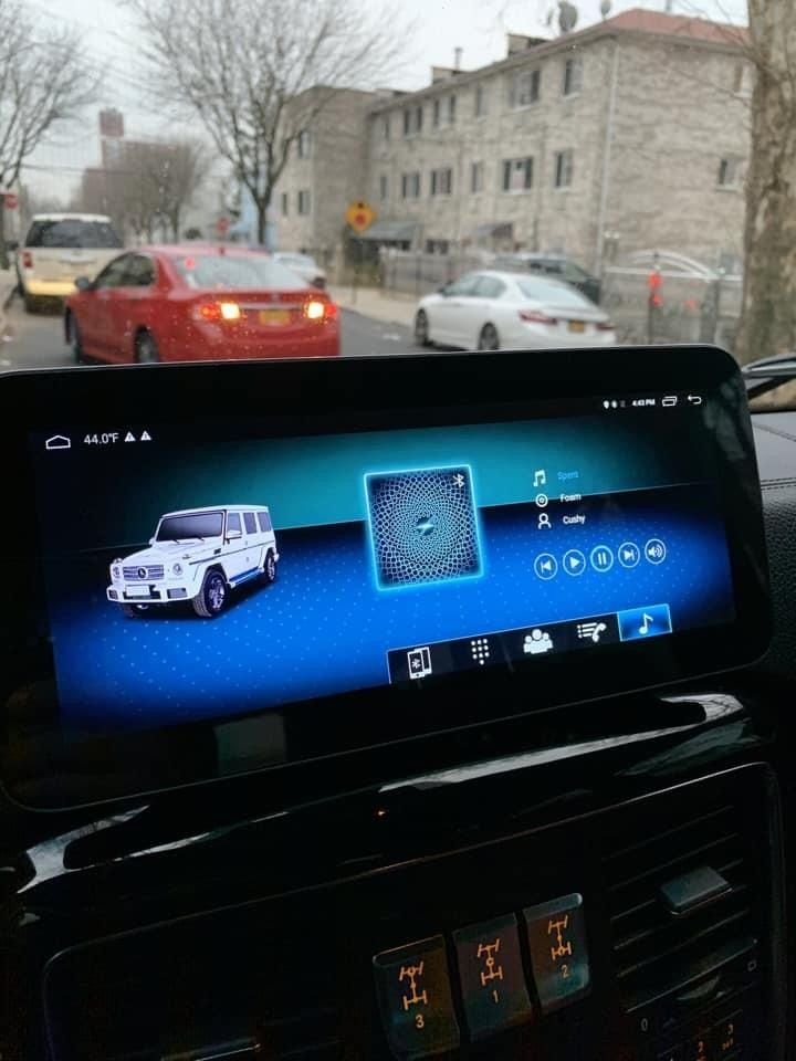

It’s a little complicated than it looks. There are plenty of YouTube videos but not for a G though.
Why not just take it to a professional audio shop to get it done to avoid screwing up/burning the harness? My Indy shop did mine in about an hour & half.
it took them a good time before they could get the factory screen out.
I was able to get a look when they were doing it... what i saw was the trim around the center console/middle air vents/radio pops off easily with a tool, once it’s off the screws holding the radio becomes visible, then you can unscrew and pull the radio out to get to the back of the wiring

Yes I love it. No complaints and I haven’t had any issues with it. Gives the car a modern feel.
the sound quality is still the same as factory if not better since the screen has a built in equalizer and “loud” button.
When I first initially installed though , sound was clear and high quality but I was getting static background noise when I stepped on the gas, I ordered a ground noise loop adapter for less than $10 on Amazon and that canceled the static noise. Sound is super clear and high quality even better than factory.
You also have the option to go back to your factory NTG screen. The screen retains all factory functions.
