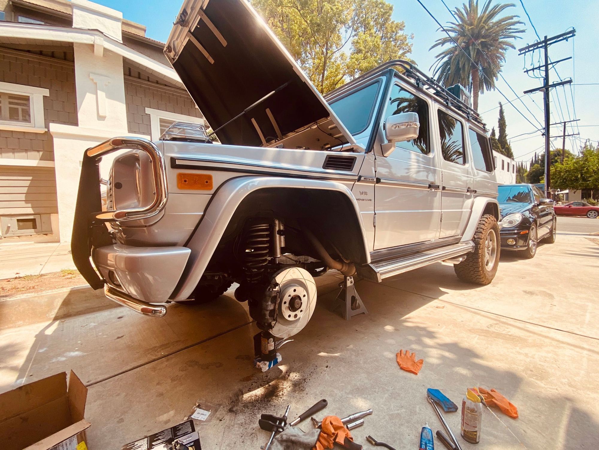

Brakes are one of those jobs that when I am in the right mindset it's a great thing to tackle.
I was on the fence about doing my fronts before my trip to Seattle, but just reading this made me bight the bullet. Just ordered front rotors and pads, they'll be here tomorrow from FCPEURO.com
Brakes are pretty straight forward.
There are a ton of great tutorials on YouTube, just out of curiosity I searched and found this great video... guy has a great accent too lol
A few tools you should have (Everything with links are previous purchases I've made and are all 5 stars in my book):
Gloves & a rag or two. It's a dirty job.
Floor Jack, get the heaviest duty one you can at a parts store or home depot/LOWES
6 Ton Jack Stands
https://amzn.to/3hh3udK
Brake Pad/Piston spreader (This guy uses a prybar in his video, the tool below is the only way to go)
https://www.amazon.com/gp/product/B06ZZ25DHN/ref=ppx_yo_dt_b_search_asin_title?ie=UTF8&psc=1 https://www.amazon.com/gp/product/B06ZZ25DHN/ref=ppx_yo_dt_b_search_asin_title?ie=UTF8&psc=1
Impact Screwdriver ( You will need this to break the screw loose on the rotor itself)
https://amzn.to/34f3tmW https://amzn.to/34f3tmW
Get a nice heavy rubber mallet, you will need to likely "persuade" the rotor off. You can use a hammer, but be prepared to walk away with a headache and **** off your neighbors.
https://amzn.to/2EbqoVz
You will want to open the brake fluid reservoir before you do anything to the brakes, this allows the fluid to escape the lines when you apply back pressure on the pads to loosen them.
Also you will need some open ended wrenches to open the bleeder nipple and a bit of hose to attach to it to assure no air goes in when you bleed them.
I usually have my wife help with the pumping of the brakes.
My order comes in tomorrow, have some pretty big meetings until Wednesday late afternoon. Either going to tackle after my last meeting or Thursday morning. I'll take some pics for you as well.

I just went out to double check and my rotors are toast! So when I get the new OEM rotors and the ceramic brakes I think I'll be in a whole new ballpark.
I will be towing a motorcycle trailer for a bike I am picking up just outside of Seattle after I get settled in my new house, but no serious towing yet. Have been looking at some 25+' boats, but think I'll miss the season this year in the PNW.
Thankfully my father in law has a nice yacht, in Victoria... Which I hope opens up to the US one day.
I'll give feedback with some images of my rotors in this thread and in my build thread once I get them installed and some miles on the truck this week.

Man my front rotors were trash. 3hrs later and I have brakes and rotors replaced. Pretty easy, a bit different than that video on my '08 G55, definitely an older model two piston caliper.
I'll do a write up in my other thread, I'd rate it about 4 out of 10 in difficulty. Doing it during a heatwave in LA... it's about a 7 out of 10.
