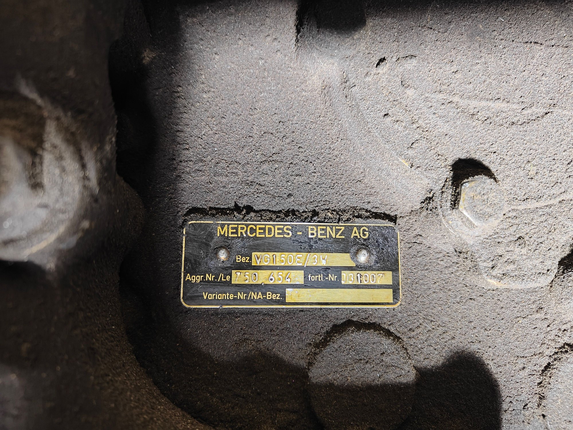

Hi. I have a 03'G500 transfer case stamp 750.654. Can you tell me what fluid to use? 75-90 gear or a Mobile 1 transmission fluid?I tried the PDF file and couldn't find it.
Thanks
