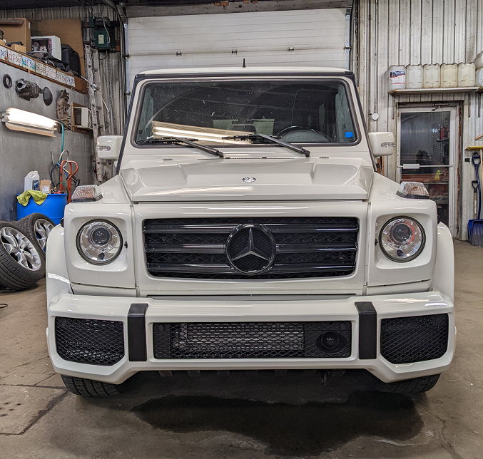

Pic of G63 bumper. I had chrome pieces wrapped in 3M by person that painted the bumper
I also made it work with stock fender flares. Just had to make small notches in the flares, which can't even be seen
As for Fog light warning, talked to my buddy mechanic. He says LED resistor pack, with no LED H11s plugged in should do the trick

Looks great. Can you post more photos? Where did you get the bumper?

Looks good although a little strange without the updated LED headlight frames to go with the bumper. Agree LED resistors with H11s would be a decent way to go. You could also get some aftermarket Brabus LED lips/splitters and hook the fog light up to those.
