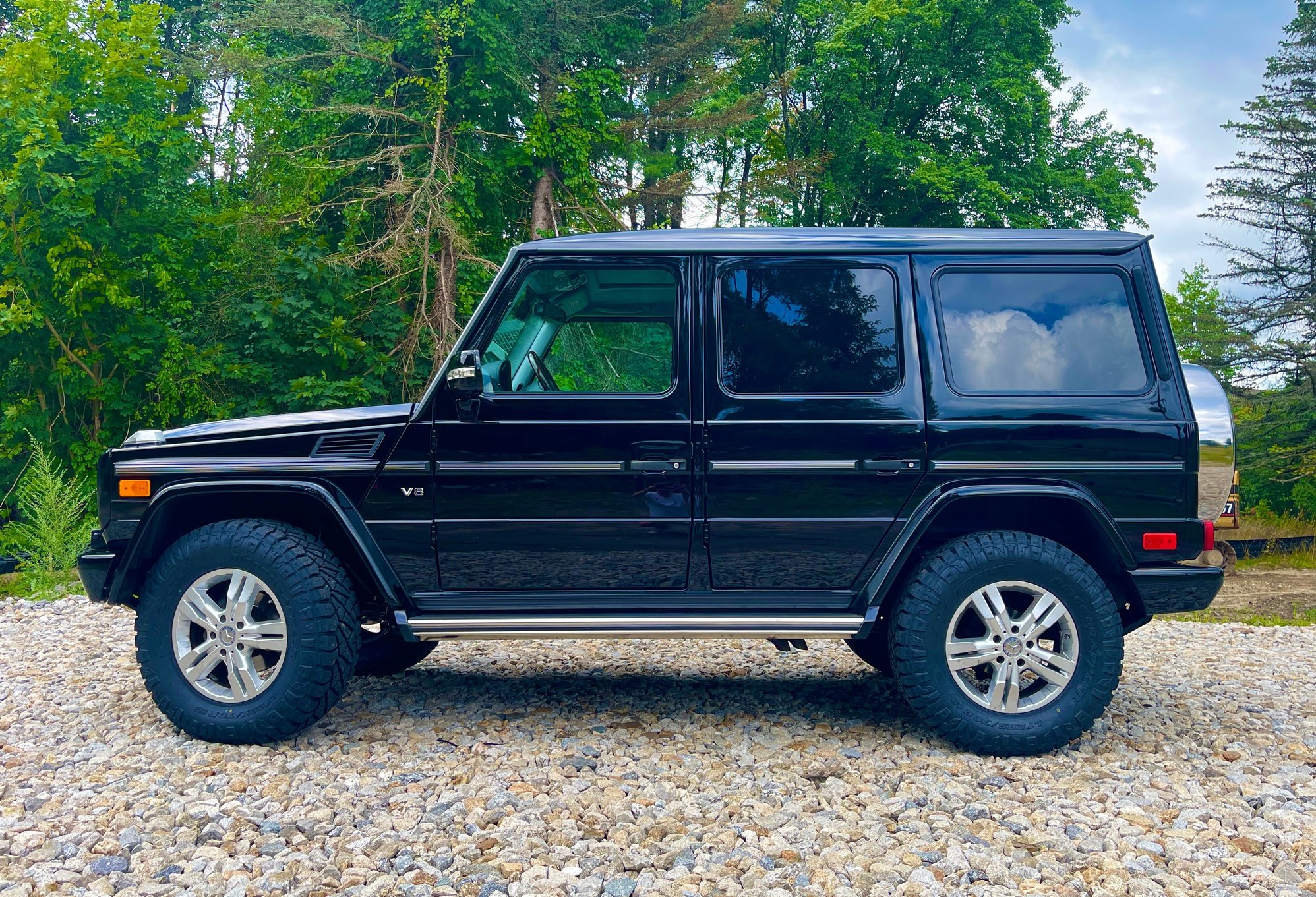

Stock ride height and stock 18” rims? 275 65R18
I have a 40mm JWO lift with 285 70R18 tires. Gives me just enough room to clear at full lock.

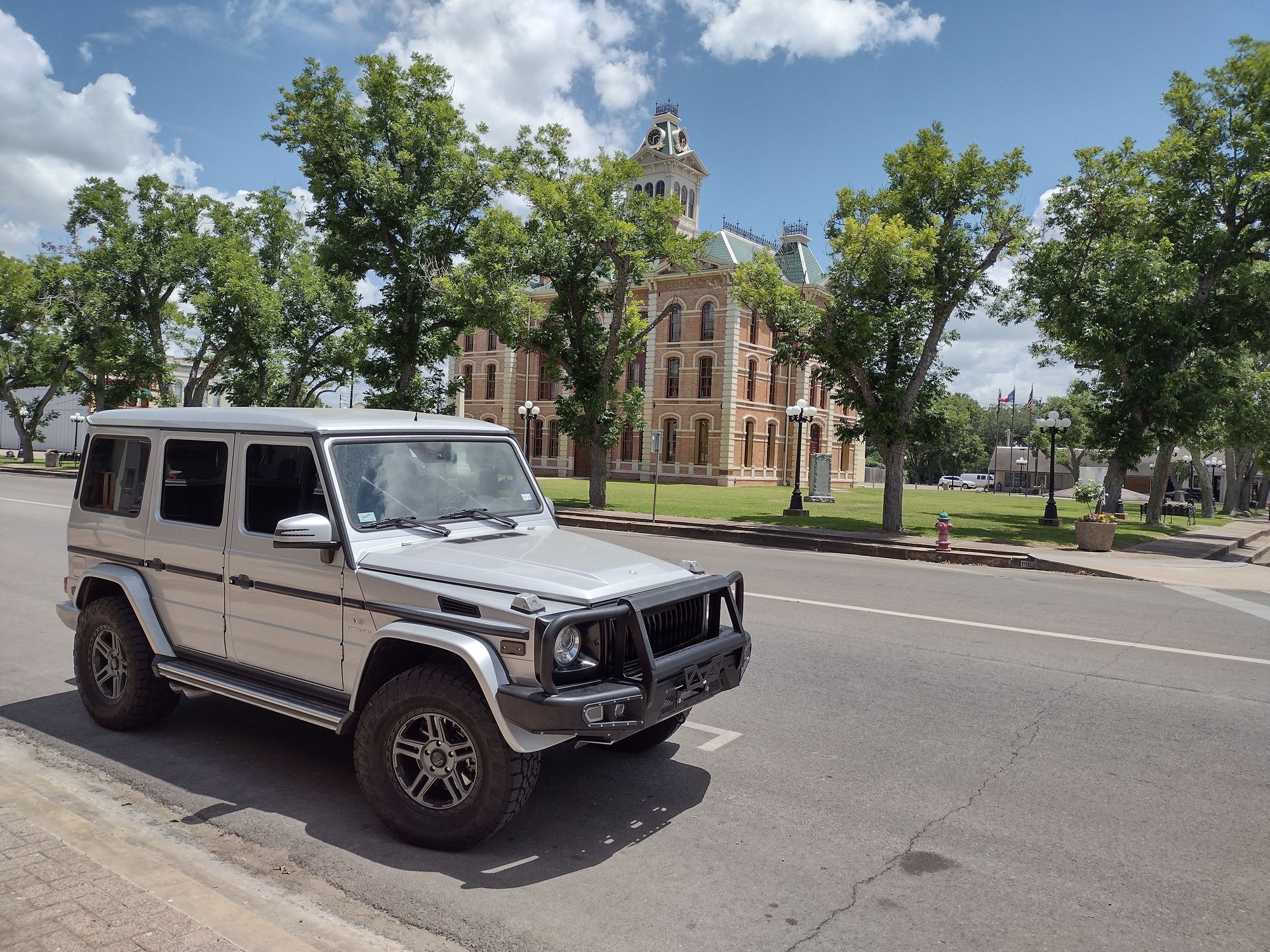

Afternoon -
Thanks ! It's the AFN bumper - jackwagon can get it for you..... and I've got the rear swingout AFN bumper on as well.....
working to get my Warn and lights on the front bumper today and will share some pics ( also just finishing up the JWO 4" lift with some new 325/65's....35" or so...)
Cheers

Updated pics of 4" JWO lift and 325/65's(35+")....still waiting to get winch and spare on...but loving the lift and setup so far. Interesting to note that the G 's tires look larger then the 35's on the 80 series and it's taller WITHOUT the pending roof rack ! Glad I'm going with the alum option given it's height.....

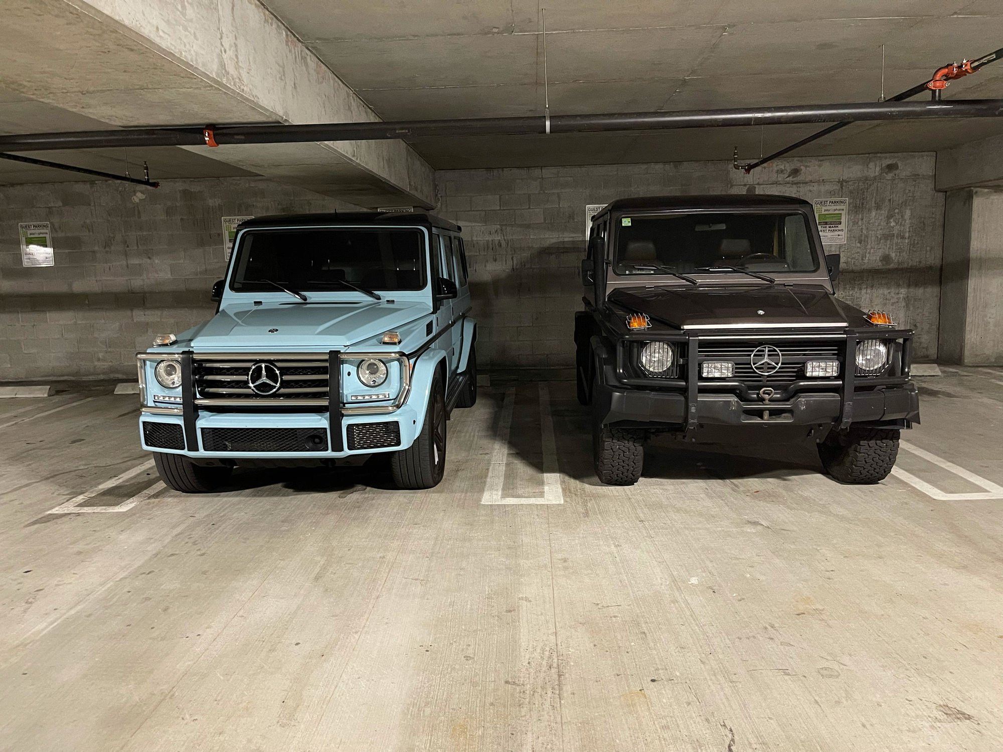

Thank you everyone for so much in put! Looking into an 18" wheel option!
@PeriodCorrect I'm actually a nurse practitioner and aesthetic injector!
These are my 2! 1986 and 2016!

Is that wrapped? Looks great! Would love to follow you on IG if you have one. I too am going from the 19” wheel on my G550 to an 18” option. I’ll probably do a 32” KO2 though. I don’t want a lift or huge tires!
