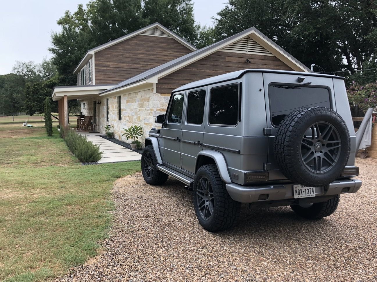

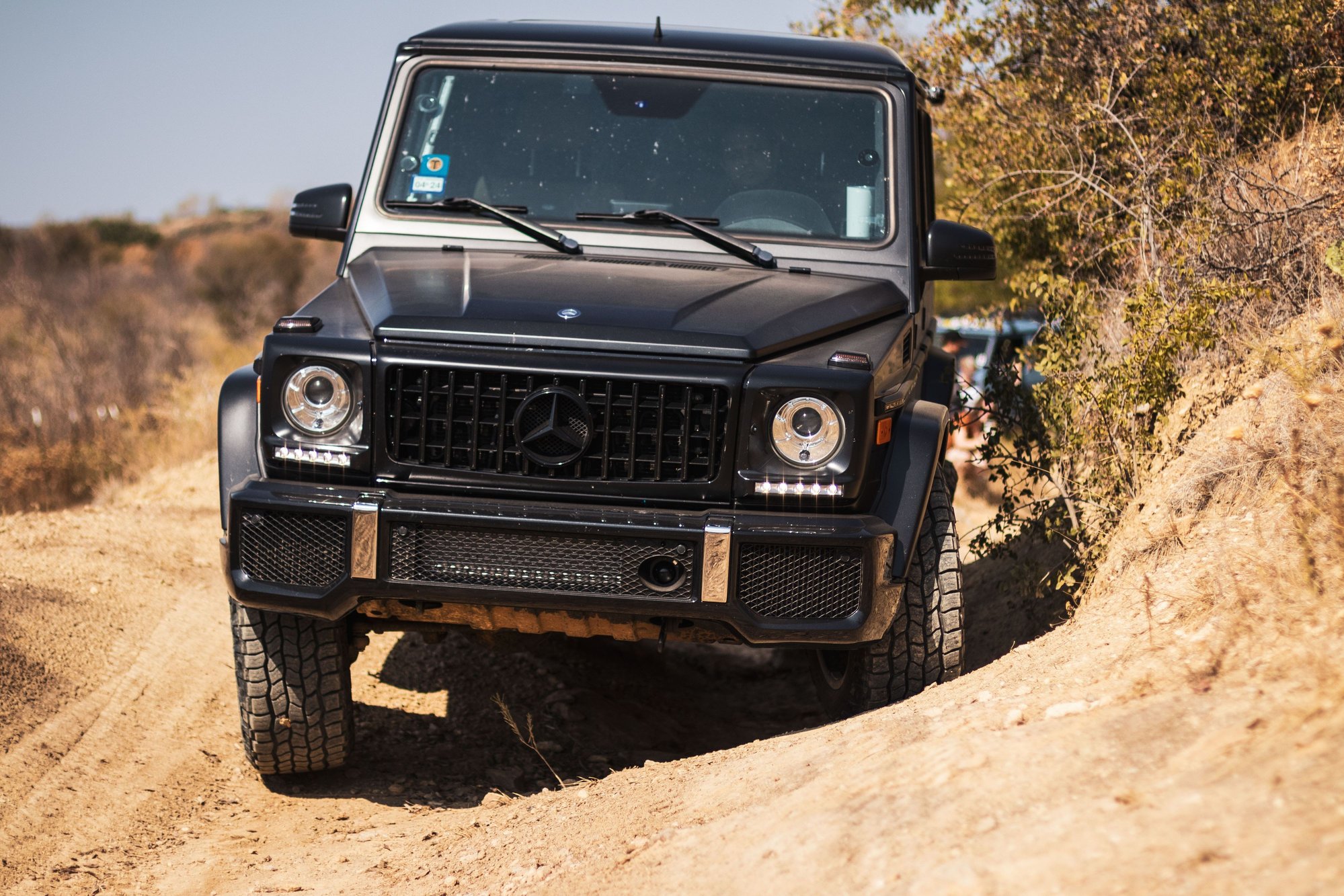

the g55 is currently running the Alpha Grenades 18x9 et 25 plus 31mm spacers and a 325/65/18 - pics below.
The old G63 ran a custom Forgestar 20x10.5 et 25 - and 305/55/20 noth set are toyos AT's - some pics in this thread https://mbworld.org/forums/g-class-w...-2013-g63.html
