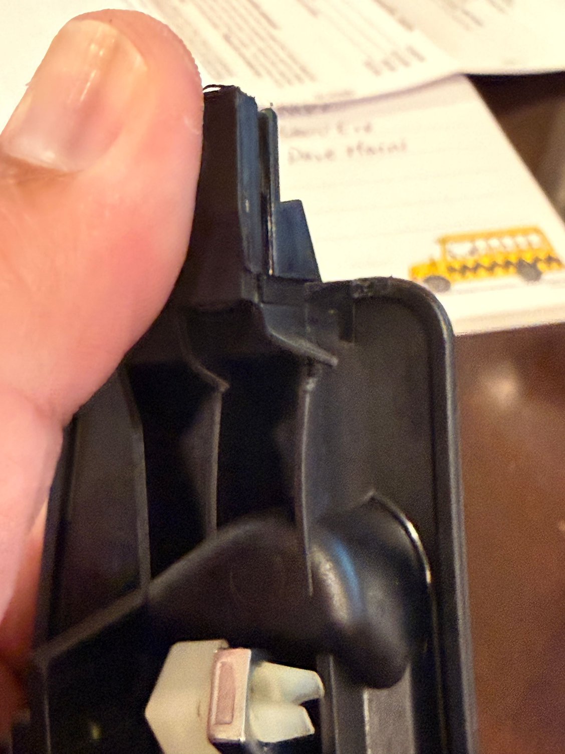

I would venture to guess that if the door lock solenoid wasn't providing enough force to push the lock rod up, then it could happen again. Usually you can just pull the lock pin up though to unlock the door. Also pulling the handle should unlock the door, but your latch mechanism may need cleaning or regreasing.
Also, since you said that the exterior door button was sticking, you should open that up and clean it, and replace the o-ring as they will all eventually fail.
I posted about the exterior door button and the interior handle before, but haven't taken apart the latch mechanism.
Interior door handle cable holder failure - this happens to all original door handles. The new ones have an updated design that is supposed to be stronger, at the cost of $120/each. I made a 3D printed design to fix this.
https://mbworld.org/forums/g-class-w...ml#post8496210
Door button sticking issue - o-ring breaks apart and starts to jam the button. Local hardware stores should have replacements in the correct size. I got mine at a local True-Value.
https://mbworld.org/forums/g-class-w...ml#post8512276

Thanks to all for info. I finally managed to get the inside door panel off with the door closed and didn’t break anything !! I first removed the rear left seat so I had room to work. Once the seat was out the way I disconnected the interior door handle and removed to 2 big screws securing the panel. I was then able to get my hand in the opening and started to push the panel out and one by one the clips popped with help of plastic pry tool as I worked my round.
I was then able to push the door lock striker plate back out which pushed the door button back out and the lock released.
Looks like the screw on inside of door push button had worked itself out and was contacting striker plate.
All good now. Fixed !!

It was the door handle push button ‘O’ ring. The O ring disintegrated into 3 pieces in the lock and essentially prevented the push button from moving fully in to disengage the striker plate and open the door and of coarse was jammed in and would not pop out.
I managed to remove the door panel from the inside but had to take the left side rear seat bottom first.
After that I was able move the plastic liner aside and push the lock mechanism and unlock the door.
New o rings fixed the issue. I changed the o rings in the other 3 doors and the rear door. No problems since.

mmmm…..not sure what’s going on in your case.
All I can offer is that in my case that push button seal had broken in 3 pieces and one piece lodged itself behind the push button enough to just push the striker plate in but not enough to unlock the door and another piece lodged on the side not allowing the button to pop out again. So it was stuck in and striker plate not pushed in enough to unlock door. That also rendered the inside handle lever to jam not allowing the door to open from inside either.
Maybe there is piece of seal jammed behind the button that is messing with that striker plate movement.
Suggest to take apart the door handle once you have panel off and see if that seal is messing things up ??
I figured out what it was, and fortunately I didn’t have to take the door panels off.
The culprit were the door handle themselves. Their design seems good, except for the part where the cable sleeve needs to be kept in place. That part was broken on both rear door handles in my case. — Hopefully the picture shows what I mean.

Yup. This is a weak point of all the original door handles. I made a DIY repair for it, or if you buy new door handles, the designs should be reinforced. Send me a PM and I'll get you sorted.
