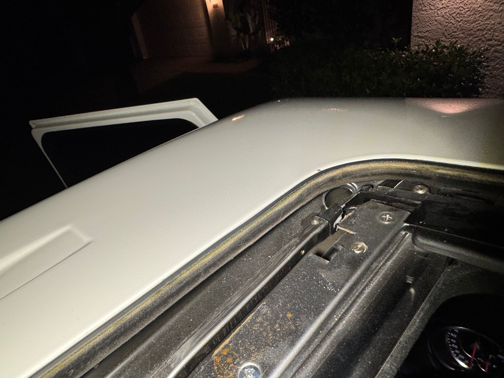

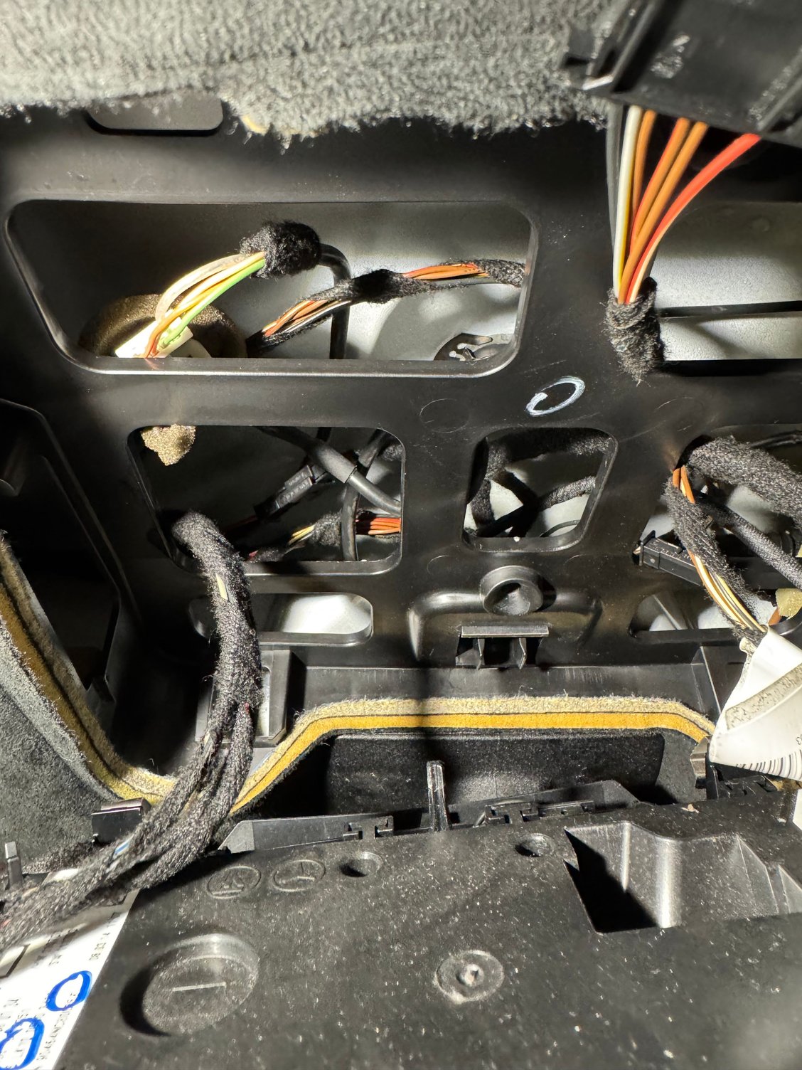

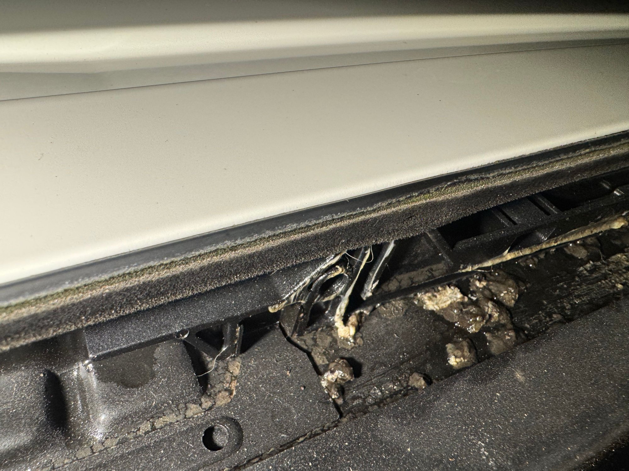

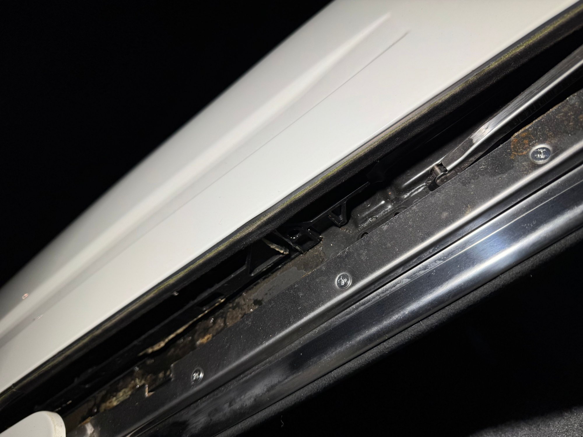

Quick update. Got the car towed home. It’s not raining finally so I opened the sunroof and tried to diagnose further. Lots of moisture in the sunroof drain pan area as well as behind the cabin light module (above the dash). I actually started the car and drove around with zero issues or warning lights.
I have cleaned the sunroof drains with the long pipe cleaner tool that is 7 feet long as well as blown air down them. Wondering if there is another area I am missing or a better way to remove all moisture from the inside of the car?
Currenlty sitting outside with all windows and sunroof open. Would love some more suggestions or input if anyone has any. Thank you all and happy new year!
