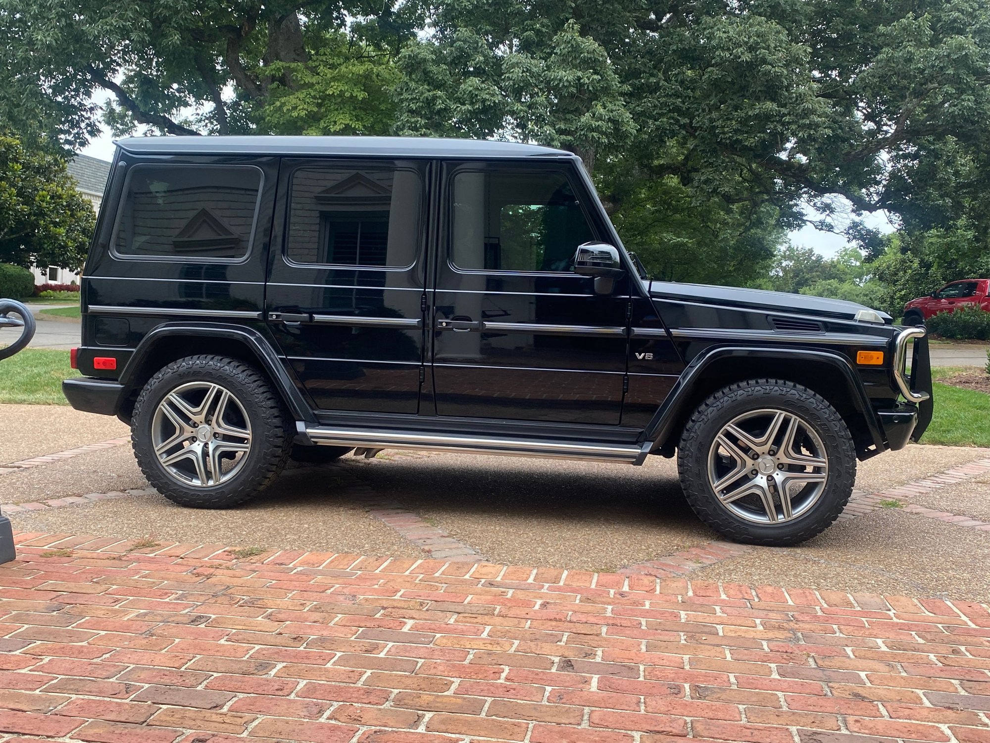

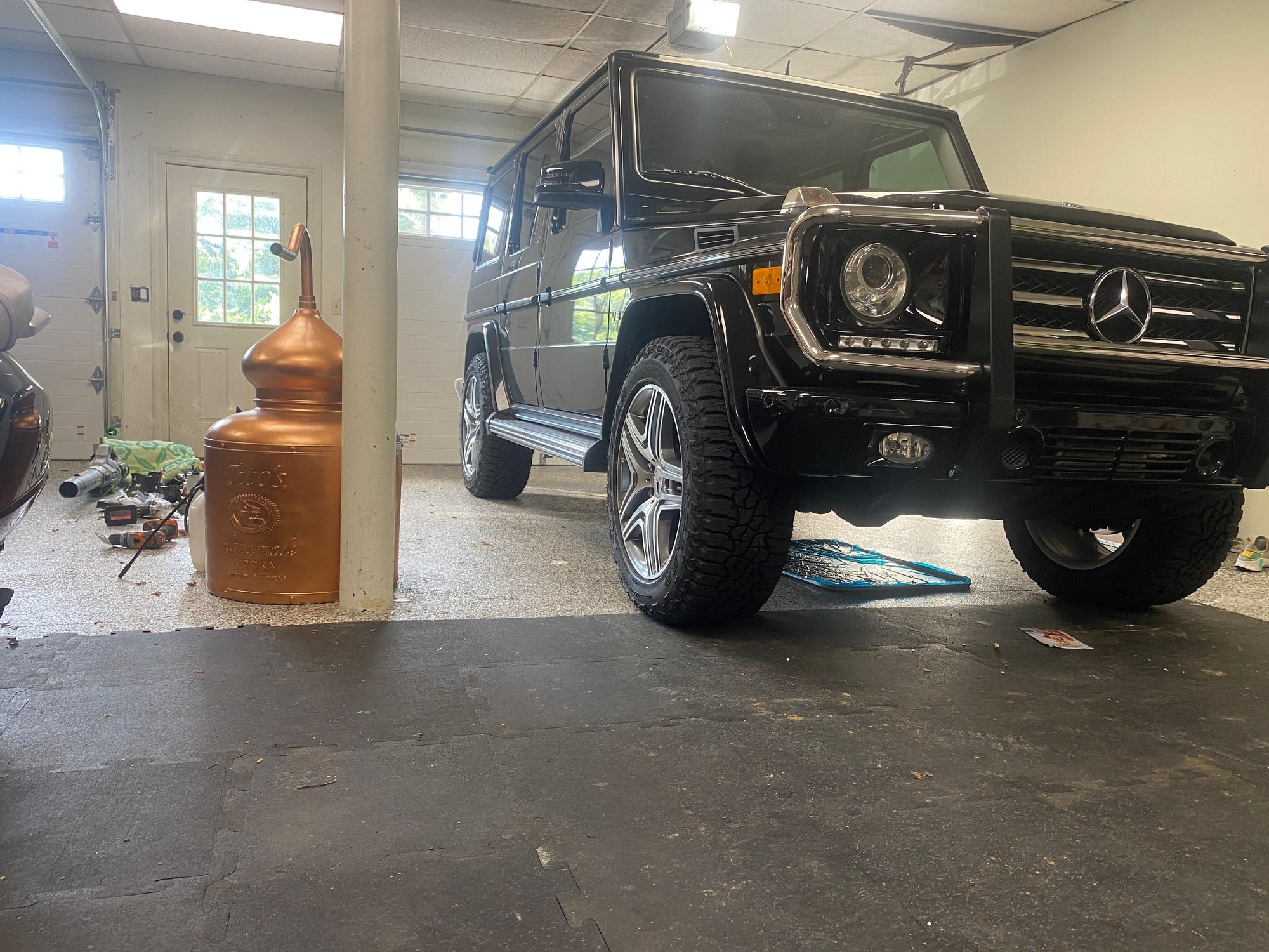

The 20's are on. What a big change from the 18's. Tires are Goodyear Ultraterrain / 265/55/20.
Looks great! Running the same wheels and have a set in black with snows.
Are you running spacers? The tire fit looks great
No spacers. I am very happy with how they look. Tires are 265/55/20 Goodyear Ultraterrains, and I got a screaming deal on the wheels on eBay. I'm keeping my old wheels/tires for now, so I bought new TPMS sensors.
