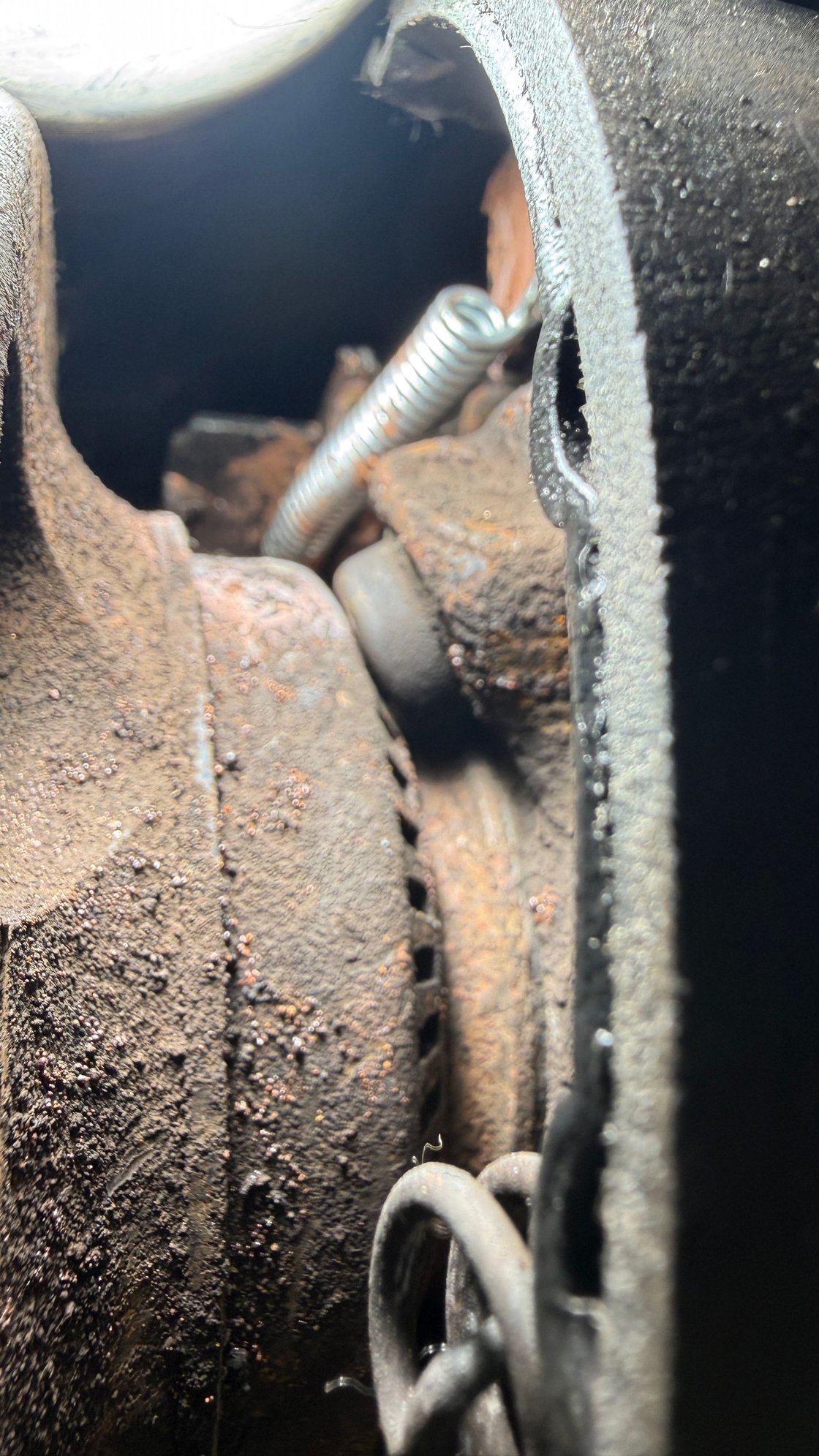

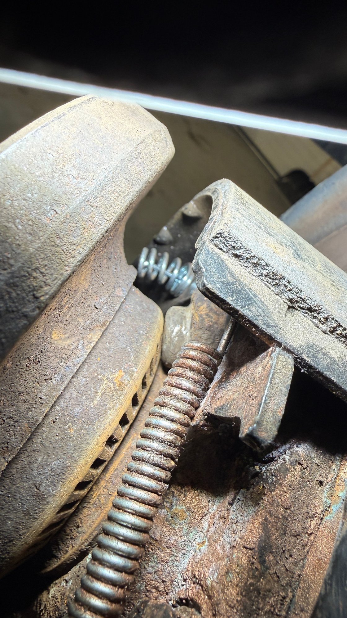

Thanks for reply
I checked the ABS sensors, found no issues with them, cleaned them, but unfortunately the problem still persists.
