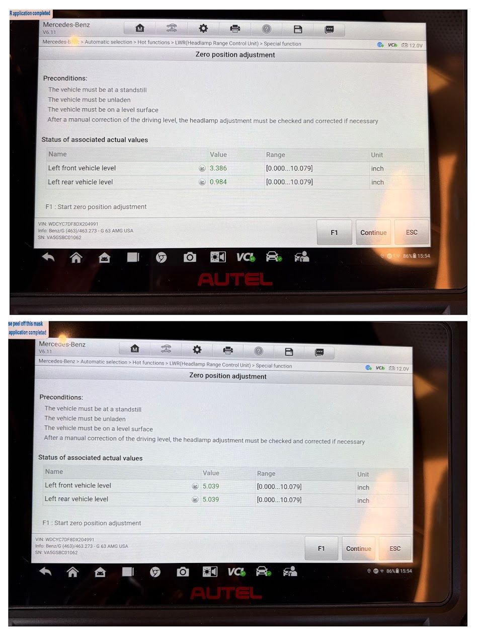

I bought a $1500 Autel (MS906 Pro) and have been exploring various coding options on my 2013 G63. Here are my initial findings, sharing for anyone else interested. I am barely scratching the surface so if folks know of other coding options, please post and I can verify with tablet.
  1. Axle ratio can be adjusted in the VG (transfer case) module. If you upsize your tires to 33"/34" it is useful to recode the software axle ratio to get the transmission shift schedules back to normal (they get lazy with big tires).
  2. Lockers can be coded to engage in High.
  3. Headlight zero point location can be recalibrated (useful after lift)
  4. Throttle pedal maps can be adjusted
  5. TPMS module can be restarted/reprogrammed
  6. There are some Instrument Cluster options like auto high beams that can be activated.
  7. Wheel/tire circumference CANNOT be changed unfortunately. It does not show up under the IC or ESP modules for my model year. Bummer.

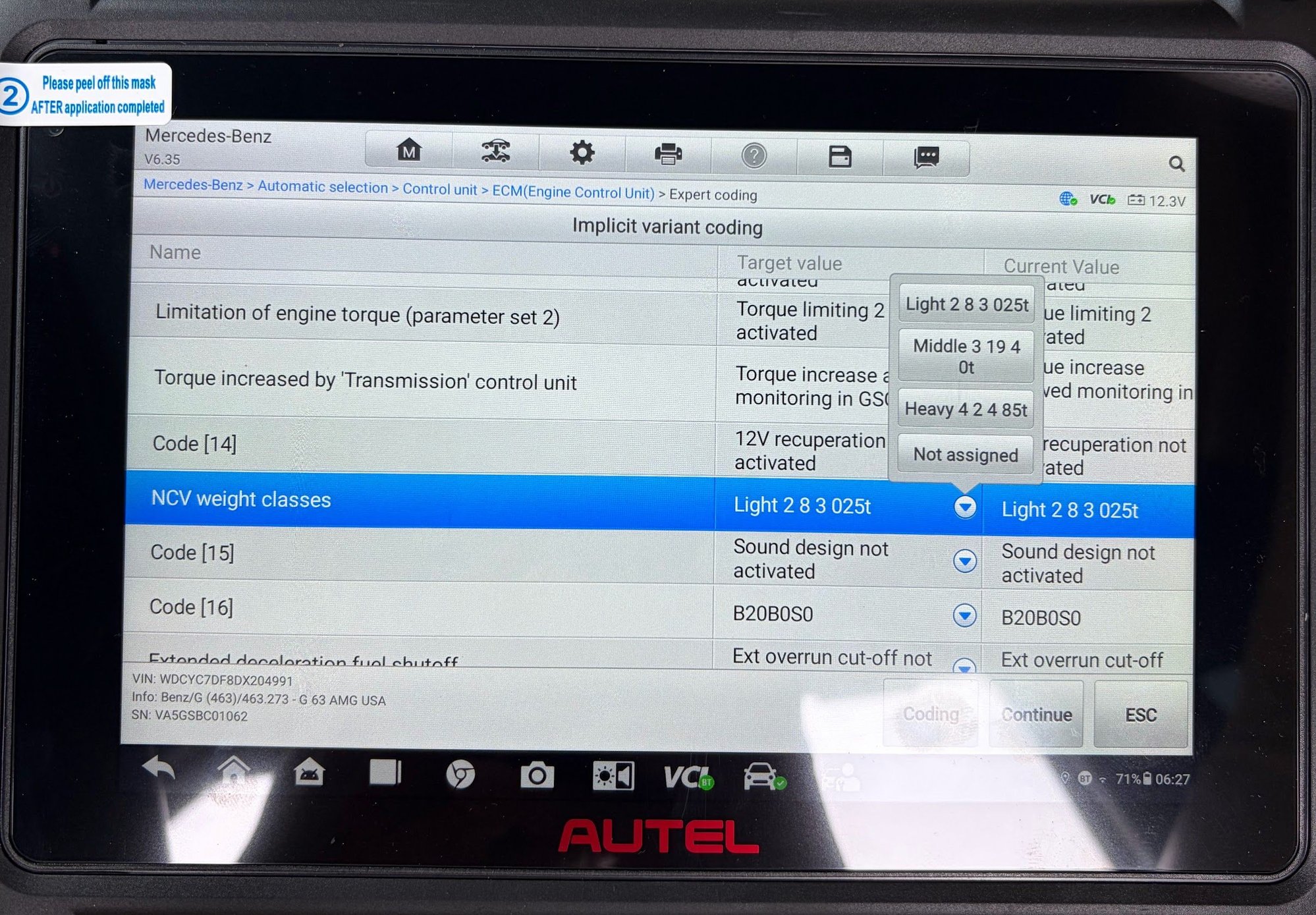

Here’s a summary of everything I recoded. This is my best estimate based on research for correct settings after lift and 33” tires.
  1. Lockers enabled for high range (VG module) Not related to lift, just a convenience.
  2. Rear axle ratio set to 4.375 (VG module)
  3. Rear axle ratio set to 4.375 (ESP module)
  4. Rear axle ratio set to 3.9 (ECM module). More on why this is different below.
  5. Accelerator pedal characteristic curve set to KLD_1_2 (ECM module) Two levels more aggressive from stock.
  6. Reset headlight zero point value (Body under ECM)
  7. Limitation of engine torque parameter set 2 set to torque limiting 2 (ECM module)
  8. NCV weight class set to Middle (ECM module)
That is correct, rear axle ratio is in three different modules. Tcase (VG) and ESP must match but ECM does not. They all have different available values and used for different purposes. Axle ratio changes to VG affect shift schedules, axle ratio changes to ESP affect stability and traction control and axle ratio changes to ECM affect torque output and torque cuts during gear shifts. None of them have to match mechanical ratio in the diff (which is 4.1). These values are used by the modules for calculations and increasing them tricks the modules into correcting for negative effects introduced by big tires.
#7 and #8 above were incorrectly coded in my car. 6 should be on for all AMG models and 7 should not be ‘light duty’ for G wagon. I do not know if it was incorrect from factory or if it was over written incorrectly at some point (I did have a eurocharged ecu tune for a bit then reverted back to stock).
Anyone with a lift and big tires must recode! Big difference!

What scanner are you using? They might all have different UIs and different screens. Here are the photos from Autel MS906 Pro - the breadcrumbs in blue font at top show you which module and which menu.
I work with Peter from BenzNinja !
We mostly had issues finding these ones
ECM = 3.9
ESP = match VG (4.375)
