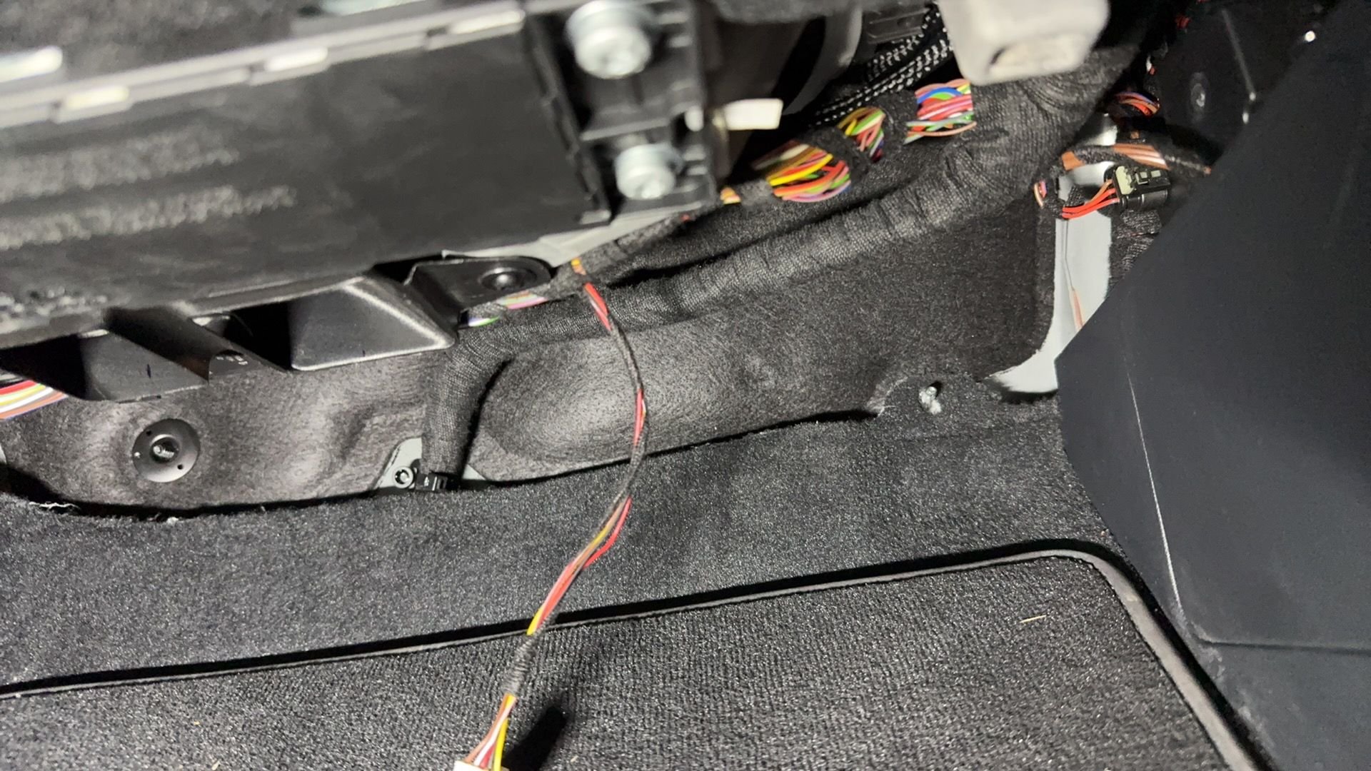

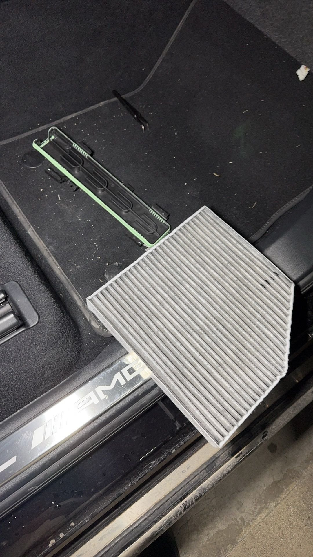

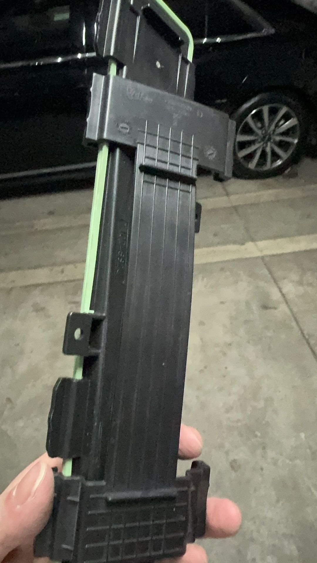

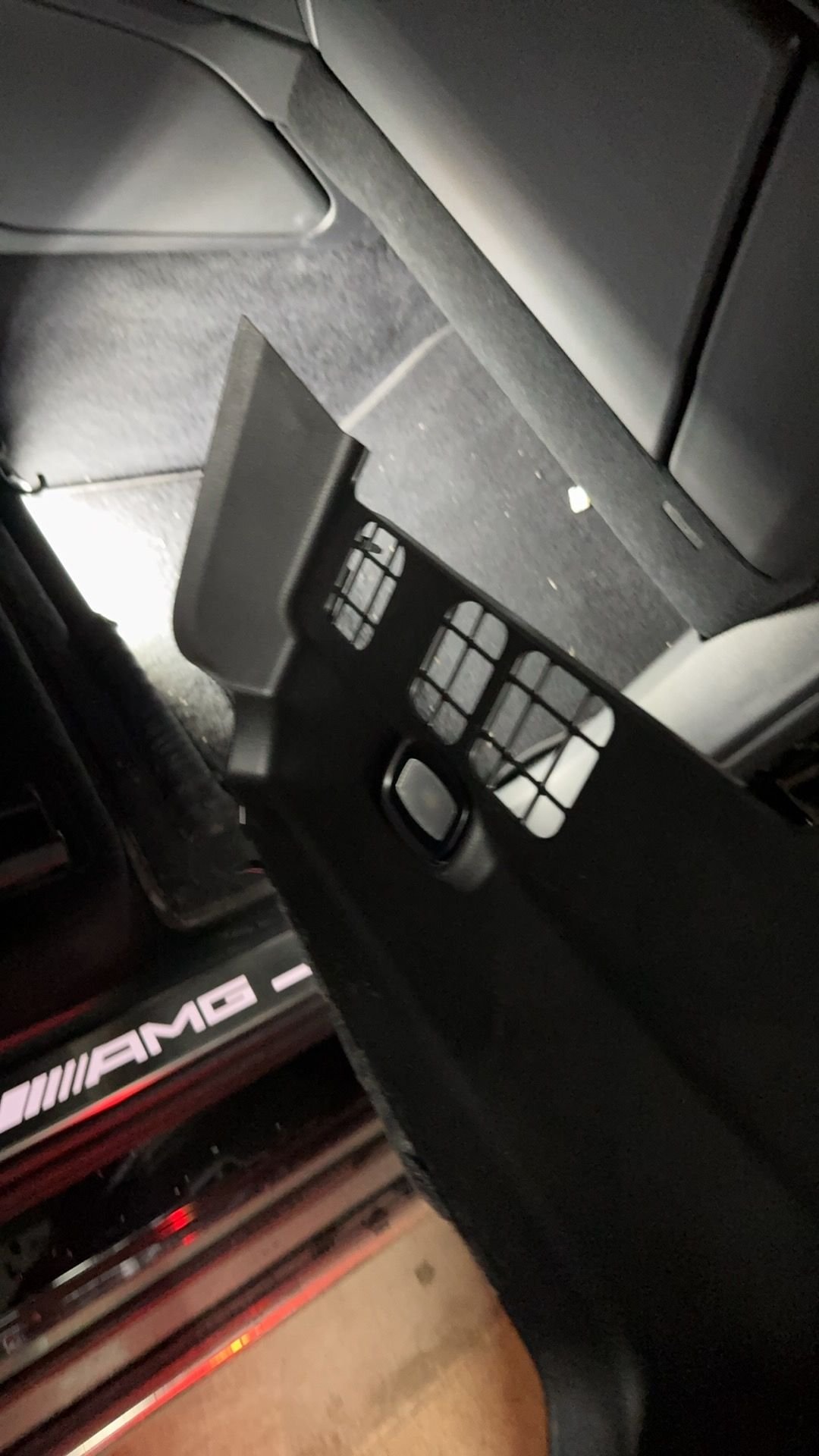

Just finished replacing this recirculation cabin filter, and I'll probably not do it again for as long as I own the truck. Took me about 3 hours, and I rate the task an 11 on a 10 point scale (changing out the transmission in my YJ wasn't much harder). I was going to write up a few DIY notes and post a couple pics to help others, but instead here are my thoughts:
1. The procedure in the service note attached to post #15 above has a step (1) "Remove trim", and references another service note AR68.10P-1502XG. Removing this trim piece, which is retained by several hidden fasteners, is extremely difficult and non-obvious. I can't describe how to do this even having managed to do it.
2. Removing the old filter wasn't too difficult, and the new one went in without any problem. Reinstalling the filter's trap door was difficult due to its location, seating, and slide fastening mechanism. You can't position yourself to see this area, a mirror and light help, but it's still mostly feeling around with your hands.
