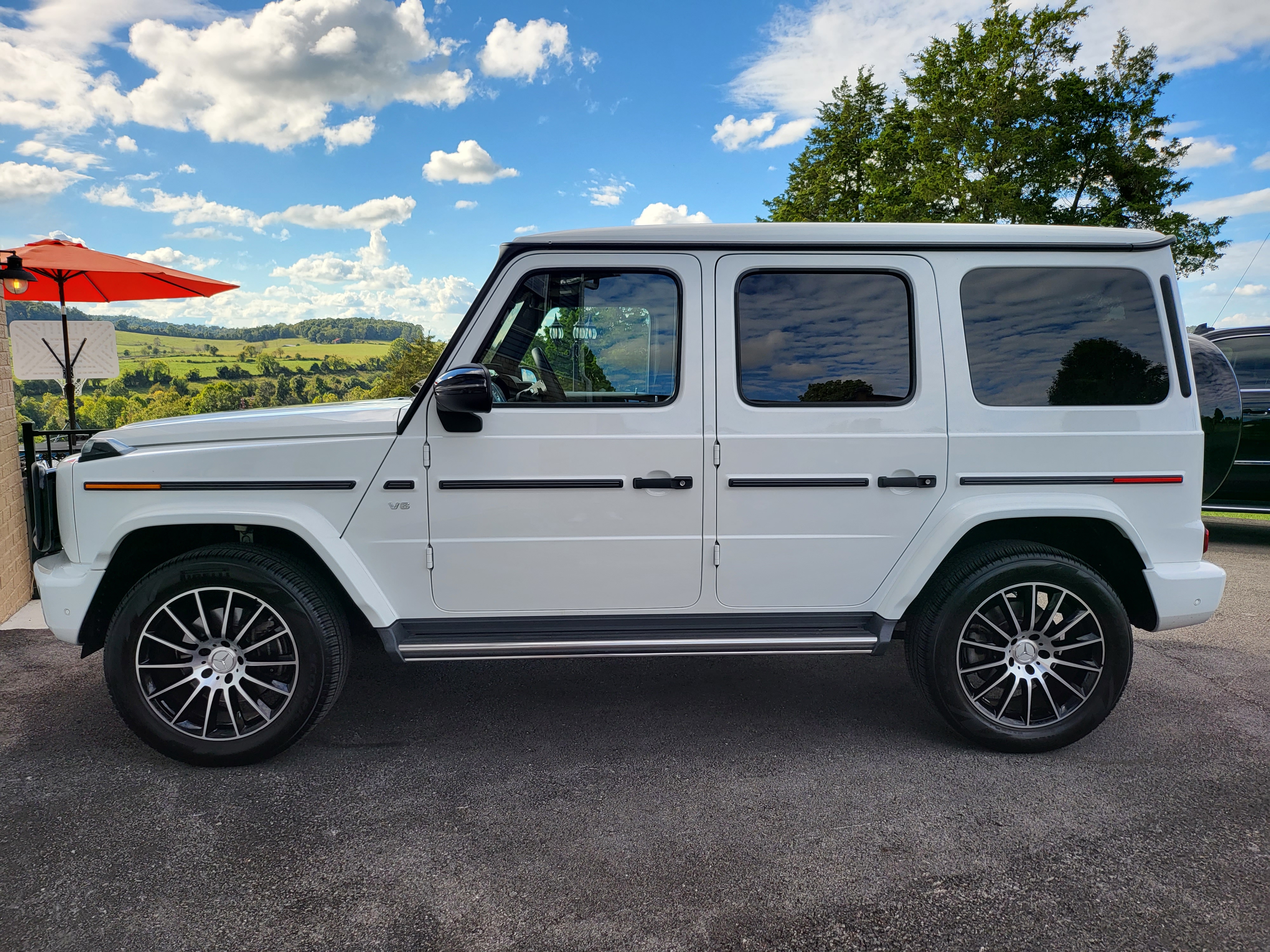

Recommendations please for new 20" tires. Drive a lot of hwy miles but like the meatier look of Nittos or KO2s.
Suggestions on size too please. Factory 275/50 or maybe 285/55.
Ride quality. Noise.
Pics appreciated.
