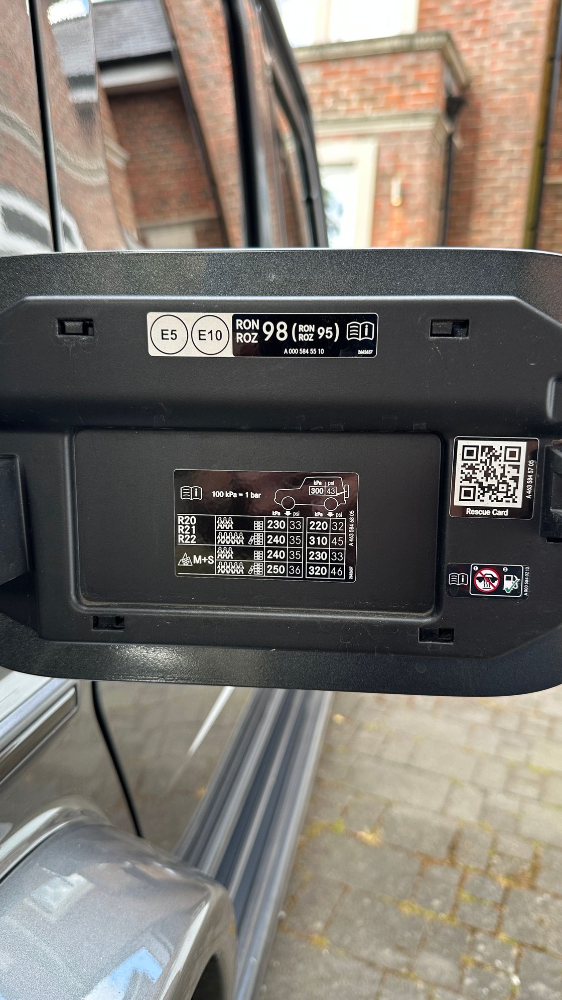

Does anyone know the proper tire pressure front and rear for a 24 G 63 with 22” wheels? The fuel door says 38 psi front and 49 psi rear. My 21 G 63 was 38 psi front and 35 psi rear.

My fuel flap door sticker shows 2 pressure settings for the rear tires, shown next to hieroglyphics indicative of number of passengers and pieces of luggage.

Old Dec 1, 2023 | 11:26 AM
Craig B's Avatar
Joined: Sep 2020
Posts: 1,118
Likes: 277
2025 G 63
I think you’re right, it does show the amount of passengers. I uploaded a picture.
thanks

That’s quite odd my 2020 says 230kpa front and 220kpa rear (33/32psi)
wonder why that is? I’ve just gone to Michelin Pilot sport SUVs these seem like a softer compound, wonder if mercedes changes these for the Pirelli’s vs Goodyear etc?
