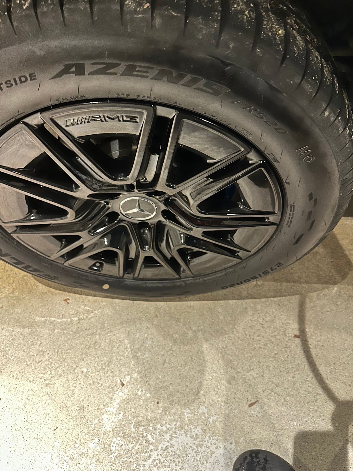

I just got my g580. WOW!!!! However driving home in NY I went up my dirt road with a light layer of snow and WOW!!! No traction with the high performance standard FALKEN tires..... Really scary and unexpected since I didn't realize these were standard on the G wagon. I am looking for winter tires and wheels and need some advise, Looking at tire rack and no real choices here. Any help would be appreciated!!!​​​​​​​

Falken Azenis FK520 MO 275/50R20

This is a "summer" rated tire -- worse than even a M+S rated all season. Congratulate yourself for making it home, and when you next visit your dealer, ask why they let you drive away in January with this tire mounted. Good news is that there are plenty of tire choices in 20" although you might need to up-size just slightly to 275/55R20 (MB specs 50 and marks its tires "MO" hoping you'll buy tires from a MB dealer). IIWY, I'd not drive the truck until you get new tires, something at least M+S rated, but preferably 3MPSF rated, or better yet a snow tire if the G580 will be your DD during the winter. The last two vehicles I purchased -- a G550 and an X7 -- were equipped with inadequate tires, and I changed them before I clocked 1K miles. Don't know who at car companies are spec'ing OE tires, but they're all woefully stupid. Drive one of your other vehicles to a tire shop and get some recommendations for tires that will meet your intended use. Then wait for a day when road conditions aren't winter and have the tire shop install them. Seriously, summer tires in a NY winter will land you in a bump shop with a big repair bill, and then you'll be kicking yourself for not buying good tires.

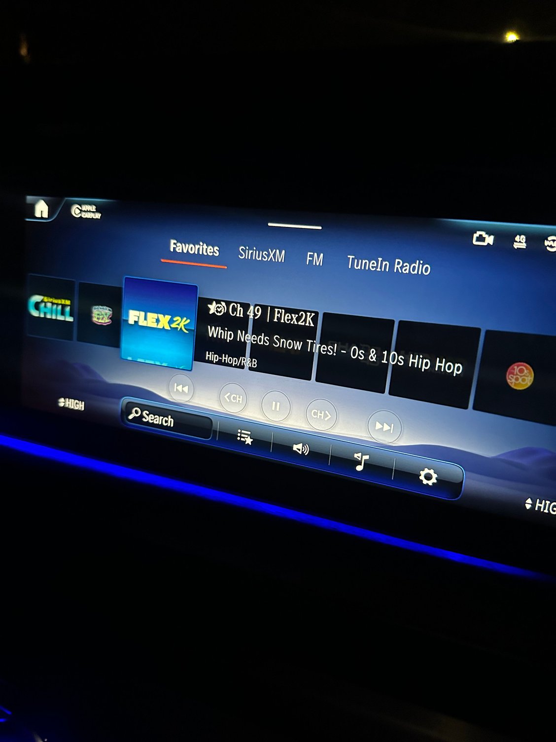

Today she was driving in snow… It was like a baby giraffe on ice! I cannot understand why the dealership did not disclose that these tires are summer rather than all season! Especially since we live in the northeast!
this song came on as we were driving home
