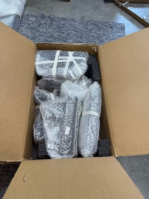

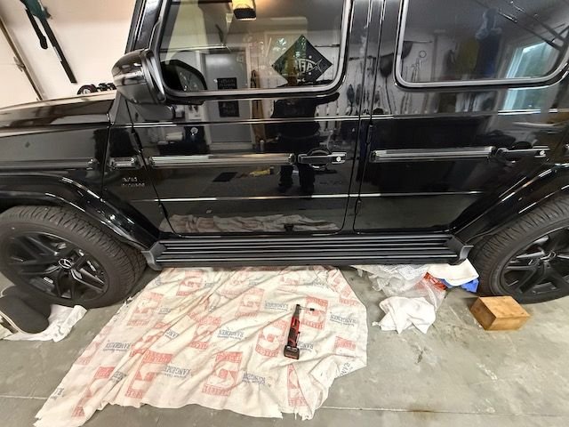

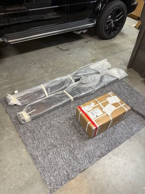

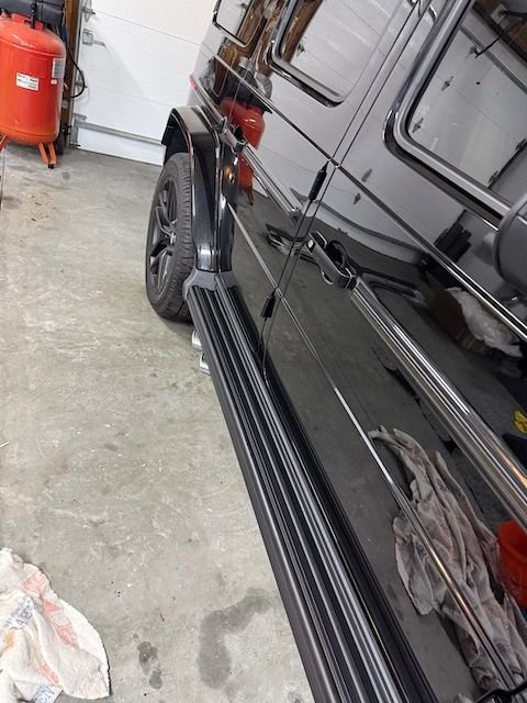

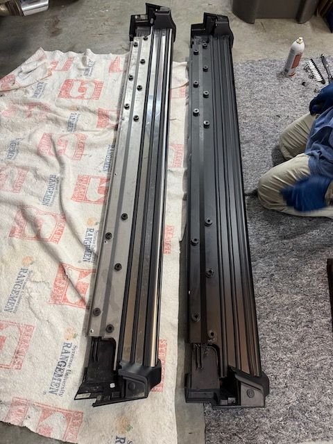

Took 5 months but the boards finally arrived....
Main delay was with the first seller I dealt with and, I am guessing, the tariffs.
I ordered them a day or so after I started this thread and the lead time was 5-6 weeks. After the 5th week with no tracking # I asked for a status and was told one of the boards had a scratch so they were waiting on a replacement, 2 more weeks go by another excuse, 2 more weeks....etc. I finally cancelled that order and purchased from another seller (I failed from the school of hard knocks). The second seller was amazing and the boards showed up in 2 weeks....I was amazed as they showed up so fast and the packaging was stellar.
Some photos below but in short they are decent quality and a 100% match of the OEM's. The kit comes with 2 boards, 4 end pieces, the lower trim that sits above the boards, all new hardware and a 2 page instruction booklet that has pictures stating to "snap" the end pieces on the boards.
I reused the OEM end pieces and hardware and did not touch the lower trim pieces.
Fitment was OK, I had to trim some of the inner plastic on the end pieces where the end pieces slide into the boards, but the end result looks OEM, same, if not better than the OEM ones on my G580.
While I can't speak for longevity I can say they were well worth the $750 shipped to my house for the set.

Originally Posted by Balthezor
Thank you for this. I might consider this down the road. How long did it take you to swap them?
about an hour and half, was just a bolt off then bolt on job. Unlike many other aftermarket products these actually lined up perfectly with existing holes and mounting points.

That will look nice and probably be more durable too, I had the front brush bar on my old G63 coated with Line-x "ultra" which delivered a similar finish, it held up perfectly over the 10 years we had the G, most of that in the Florida Keys sun.
The running boards disassemble very easily, the rubber strips slide off as do the end pieces.
Disassembly is as follows (for a 2025 G63 but assume 2019-2025 would be the same):
1: Remove plastic push pin fastener in the front fender well
2: Remove plastic push pin fastener and (1) trim bolt in rear fender wall
3: Remove all the bolts underneath running board, Leave the middle one in place until end so it doesn't fall on your head and you can control its removal, the boards aren't too heavy but are awkward, also wrap the muffler with something as not to scratch it.
The running board will come off as one complete assembly and now you can pull off the front and rear plastic pieces, then slide out the rubber strips (some have difficulty here but I think the newer the G the easier)
that's about all.
