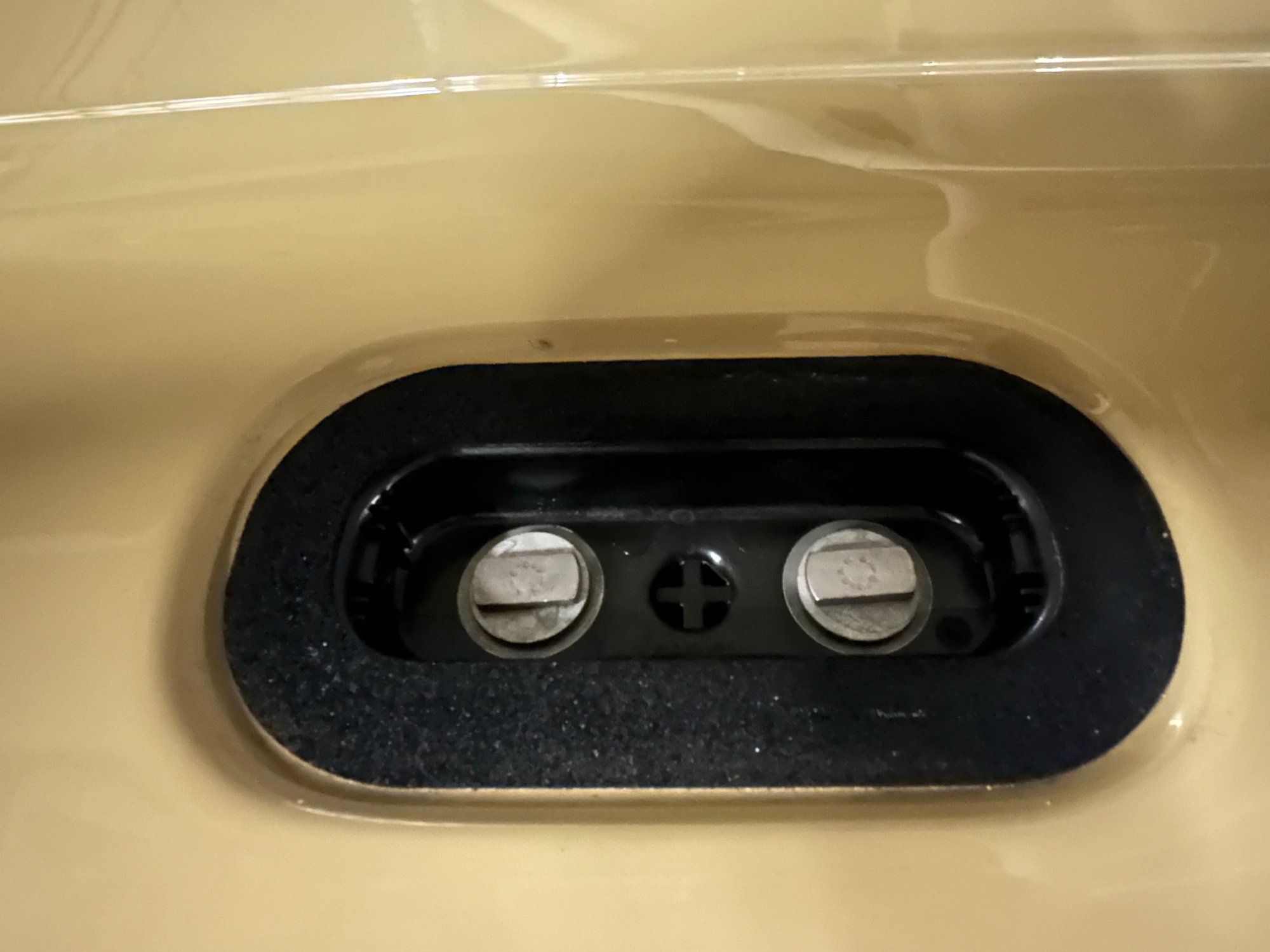

I went to install a Gobi Rack on my 25 G63 today only to find out that a critical part is missing … from the factory, it seems.
Photos tell the story.
My G (the tan G in the attached photo) is missing a metal bracket (as seen on the white G in the attached photos) that spans between the two visible “bolts”. That piece is where the rack’s brackets are supposed to mount.
Any thoughts, ideas or solutions welcome. Gobi told me I’m there first they’ve heard/seen this, which is never encouraging.
Thanks in advance.

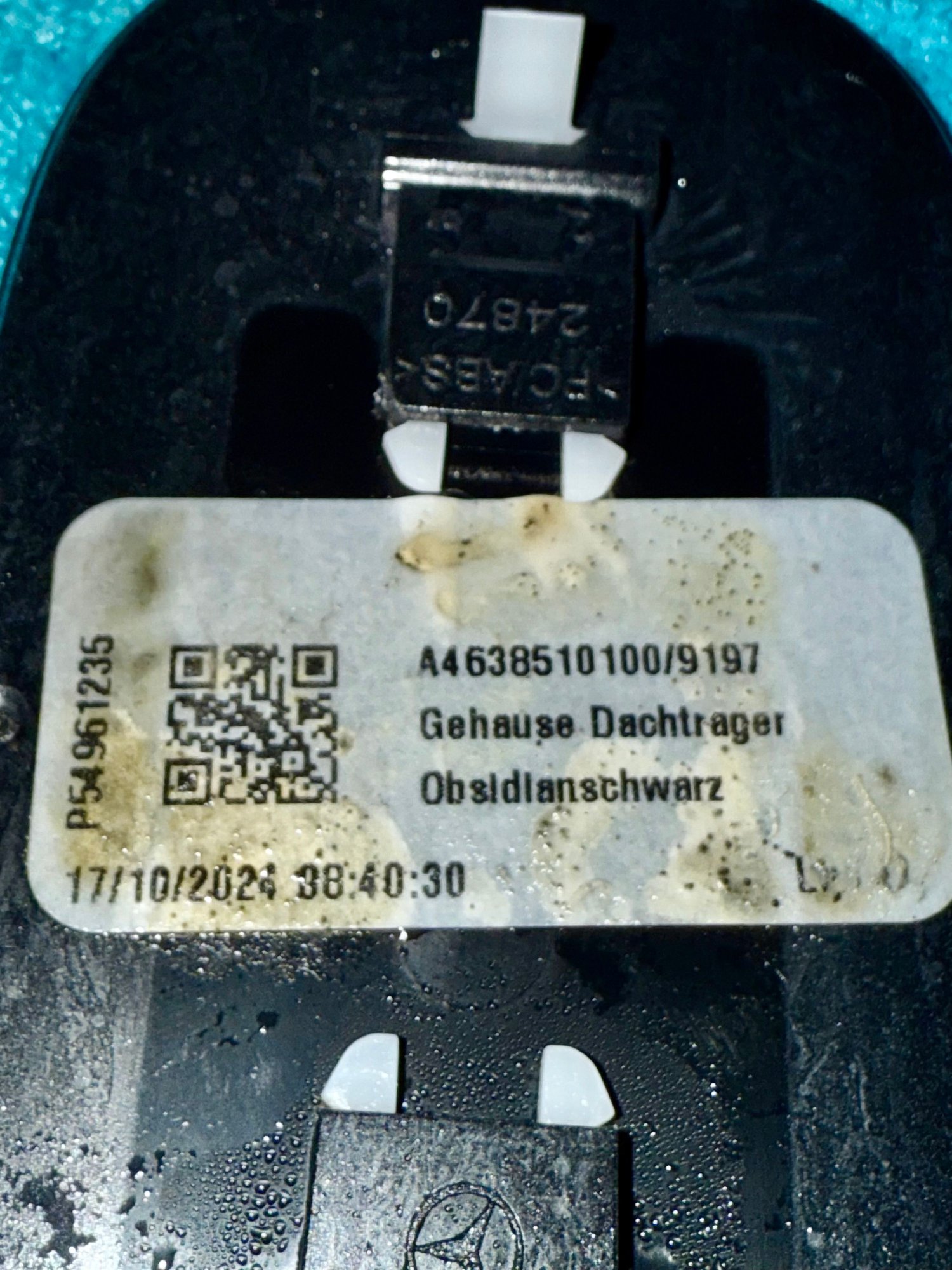

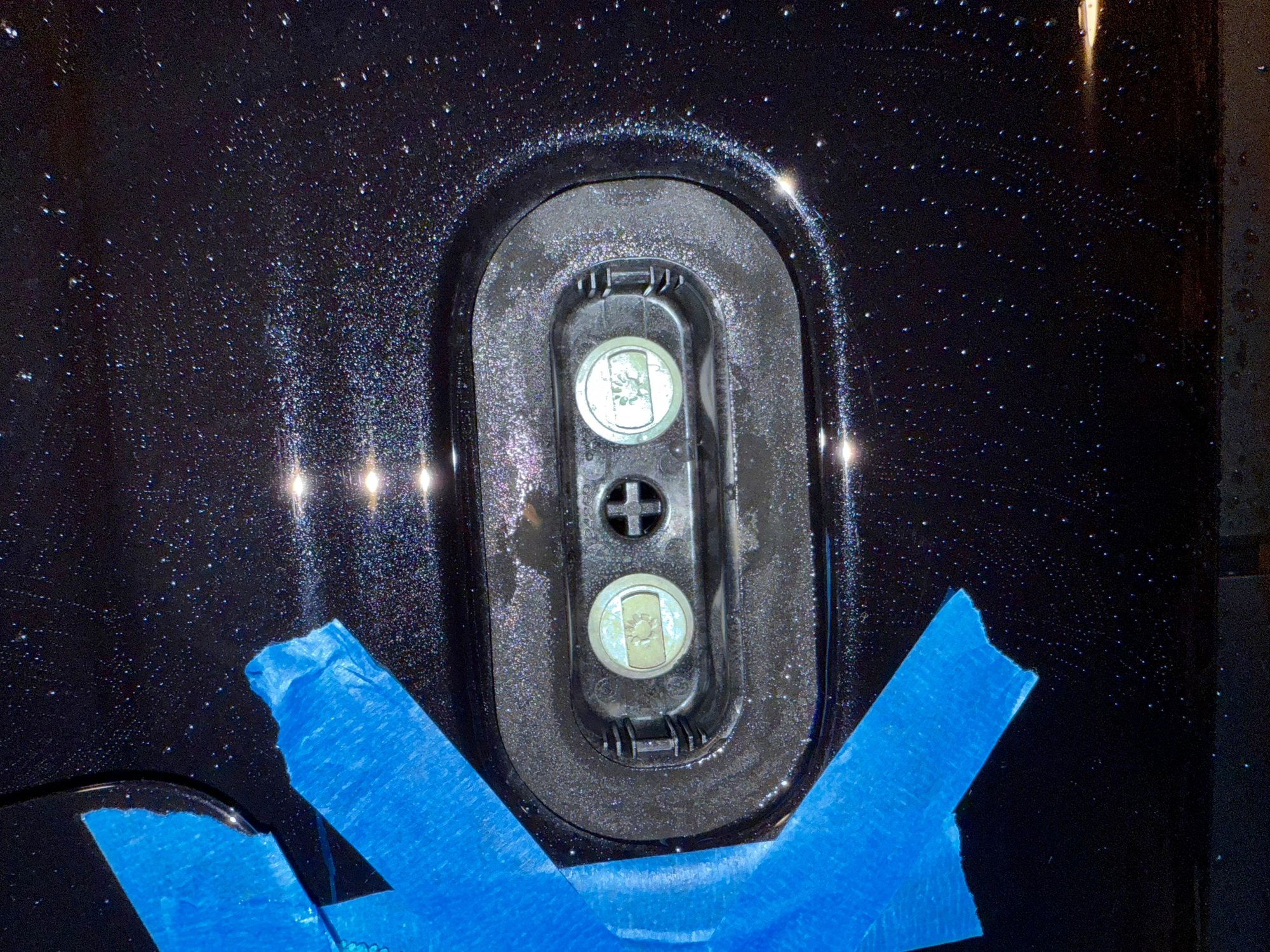

Well Well Well. A larger sample size and some non perf packs showing the hardware installed and we found our reason.
I included the part number for the hatch, IDK what for, could come in handy?
Reply 2

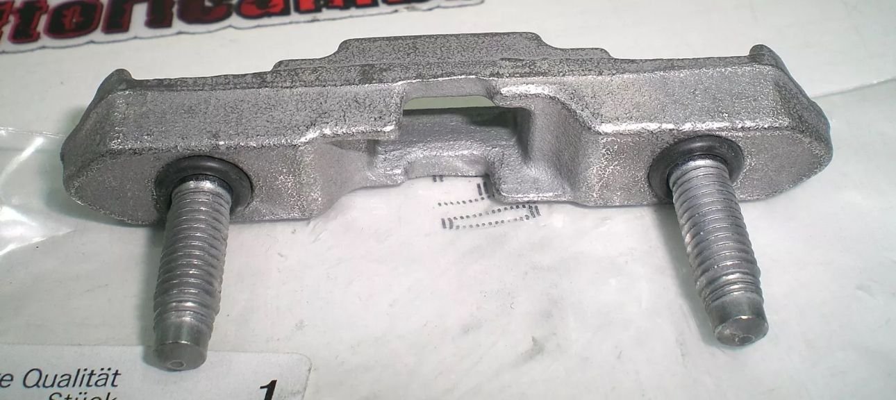

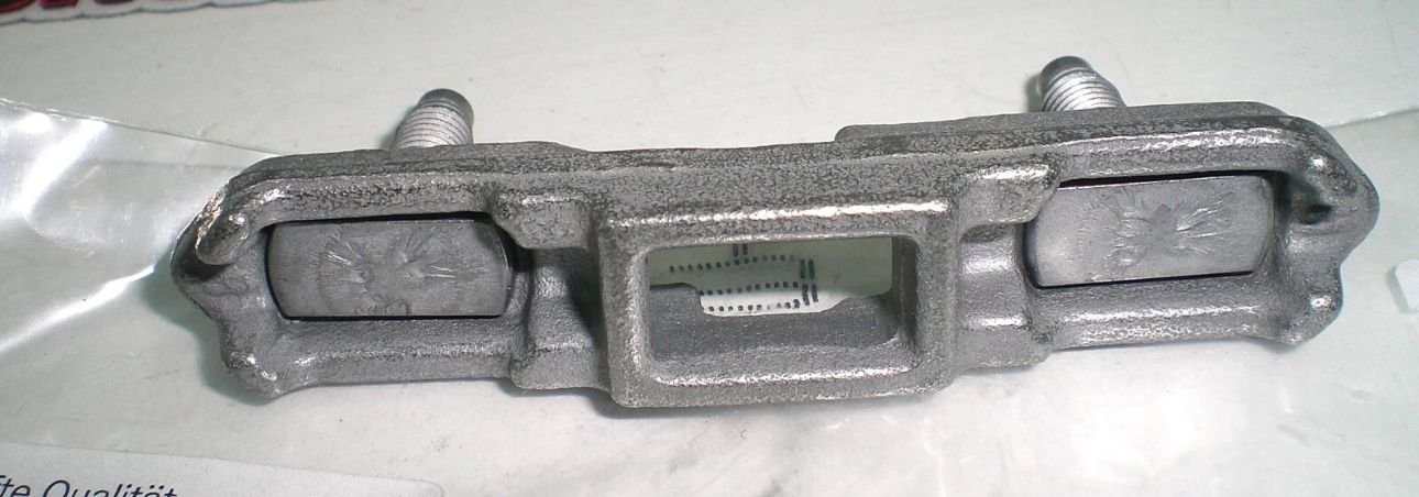

May 2, 2025 | 01:42 AM
For clarity, this is what we should have under our latch panels and what is required for roof rails, racks, etc.
Part Number: 246-650-00-55
Reply 1

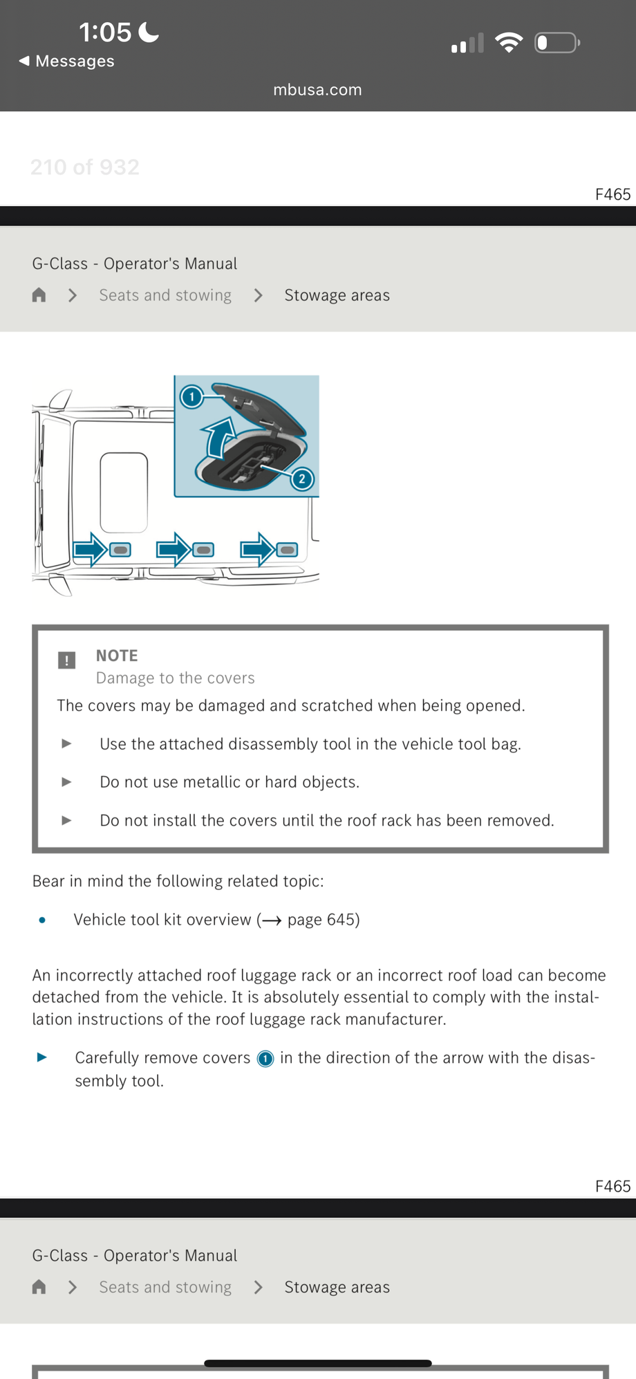

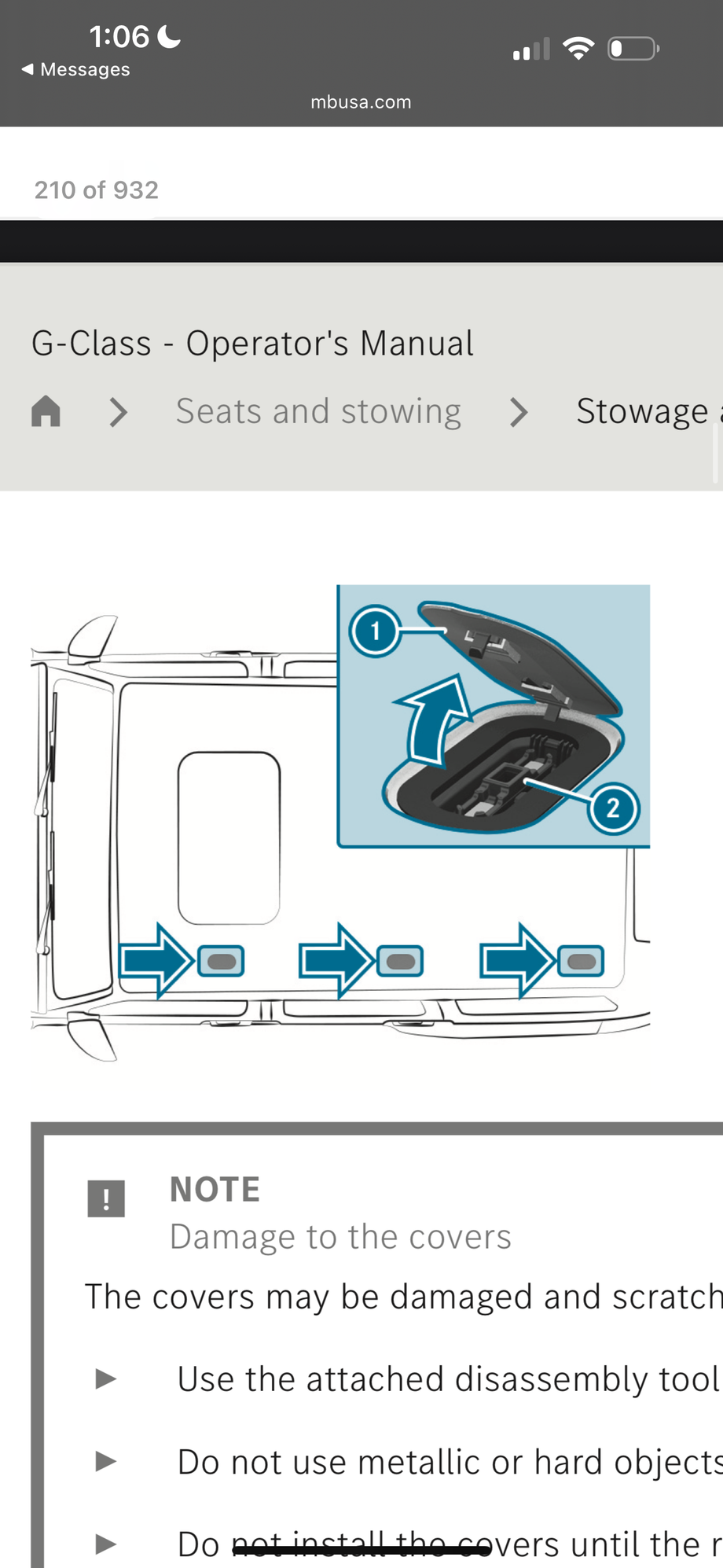

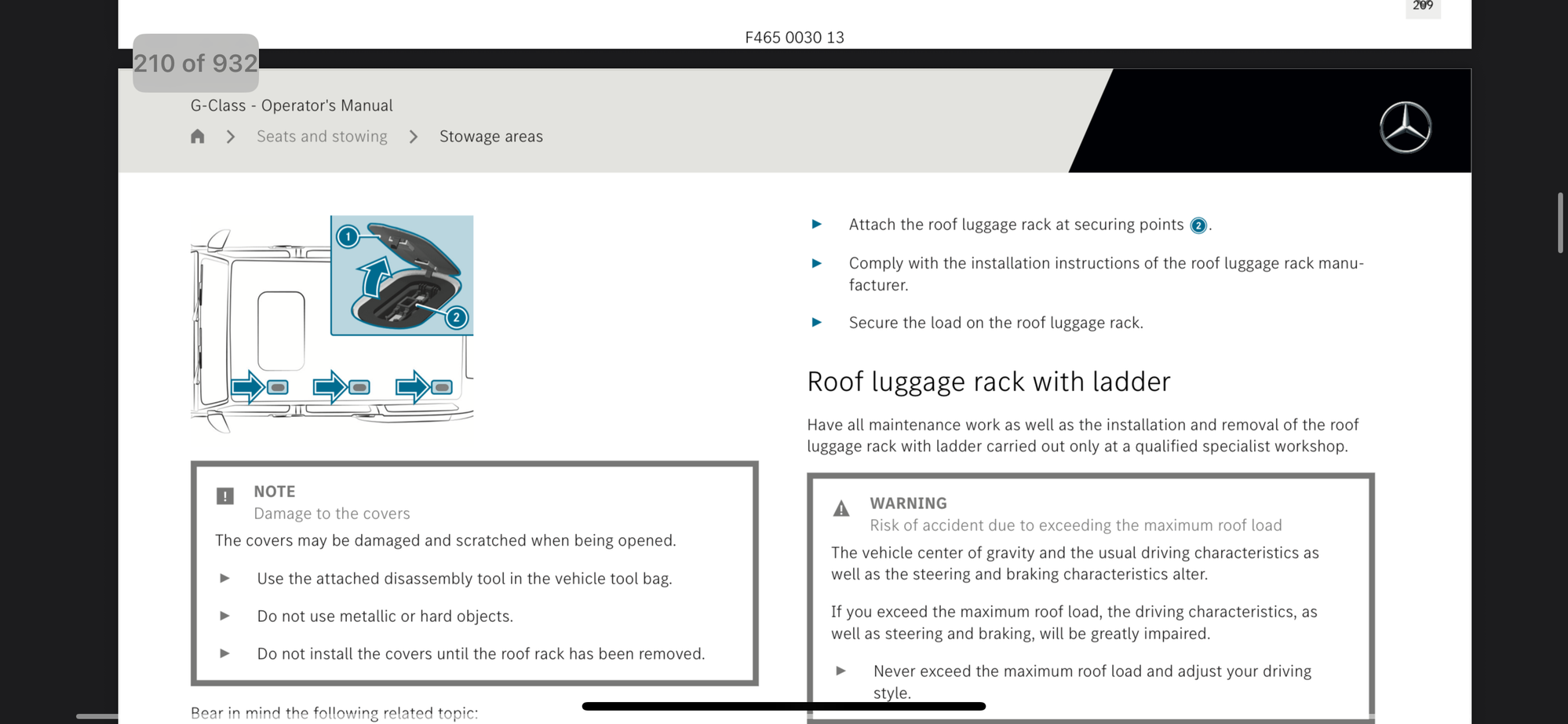

Further update on this. Upon reviewing the owner’s manual that came with the car, it seems the carrier brackets for roof racks are presumed to be in place from the factory. No mention of additional work, other than popping the roof cover plates. Photos below.
I am headed to my local dealer this week in hopes of securing an install of the brackets free of charge. Fingers crossed.

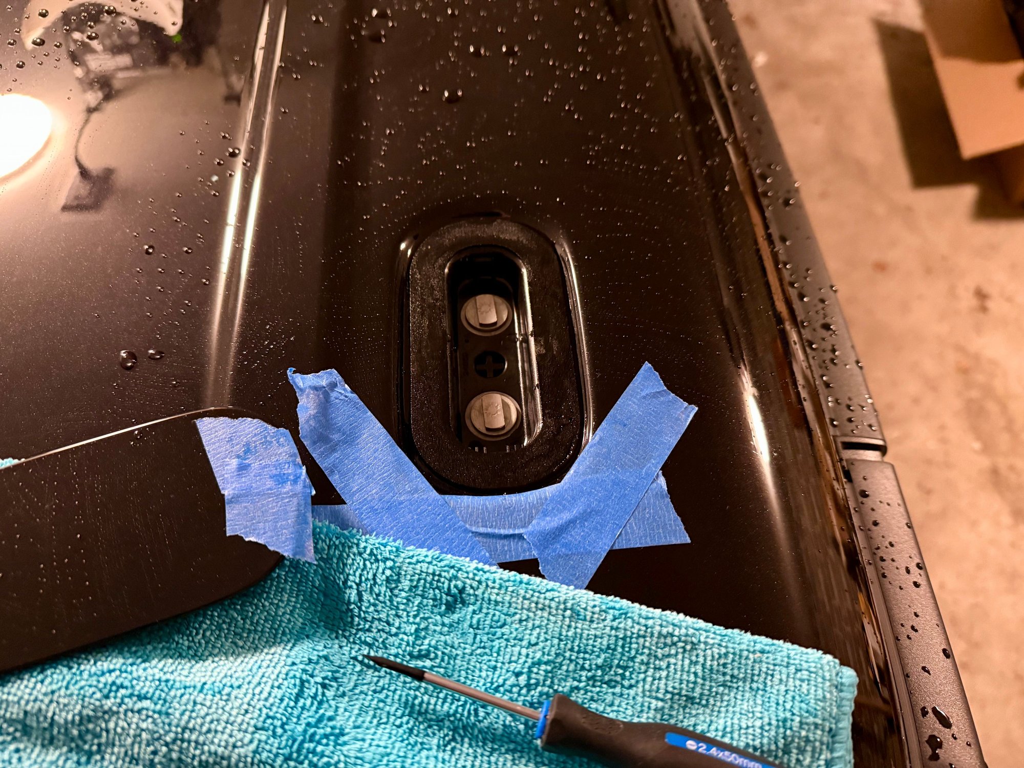

May 12, 2025 | 09:44 AM
Hi there. I just picked up my 2025 G550 and I can confirm I have the correct mounting hardware already installed for the roof rack. I took a quick peek, but can get photos too.
Reply 0

May 13, 2025 | 08:40 AM
Sure thing! Will get you a photo today after my meeting. I'm on it for you!
Quote: Thanks, Angus. A few photos would be great as I am getting the run around from my local dealer. It seems easy enough, but they’re not convinced.
Reply 0
May 13, 2025 | 08:57 AM
Here you go buddy:
Reply 1
