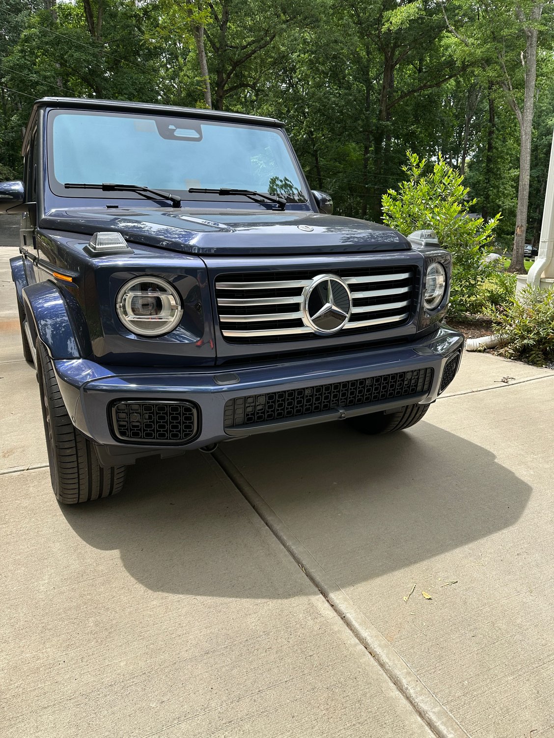

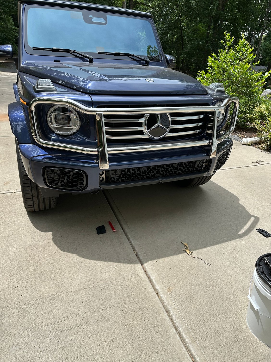

Removed my bulbar yesterday, I prefer the look. Super easy to do. Just pop open the two small plastic covers in the front bumper to reveal two 16mm bolts on each side. You can remove the bolts completely without the fear of the bullbat dropping down further or falling forward. Mercedes was ingenious in putting a little metal ledge below where the bolts are to prevent any mishaps and aide in reinstalling.
I put the bolts back in their respective holes tightly. Then I popped in the metal covers to close up the rubber grommet opening in the top of the bumper. I got them at Gwagen accessories online.
Whole process took maybe 15 minutes.

Thanks guys!!! I really think it's a cleaner better look and shows the front end design better without the bulbar in the way. By the way, that bullbar weighed a ton!!
