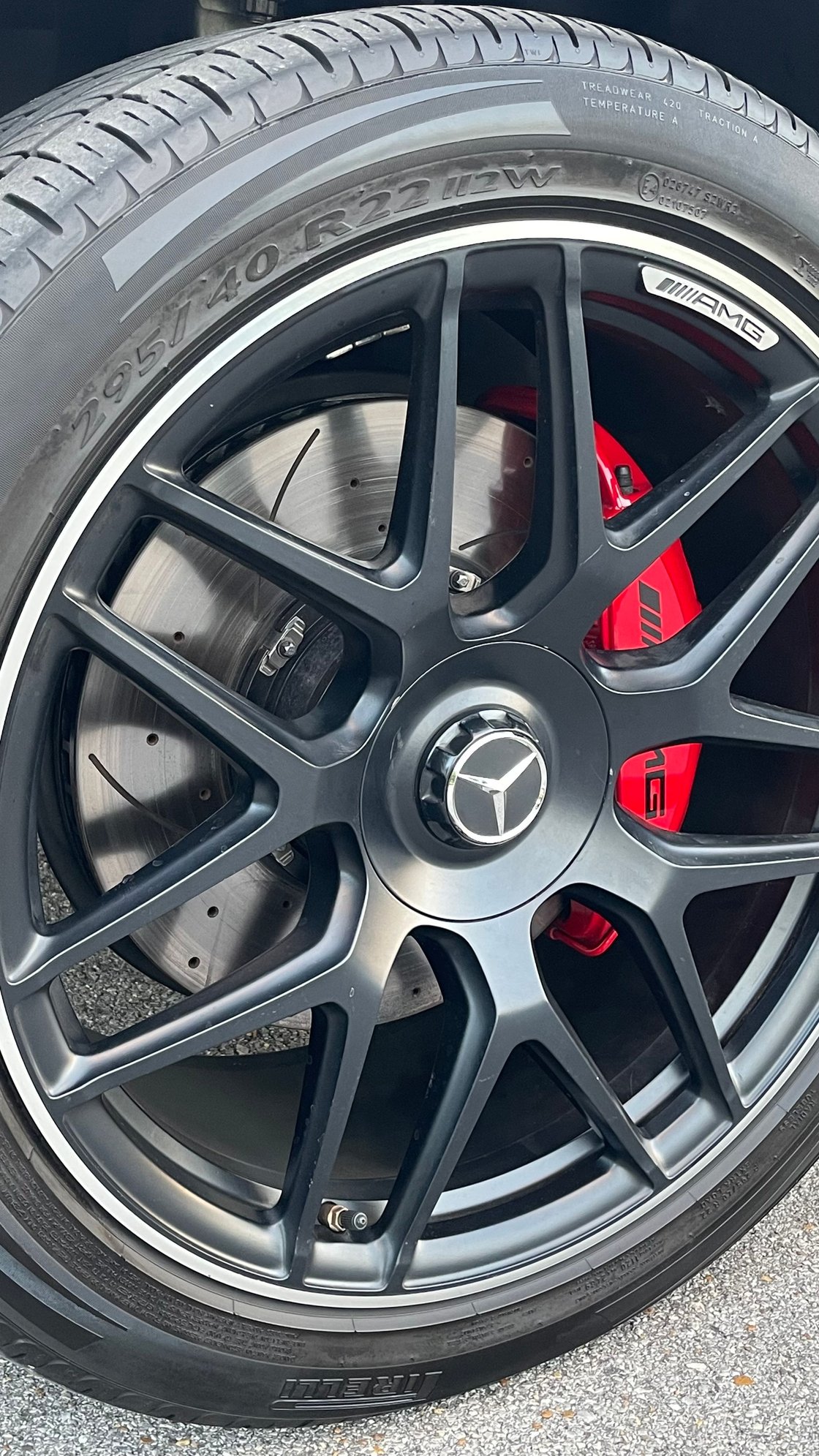

I have run the ZAC 2 piece rotors for year and half now. They have performed and held up well. The cost has gone up $200 front and $100 rear, but you can likely get a discount like I did buying all 4. I also used the Brake World pads. They also do well and dust while still
there is much butter than OE but don’t expect to keep wheels cleaner more than a few days.
https://www.zacmotorsport.com/produc...x2GnJ-VthonTyQ
https://www.zacmotorsport.com/produc...40649007595563
