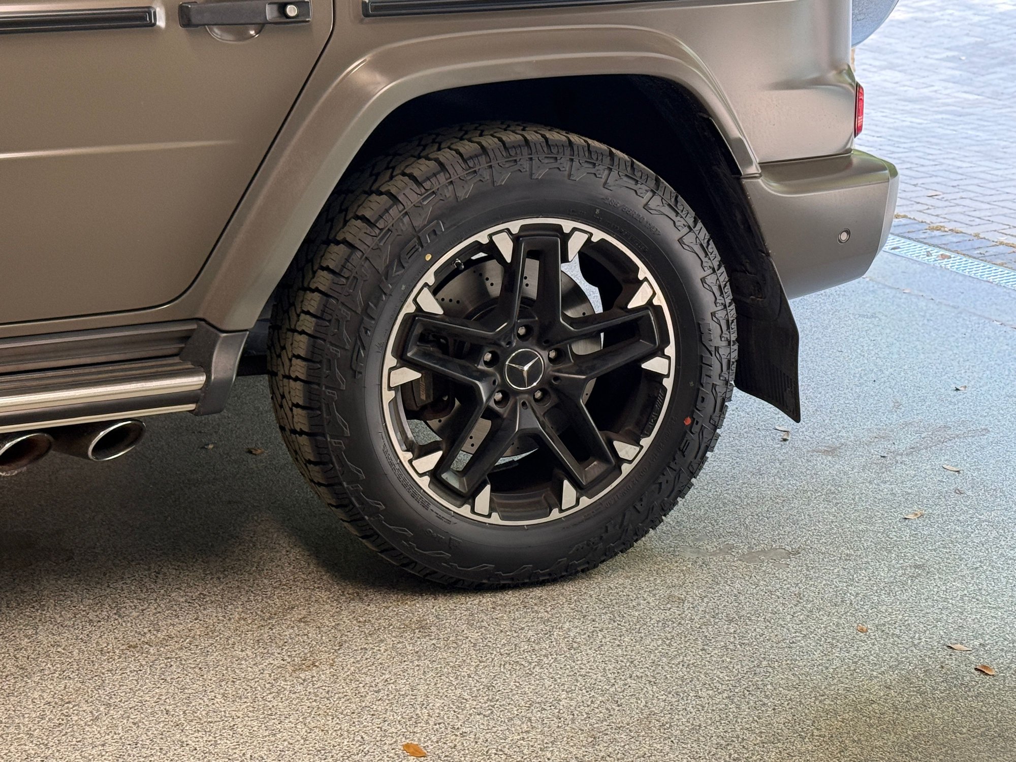

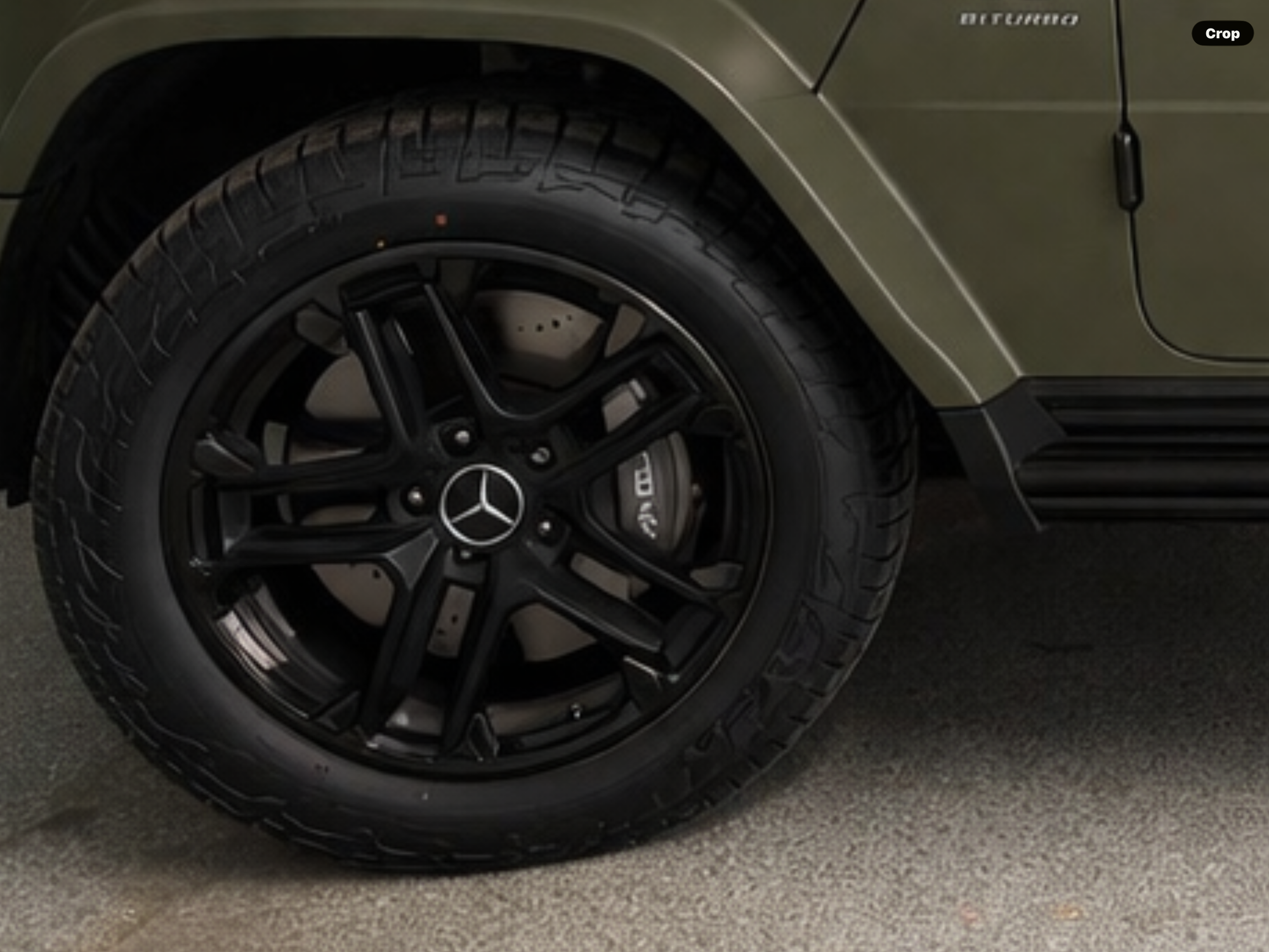

Below is the current OEM 20 inch wheel option for the G63 AMG (9.5J x 20 ET 35):

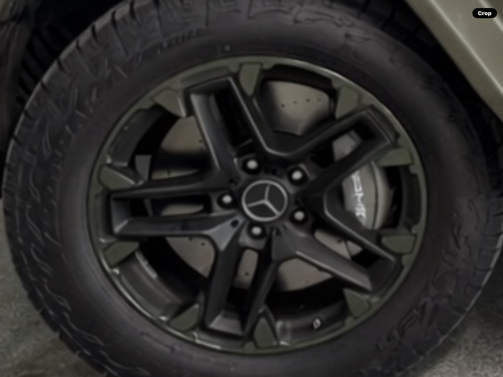

These are my current wheels on the G550 (8.5J x 20 ET32), and I would actually like to keep these and swap them out with the new rims.
Below are the wheels I ordered on the 2027 G63 AMG. I like these wheels, and I know there are some 22 inch all-terrain tire options I am looking into, but honestly I would love to swap these at delivery and keep my G550 wheels above. I just prefer the 20 inch wheels I have and would like to switch and keep them.

Thanks so much for your input, much appreciated. From what I have seen, most of the 20" wheels on the G63 AMG have the 9.5 inch width and greater than 32mm offset, so that is what confused me about the potential for 8.5 inch width and 32mm offset actually fitting and clearing the brake calipers. I am considering trading my new 22" wheels for my current 20" wheels at delivery, so I won't have any to trade or sell if this all works. But, if I end up keeping the 22" wheels and getting another set of 20" wheels, I will keep you in mind for my set.

Thank you for sharing... Yes, those are the trail package 20" wheels that I posted above, which have the 9.5" width and +35mm offset, so I know those will fit on the G63 AMG. I was trying to figure out if the 20" AMG wheels for the G550 that are 8.5" wide with +32mm offset would clear the calipers and fit.
