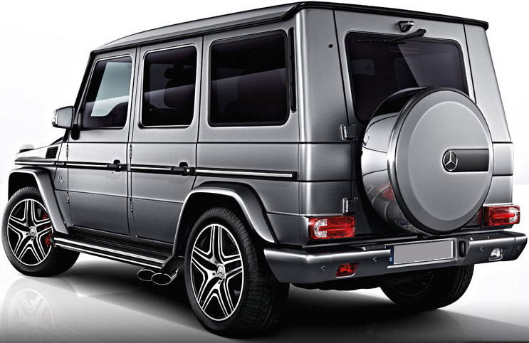

Hello guys, just got my G63 AMG and I noticed the spare wheel is sitting a bit too low vs what I've seen often on other cars
Is there a different setting I can have by removing the wheel and moving the bracket?
In case, can anyone send me instructions to do it?
Many thanks for the help,
Max
P.s. This is how my car looks right now
This is how I'd like it to be:

They are the same, accept the photo is taken from a different angle. I've owned 5 G-wagons and the spare wheel mounting position has been exactly the same on all 5.

Solved the mistery myself!
They are not the same, I removed the spare wheel, removed the bracket and you can actually turn the bracket in a slightly different position to let the wheel sit a bit higher (as in picture #2)
I've owned 2 Gs myself and the first one had the wheel in "high" position while this one was in "low" position...hence my question!
You can see by yourself, easy mod, took me 20 mins!
