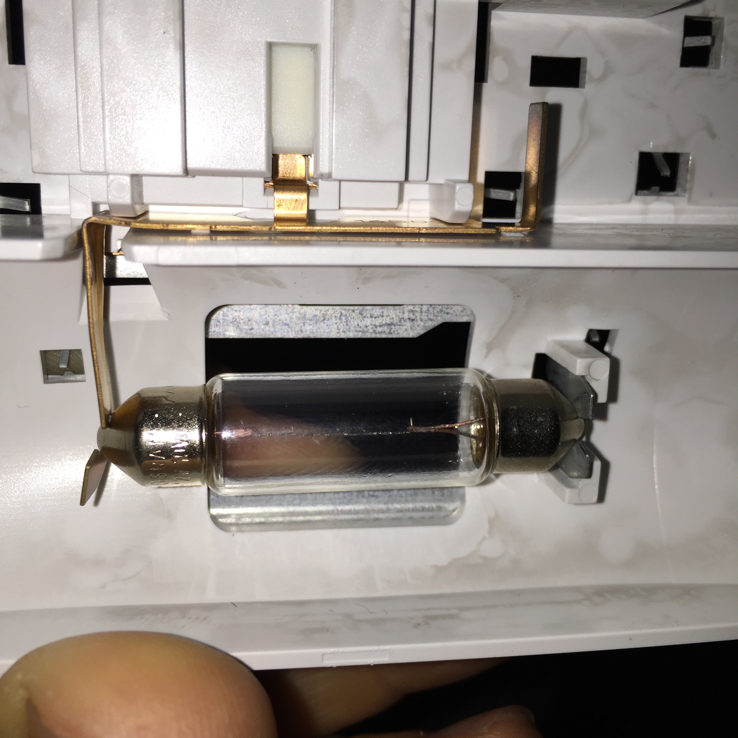

Hi, I've swapped out all of the interior bulbs to LED (CANBUS) in my 2009 G55, but for some reason can't get the dome light to work with an LED bulb above the rear seats. It appears to be the same bulb as the front dome light, but nothing I've tried works. The map lights are fine with LED.
Does anyone know the right LED bulb to use for this dome and where to buy it? Is there some trick I need to do (i.e. turning off the car and back on in some way...I think I tried this but it didn't work).
Thanks-
Rodger

Try to turn around the LED bulb see if that helps...

Thanks for the response. I've tried turning it around to switch the polarity but that didn't seem to work either. Any other suggestions?

You need to add a resistor inline (between the power going into the unit and to one of the prongs on the festoon bulb). Just went thru the same ordeal on my 2011...now I got LED bulb all working in the interior. The reason why it needs the resistor (even being CANBUS error free) is that when you have a regular bulb in there you'll notice it gradually goes to full output (ie - dimmer) and most auto LED bulbs can't do that.
I bought all my bulb from these guys and they are the ones that pointed me the right way....
https://www.superbrightleds.com/more...g-fix/191/832/

I actually didn't end up needing a resistor. The bulbs I bought from superbrightleds.com worked fine just plugging them in...dimming and everything. Not sure how, but they work. I recommend that site, all of their bulbs have worked great. Just make sure you buy the CANBUS option.

When I tried the CAN BUS for my '10, they worked wll except for the dome light over the rear seats. It comes on quickly with open door but then goes out, It will not work in conjunction with the rear interior light switch in the front.
Scratching my head on why the same bulb works in the from dome light but not in the rear light dome light.

I had that same exact problem...everything worked but the rear dome, but then I got a new bulb from SBLeds and it works perfect...no resistor.
I'd give their bulb a try and see if it works for you too. I have an 09 G55, so it's most likely the exact same thing inside.
