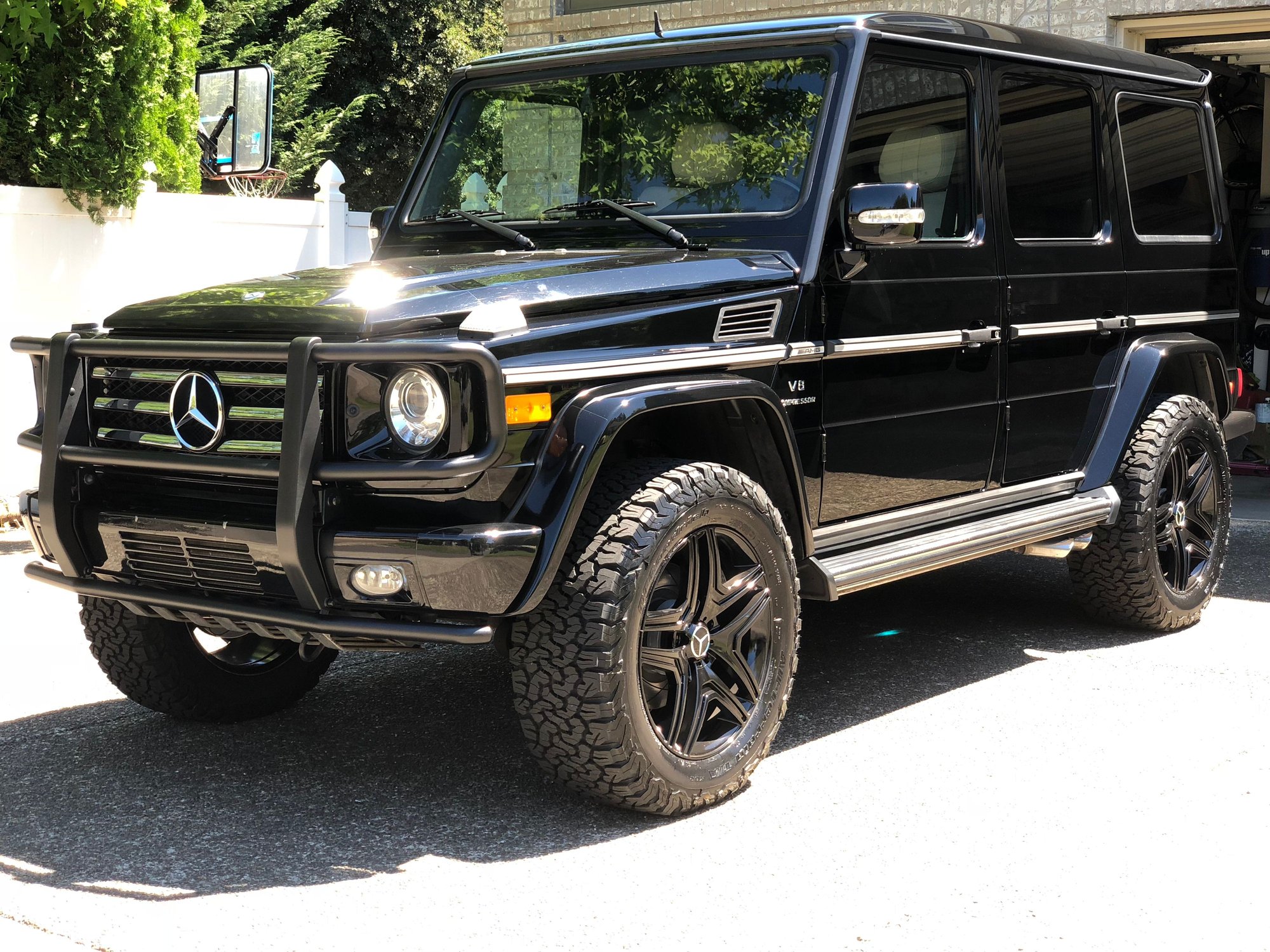

Driving with 33’s and lift
i was wondering what others are experiencing when going to larger tires and lift. I did the Fox shocks and Thor springs and went to 33’ tires, also got fix steering strut. It rides a lot smoother but has more play and doesn’t feel as stable, also the rig feels like it’s working way harder... does the transmission need to relearn? Seems the transmission shifts different.
Just St wanted to get an idea of what everyone else is experiencing. I have a 2011 G55

Hello,

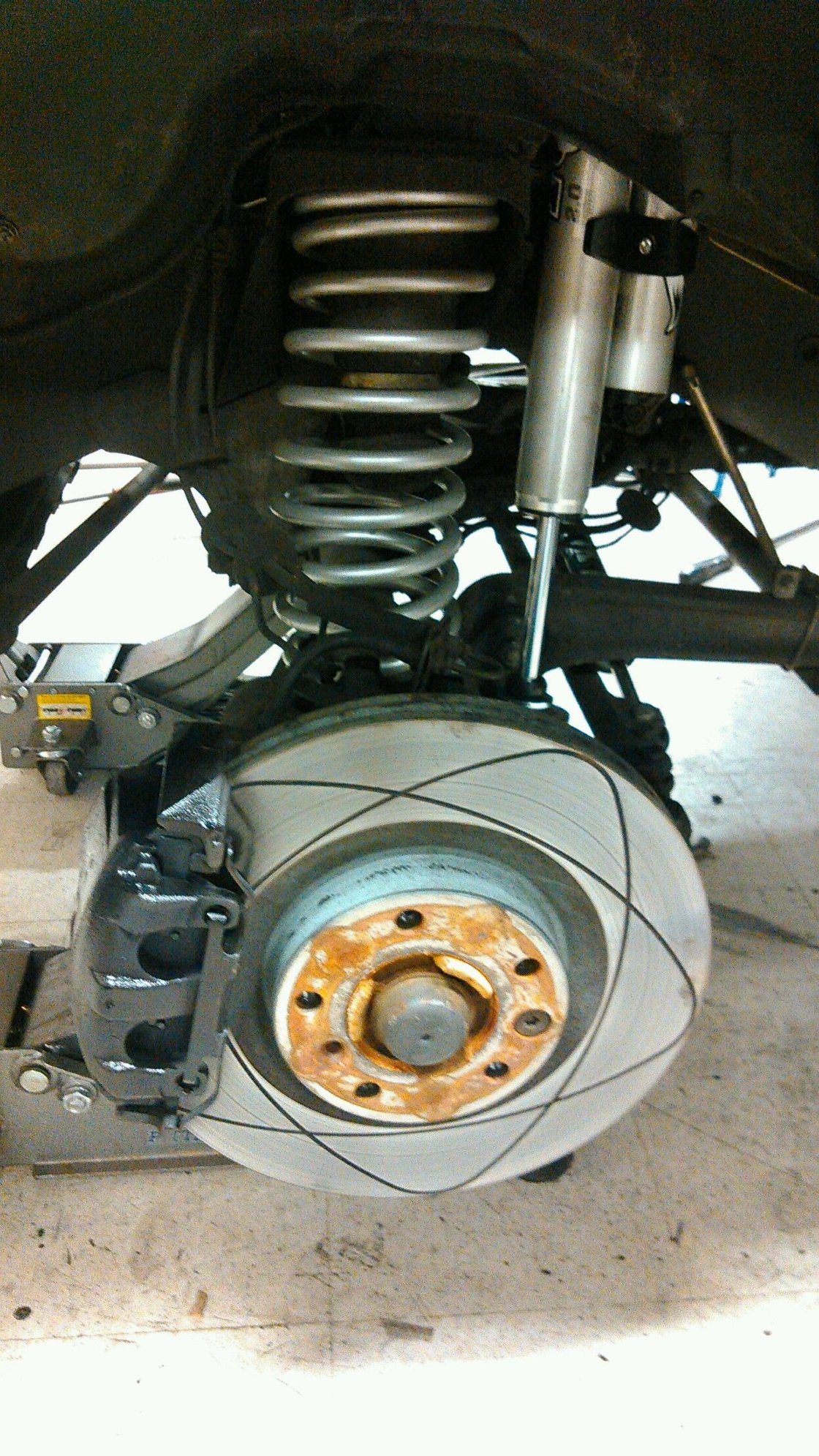

Your G55 looks great! Our G63 with Ohlins + Thor springs ride amazing. The steering is still a little soft but it much better than stock after we installed the 4x4 stabilizer. On the G63, the transmission shift normal, if anything we feel like it takes longer to shift when we gas it...lol
We noticed you didn't change out the brake lines, with your lift, it didn't stretch out the OEM lines?

the Fox/Thor kits do not require brake line changes. My mechanic who works on G wagons all the time ( has a few of his own too) said they are fine and no need to change.

I have 35" tires on mine. I run all Kings Shocks which include King Steering Stabilizer which helps a good amount. I will install new steering bars to tighten it up a bit. The trans does feel like it should be reprogramed with adjusted shift points, its due to the larger rolling diameter. And your tech was right, no need for extended line with that size lift.
