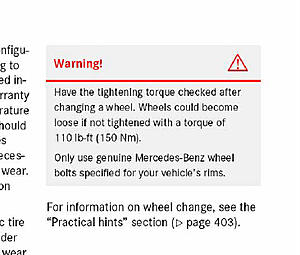

It's best to check your manual, but the last seven MBs I've owned have called for 110 ft-lbs/150 Nm.

The only MB I've ever owned that called for 150 nm is the GL.
The W123, W124, and W210 all required 110 nm (80 ft lb).
The W211 requires 130 nm (96 ft lb).
Never had an S-class, which must be what you've had.
Old Sep 26, 2007 | 07:25 PM
whoover's Avatar
Joined: Mar 2006
Posts: 4,278
Likes: 377
From: San Jose area
'19 E63S sedan
Yep, different models seem to take different torques. It's always good to check the book. But I still bet the original problem here is that someone forgot to torque at all.
