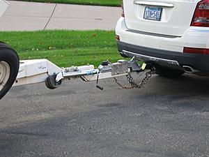

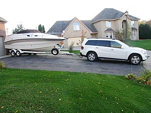

Past summer we were trying to decide between a Yukon XL and GL 320 CDi.. there were many posts on this site which cautioned about towing anything heavy with GL.. I was concnerned but went ahead and bought the GL anyways. Well this morning I finally had the opprtunity to tow my boat, total weight 7000 lbs , maybe a bit more.. It was absolutely a pleasure towing with GL 320CDI.. As a matter of fact, I think it tows even better than Yukon XL (we have owned Suburban and Yukons for 10 years). Under that "refined" and "sophisticated" personality is an absolute beast. Lots of torque, real smooth riding (love the air suspension). Towed our boat 200 plus miles ,,our route was a mix of small towns, freeways and highways. Average gas mileage per the on board computer 13.8 Mpg , same route without boat we get 20.8 mpg,, so not bad at all.. Infact 13.8 mpg is same as Yukon Xl on a good day.
Those wondering if this SUV is strong enough to tow, we were doing 75mph on freeway with engine rpms at 2100.. so plenty of spare power and torque. I have attached couple of pics of my set up . Our trailer has hydraulic surge breaks.

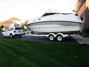

I have pulled a +/- 5000 lb 22 ft. center console boat with a 07 ML 320 CDI and an 08 GL 320 CDI. The torque is incredible. I have passed Suburbans and Expeditions pulling similiar sized boats on long steep hills going 75 MPH and they pass me later on the flat road as I maintain speed and they cant on the hills. I simply love the power and economy of the GL 320. I average about 12 MPG pulling the boat as it has a very high T-top that has significant drag. I pulled the same rig with a V8 Explorer that got 8 MPG. I have a tandem axle trailer with surge disc brakes on all 4 wheels. No problems stopping at all. Very comfortable ride due to the air ride suspension.

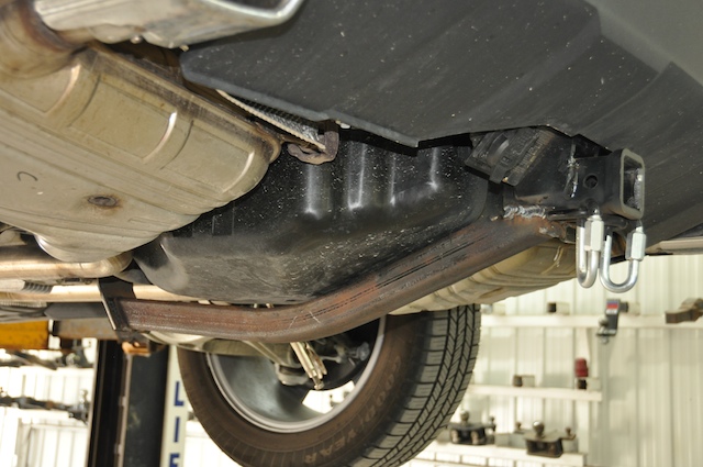

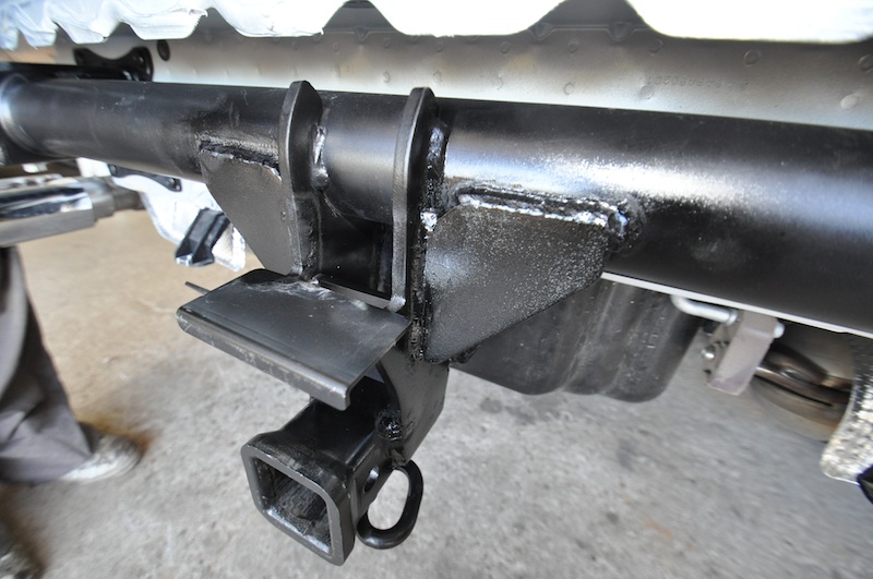

No, the GL's hitch cannot take a 700-800 lb load. It is placarded to a limit of 600 lbs and believe me, they mean it.
You'll have to reinforce the hitch to carry that tongue weight. Get an experienced custom hitch company (hard to find these days). The load must be spread out to avoid overstressing the bottom pan of the unibody, and to make up for the very wimpy welded connections between the receiver box and the main tube.
Here's how we did it... YMMV

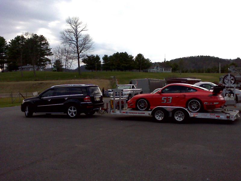

I'm taking delivery of my GL today....I've seen some pics on this forum of pretty big loads pulled with these rigs. I'd like to do the same but I'm not sure. My old truck may get pressed back into service.
Based on what I've learned so far, the GLs hitch is not hooked up to an actual frame, but rather the unibody. This rig looks very capable on paper, but may not be as capable as a domestic SUV due to its design. Making major modifications to the factory hitch assembly seems like a liability disaster.
With any race car trailer, getting weight off the tongue is difficult. Your tools,tires,accessories are always up front and enclosed trailers are worse.
Does MB even recommend a distribution hitch regardless of weight? The weight distribution receiver spreads the load further forward on the tow vehicle, but puts a counter-clockwise/upward torsional load on the hitch, receiver tube, and vehicle mount location.
Iridium has an interesting hitch idea but I'm not sure I'm ready to take responsiblity for re-engineering this vehicle. What have others done?? Please keep the discussion going....

Removing tongue weight by redistributing the load can be very dangerous. Tongue weight must remain in a safe range or the trailer can become unstable and/or sway out of control. Generally experts in the US recommend 8-12% tongue weight.
Mercedes has apparently designed their hitch for 8%, because the hitch is placarded for 7500 lbs total trailer weight and 600 lbs of tongue weight (8%). You will find that 600 lbs of tongue weight changes the steering characteristics of the vehicle dramatically (and I would say unsafely) without a weight distributing hitch.
STP, the hitch recall did not apply to 2009 and later model year GLs, but the welds to the main (round) tube are still inadequate in my opinion. Take a look at them yourself and see what you think.

Iridium, how did you attach the front bar in your modification? I'd like to know more..

After having gotten this new acquisition in our driveway and looked closer at the hitch, I feel much better. The recall repairs were done quite well and was definitely not 'joe bob with a tig and a spool of wire'. This hitch is every bit as reinforced as the class IV hitch on the old truck.
Bearing in mind, I'm not doing cross country (or even regional) trips with this set up. Our Foretravel pusher pulls the trailer to the farther locations. This will just be for making day trips to local tracks.
My plan right now is to get the trailer over to the scales to confirm tongue weight. If below 650lbs, I won't worry about it. If over 675, then I'll think about how I could move contents around. Then I'll post pics of the GL pulling a 28' car trailer...
On the weight distribution bars, I still plan to use them (not heavily cranked up) to eliminate the 'hobby horse' fore/aft movement when going over the 'whoops'. The suspension will get a little workout.

Well...it will take more than reinforcement to carry this trailer. I had the trailer fully weighed yesterday and I knew it would be heavy in the front but not this heavy... 7200# total and 5980# on the axle>> #1220 on the tongue. Its even near the limit for the class 5 on the truck.
The day before, I had the WD hitch apart and set it up for the GL. I started to set the trailer down on the hitch to check level and GL and the rear end kept sinking and sinking, so I stopped and lifted the weight back off. I figured then it was too heavy, but didn't know how much until yesterday.
