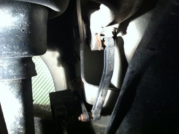

on each corner there are leveling rods. The easiest to find are the front ones.
Tbese are located in the wheel well above the tire. They are plastic arms that you can move with your hand. Once you locate them you can move them and see what they look like and find the ones in the rear.

If you can see a clear cutoff, your projectors are better than mine were. They get burned from the UV given off by HID bulbs and mine were pretty bad. I'm surprised OEM parts performed as badly as they did, but they were ~9 years old with 180Kish miles at that point. I didn't even realize I had the "turn with the steering wheel" feature because the output was so bad with the original projectors.
Unfortunately, I don't know of a way to raise them. Mine self-level, so I assume even if you found a way to tilt the housing upward, the projector would probably cancel it out and still point at the same angle to the road but I'm not sure.

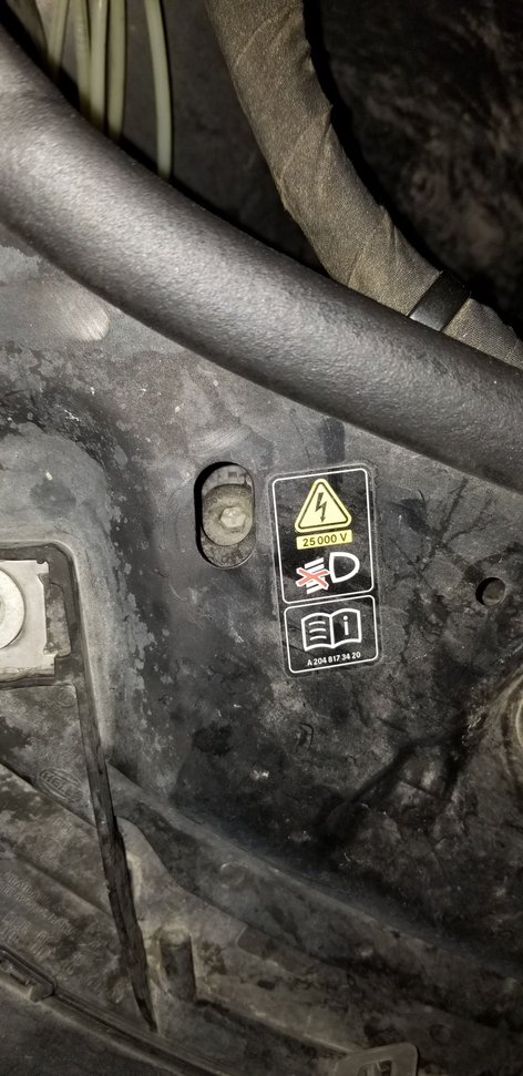

Instructions for bulb height adjustment were in my manual. There is a plastic Philips screw on top of the housing that will adjust the height. You have to do it with the light shining on a surface about 25ft away to see the mountain peak that the passenger side bulb makes.
https://www.manualslib.com/manual/57...age=511#manual
I adjusted mine for a long family road trip for the holidays. Now if I can just figure out how to replace my HID bulbs with new ones, I'll be in business.

OMG I have the same thing under my hood! Thanks a lot!!! I’ll do it first thing in the morning.
Replacing HID shouldn’t be too hard, don’t overexaggerate it, most stuff is super easy. I was checking the under the hood last week and saw the lid that grants access to the bulbs. There are some details that you should follow and the rest is not more than a 15 min job.
thanks a lot!!
