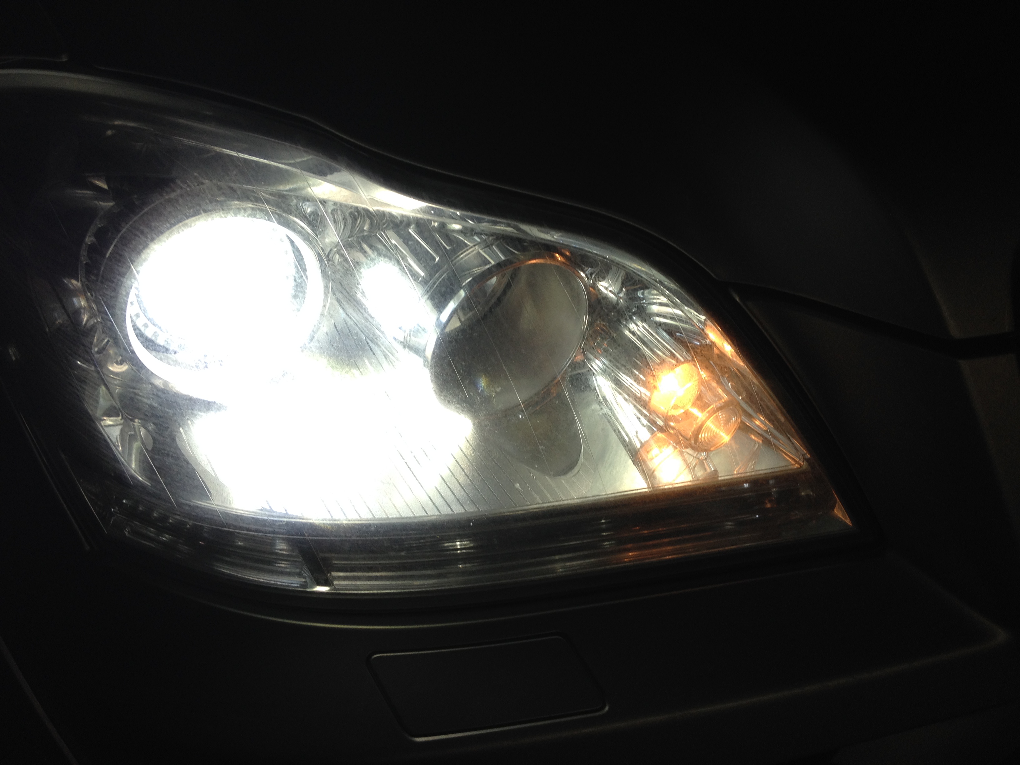

Hi all
Late 2011 GL500 and Im wanting to replace the awful yellow sidelight W5W bulbs with a white LED type to try and match the Xenon white colour from the dipped beam but here in the UK all sellers on eBay etc. seem to think their LED options will trigger an error message on the dash, anyone fitted a nice white (without being over bright) LED in this fitting and have no error messages please?
My GL has LED rear lights and LED puddle lights under the mirrors so why on earth did MB fit these yellow halogen bulbs, oh I know, because the X166 was due out a year later. Looks horrible.

sorry, I forgot to take pictures but I did get the LED's From AZN,
I got:
Low Beam D1S 6000k Morimoto
Parking Lamp W5W LED 6000k
Side Marker WY5W AMBER LED
Turn Signal 3457A AMBER LED
Back Up P21W LED White
So far they are great! I will try to remember to snap a few pictures

I have a 2011 GL550, The Low Beam D1S 6000k Morimoto is whiter with a Very Slight Hint Of Blue its Really Brighter/Whiter Compared to my Factory bulb..
