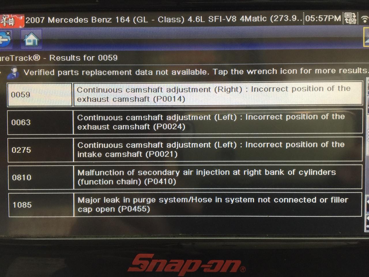

It started last month. Suddenly the truck wont start or twisting the key will just make it click and nothing would happen. Sometimes it will just go in slow crank.
Battery fully charged so no issues there. Happens randomly. Tried both keys with similar results. My auto shop ran the tool and it showed a fault with intake sensor position. They found that one of the flap thing was broken. I got intake manifold replaced. 2 days later same thing. No error codes what so ever. It would start all day and suddenly it wont. They ran all kinds of tests and concluded to be fuel pump this time. Fuel pumps and filter were replaced. Ran fine for a week and since this morning same issue.
Interestingly, once it starts, you can go 1000 miles. 2700 in repairs has lead to nothing. Wondering if anyone has experienced this and what was done to fix it. It is 2007 450 and has 65000 miles ( I know)

They need to use star to diagnose this those two repairs had nothing to do with your situation obviously this is one of thise times it woerh taking it to a Mercedes-Benz indy knowledgeable tech or the dealer its self

as what gl450 said, those issues that the dealer fixed had nothing to do with your GL cranking over. Since it is not your battery, it can be your starter. I have also read that it can also be the positive lead to the starter which is more unlikely than the starter. But it is unusual for a truck with 65000 mile to have the starter go.
If it happens again, you can crawl under the passenger side with a hammer and hit the starter. The point of doing this is to knock the brushes in your starter clean.(well, not really clean but just enough to get it started. If this works, you will probably need to pull your starter and replace or rebuild it.
