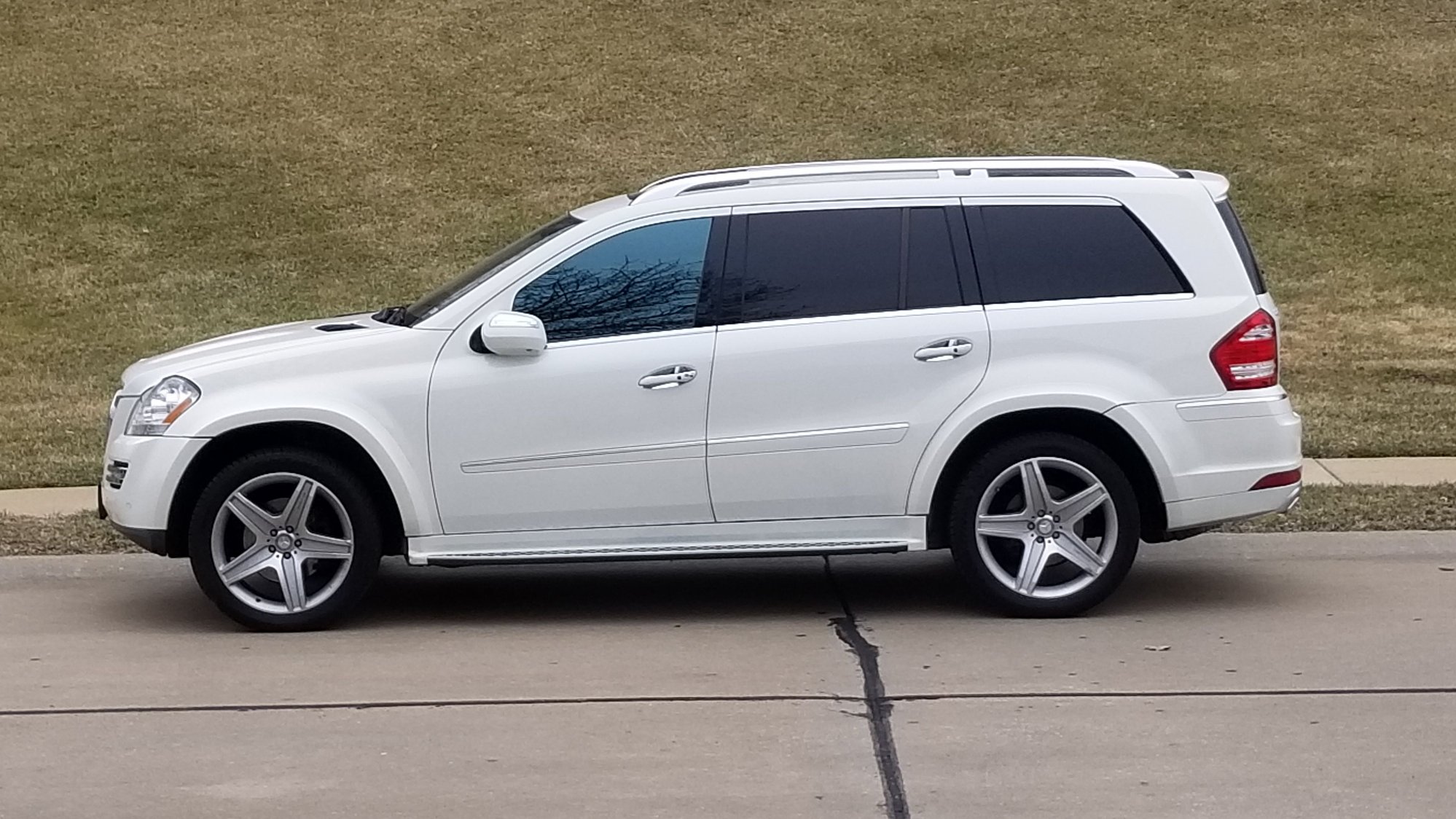

Let me know what you all think. All comments are welcome.
Did about a full day of prep work with the step sides and rear bumper valance (currently black).
Due to the hard plastic being uneven and potential for orange peel. I sanded and sanded. Then used a Tec cloth to get off dust particles.
Tapped all areas for overspray.
1) Sprayed 3 coats of plastic adhesion promoter.
2) Sprayed 3 coats of primer filler and sanded when dry. They became somewhat smooth.
3) I sprayed 3 coats of primer sealer.
4) I bought 3 cans of OEM 650 Mercedes spray paint on ebay. I sprayed 4 coats of paint.
5) I sprayed 4 coats of Spraymax 3680061 2K clearcoat. *Warning* this must be sprayed in a ventilated area wearing a respirator! If you breath this in you have a strong possibility of expiring. Also, one opened you have 2 hours tops to use it.
I used all rattle spray paint cans for this project and know minimal about painting vehicles. It turned out extremely well.

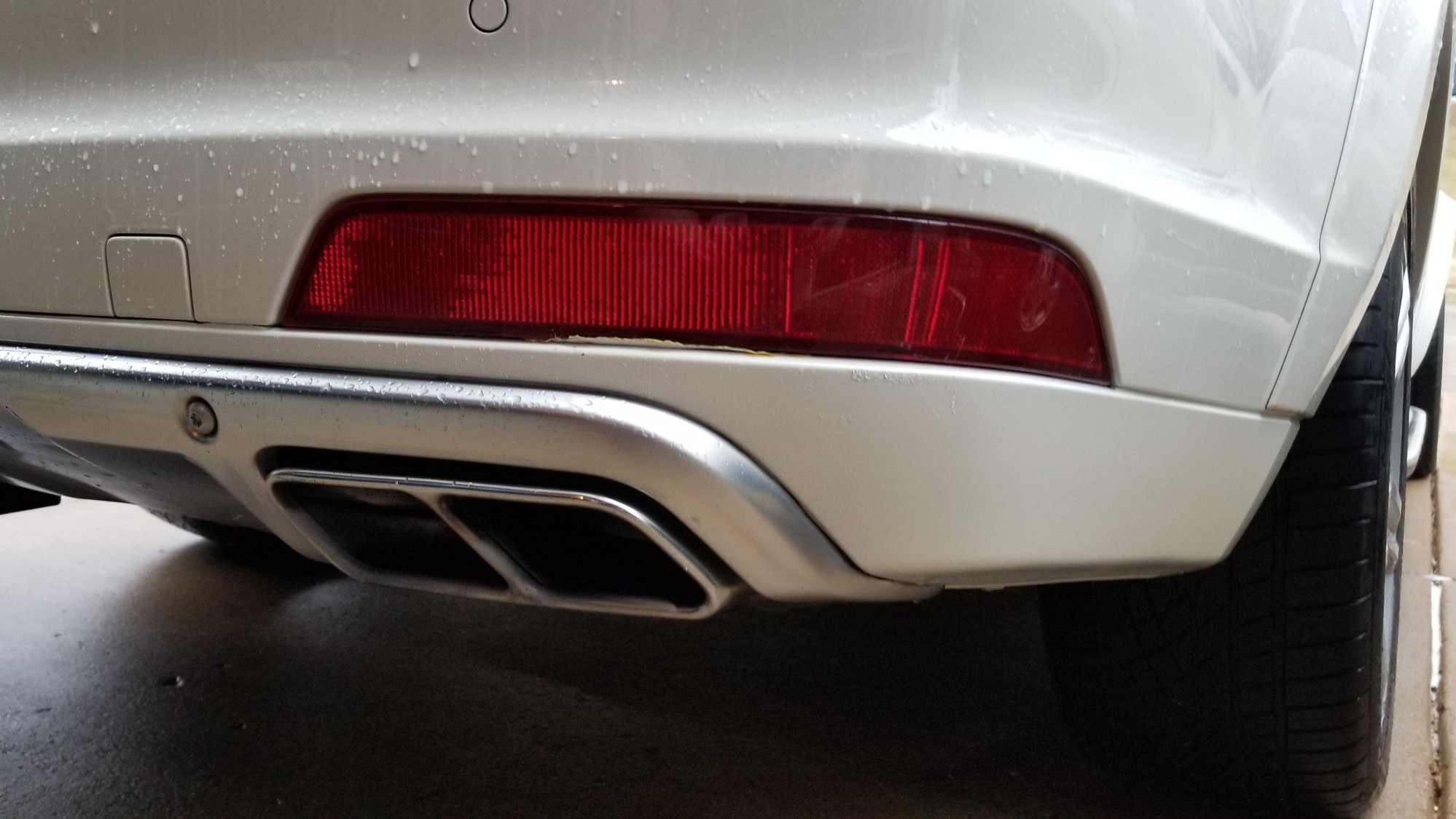

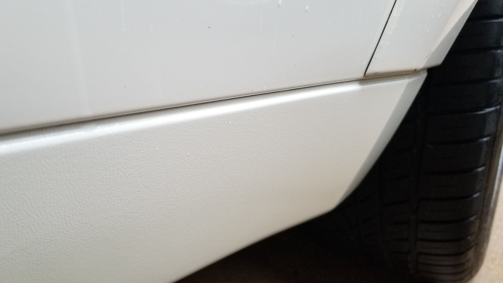

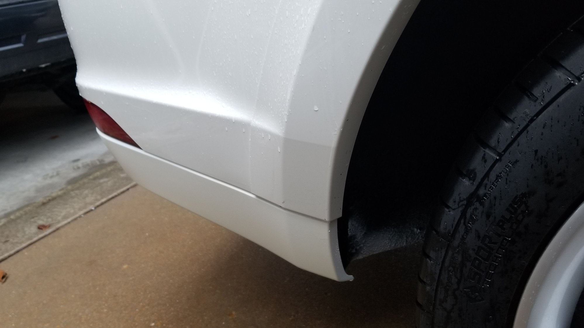

Absolutely I'll take more here within the hour. Again I'm not expert at painting, I took auto collision repair in high school here in St Louis.
kombifan- I'll definitely snap some within the hour. It literally looks like a body kit to some aspect.

Originally Posted by kombifan
Not a fan of the white side steps but the rear bumper looks nice.
More ore pictures of the bumper please!
**MORE PHOTOS**
