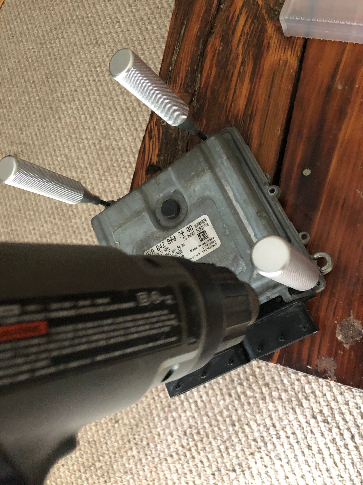

OK, the BDM frame arrived last night, so I removed the ECU to read my file to start the tuning process.

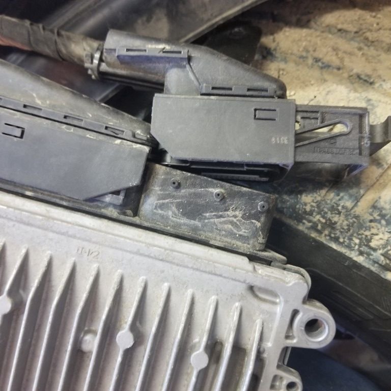

My ECU is located behind the wheel well on the passenger side. The wheel well cover is held in with several 10MM bolts, nuts, and 2 push pins. Once those were removed I was able to fold the cover down which revealed the ECU mounted on a frame. See attached photos.
It took me a little while to figure out how the ECU was secured to the frame. The frame is attached to the vehicle by 2 bolts on the right side of the ECU. I removed those and had to really maneuver the works around to get the ECU where I could access it. Once it was hanging out where I could look at it, I discovered that there is 1 screw holding the ECU to the frame. I likely could have removed that and left the frame in place (which would have made the removal much easier). I will verify this when I put the ECU back in place and update the posting.
Once removed from the vehicle, opening the ECU took about an hour. There are about 6 screws holding the cover on, but it is also sealed with a black silicone or similar adhesive. I used a heat gun to soften the adhesive, and several screwdrivers to pry the cover off. I definitely buggered up the edges a bit prying the cover off, but it should be fine when I re-seal and replace the screws. I see they sell ECU cover removal tools (which appear to be devices you just screw into the bolt holes to pry the cover off). If you have the time, order these. It will undoubtedly save you from mangling the cover as I did. I did not order these as I could not find a seller with them that did not have a month or more lead time. If you can plan ahead you should be able to order them for about $15.

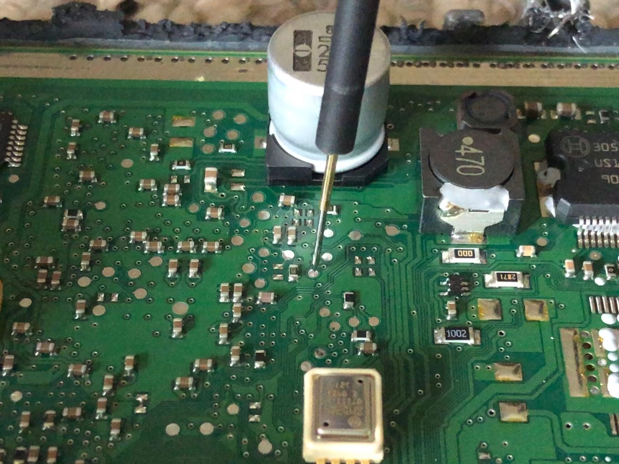

Once the cover was off, reading my file was easy. The KTAG cable required about 5 leads to be connected to the pins on the ECU plug, and 1 connection was needed for the actual board inside the ECU, My BDM frame came with 4 boards and several spring loaded pins. It was designed to be soldered for use. Actually none of the boards was really proper for my ECU, but since I only needed 1 connection to the ECU board I just soldered 1 of the spring loaded pins into a board and used that to make the connection (see attached photo). It worked great. Once connected I loaded the KTAG software, selected my vehicle type, and was prompted to select a plugin. I was not sure which to use, so I guessed #155 from the list of about 6 plugins and tried to read. The software tried to read the ECU, identified it, and indicated it should be plugin #222. I backed out and started again using plugin #222 and the unit read all 3 areas of the ECU (took about 4 minutes). I saved the entire file when done, then it prompted me to also save the files individually (which saved 3 additional files - 1 for each of the 3 areas of the ECU read).
Rather than trying to modify the file myself I uploaded the readouts to a forum I joined specifically for ECU programmers. PM me for information on that. It cost $15 to join, but has been very helpful to learn about this stuff! When I woke up this morning I had already had 3 people contact me to offer the file modifications I requested. The costs ranged from $50 to $100 to modify the file for DPF/EGR/SCR/Flaps delete plus Stage 1 tuning. I went with an offer that was 80 Euros (about $90 US) based upon the users credibility on the forum. I hope to have the modified file later today to write back to the ECU.
My delete pipe is also scheduled to arrive today, so if I have time I will hopefully get that replaced tonight as well.
Perhaps tomorrow I will finally have this DPF nightmare behind me!
ECU on passenger side wheel well
ECU connectors: pull on end to release clips
The EDC17CP10 has 1 connection point on the board, the other connections are on the connection pins. the KTAG software shows exactly how to make the connections.
My ECU sitting on the BDM frame with the KTAG connected.

I finally got around to doing mine, used a drop pin frame and ecu cover extractors. Went very well, used the OBD company in the UK. I wasn’t subject to the VAT as I was an ‘export’ being in the US. Ran me $62 for the remap, included DPF, EGR, Adblue/SCR delete. Resealed it w gasket maker.

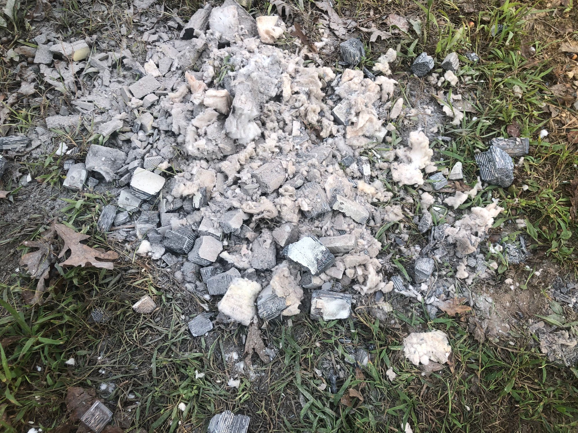

Gutted the DPF today, left the cat for now.
