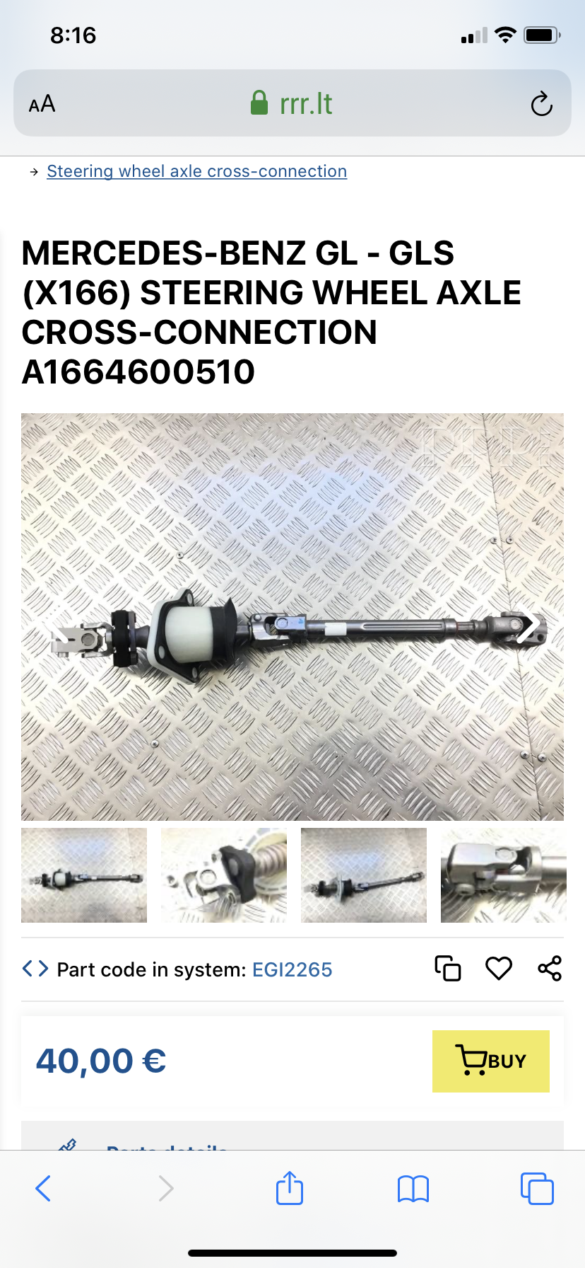

Hi, i had 2007 gl450, 5yrs ago dealer did change all the things as yours but clunking noise still nagging.
Then the last thing they done was replacing/fixing the joints and/or bearing of the steering wheel. No more clunking sounds. Hope this helps!!!

Originally Posted by S-Vibes
could you pls describe a little more the components and or location you’re referring to in the steering wheel? Thanks
check out the post on the pic.
ive replaced these with no improvement. Easy to do though.

I think MB dealer fixed/replaced joints for my wife gl450 2007 like in pic.
https://rrr.lt/en/used-part/egi2265-...oss-connection
