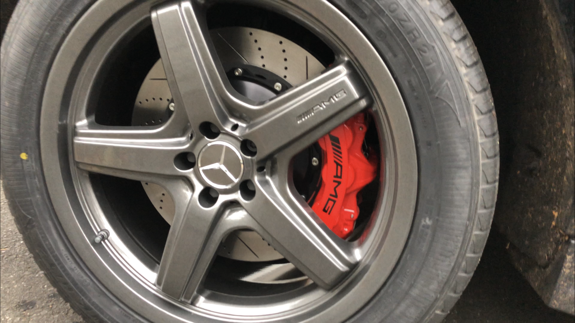

Would you like some additional stopping power? Well here you go! I put this kit on my GL550 last weekend.
Here is a video of my installation:
Disclaimer, I am in NO way affiliated with TEI Racing, I just love their products is all.

Looks great! How is your pedal travel? Has it shortened with the SS lines? The main downside I see is only fitment for 21 inch wheels. Wouldn't be able to run smaller size wheels in the winter.
The manufacturer suggested 20”s should clear, but that depends on the wheel drop center, and spoke style.
Pedal travel isn’t what’s most noticeable, maybe a little, but pedal effort has dramatically decreased.
