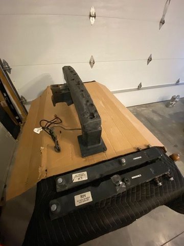

Old Jan 29, 2022 | 08:34 AM
Woody1973's Avatar
Joined: Jan 2022
Posts: 30
GL 450
Here is a picture of an assembly I found on eBay. I will only be towing a boat (or items not needing a brake controller) that has hydraulic surge brake only, not electric over hydraulic. In this case, it appears to have the hitch, bars to attach to the "frame," and the wiring harness plugs. Would you all say this is what I'm describing needing, or have I left something out? https://www.ebay.com/itm/12486942631...Cclp%3A2495737
Old Jan 29, 2022 | 11:35 AM
Tsumi's Avatar
Joined: Nov 2017
Posts: 558
Likes: 114
From: San Francisco Bay Area
2006 R500
That does indeed have everything. I've bought from those guys before locally, they're good people.
I would plan on reinforcing that hitch though where the mount meets the tube. Apparently that is an older design that had the welds potentially failing when towing heavy. A good welding shop can do it for about 200 or so. Good information here on hitch variations through the years: https://www.benzworld.org/threads/wo...earch.1904865/
Old Jan 29, 2022 | 11:43 AM
Tsumi's Avatar
Joined: Nov 2017
Posts: 558
Likes: 114
2006 R500
https://www.ebay.com/itm/07-12-Merce...-127632-2357-0
Based on that thread, this should be the stronger design.

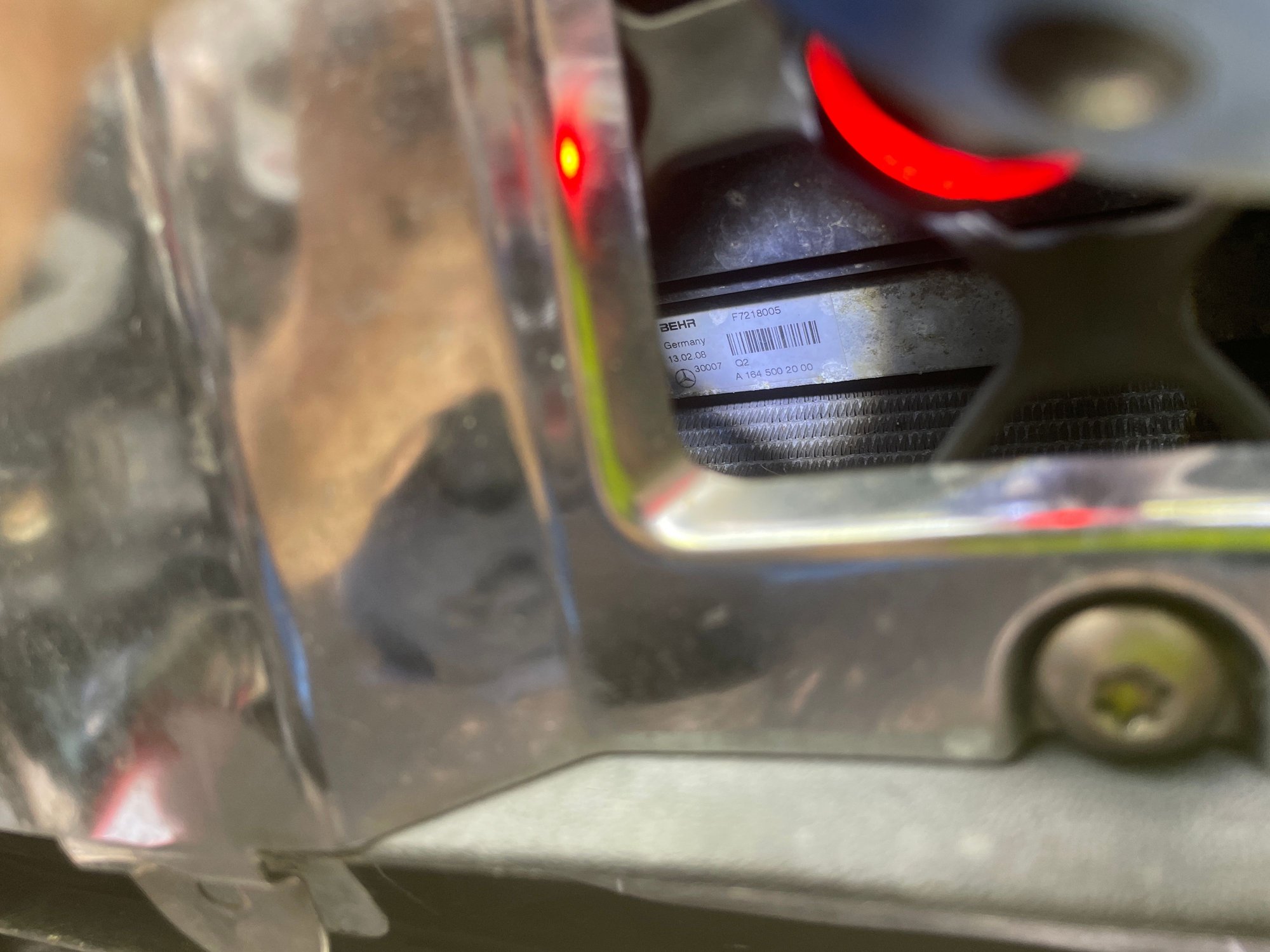

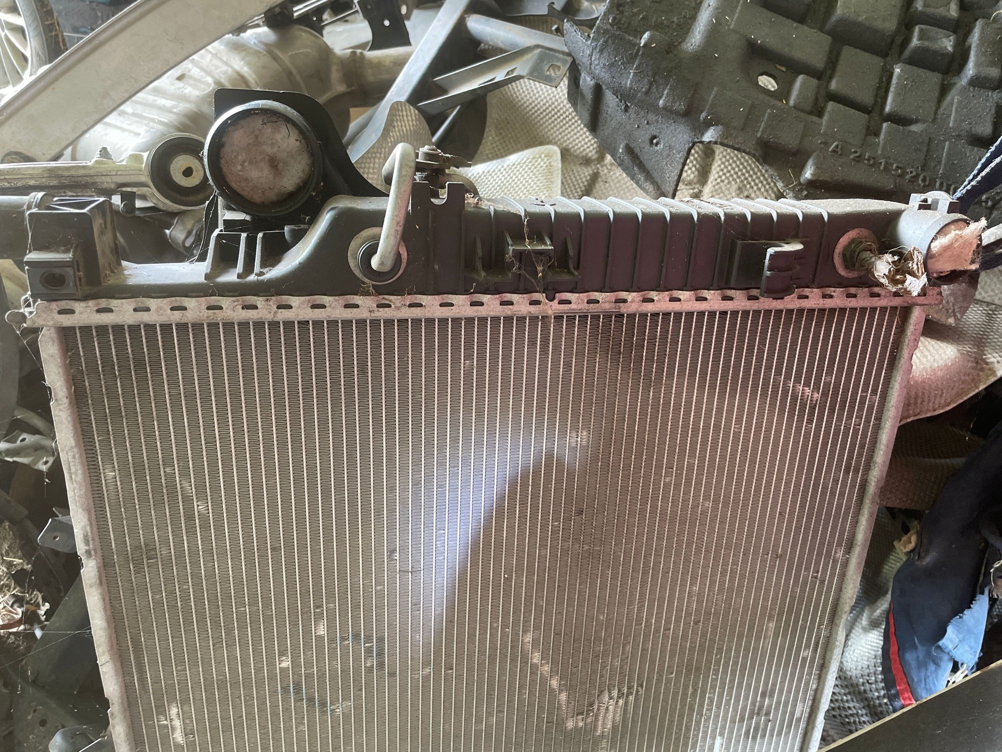

Old Feb 19, 2022 | 09:19 PM
wannawagon's Avatar
Joined: Oct 2015
Posts: 397
Likes: 23
From: Queensalnd Australia
2006 ML320 CDI (2 of) and 2008 GL320
Here are photos of the cooler
one photo is back of radiator. Small aluminium I believe normally to transmission but in this case to additional oil cooler. Small hole with rag is to transmission
other photo is of additional cooler.
Front view
Rear of radiator view
Looking up through middle hole of front bumper bar under tray. Shining a light on part number of radiator
Old Feb 22, 2022 | 12:01 PM
eric_in_sd's Avatar
Joined: Jun 2010
Posts: 2,755
Likes: 628
From: Emmett, ID, USA
2007 GL450
Originally Posted by atraudes
Ours definitely has a separate transmission cooler. There's the transmission cooler that's in the radiator along with the power steering and of course coolant, but there's an additional smaller separate radiator in front of that for the transmission. I know because it was a bear to remove the solid lines going to it while I was replacing the radiator. It didn't look like there was any way it could only be engaged when needed but maybe there was a thermostat inside the cooler or something. I can try grabbing a picture of it later if there's interest.
It sure looks to me like all the trans fluid goes through the supplementary cooler.
What a gimmicky design. And what's more, it looks like the AC condenser is smaller to make room for the cooler.
It just registered that the power steering fluid "cooler" is on the hot side of the radiator. What in heaven's name is the point of that.
Old Feb 22, 2022 | 12:04 PM
eric_in_sd's Avatar
Joined: Jun 2010
Posts: 2,755
Likes: 628
2007 GL450
I bet the H-shaped block has a thermostatic bypass inside it. Otherwise I can't think of a good reason to have such a big block, just to have fittings to hold the tubes.
