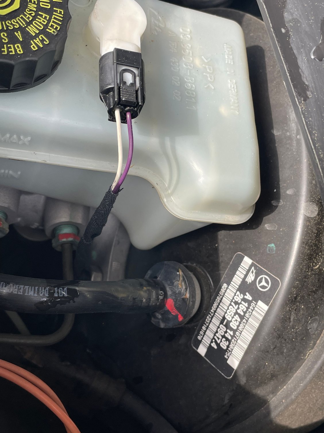

So just crawled under there and took a look at the booster housing. Spotless, clean, dry. No signs of any moisture intrusion, stain in carpet, leaks, drips on firewall. A tiny amount of oil dampness on the pedal side of the bellows, which may be brake fluid seep, or simply grease from the pedal clevis attachment. Brakes remain solid and functional.
The official recall docs note there was 1 case of a corrosion induced failure in Europe, and 1 case in the US. WTH? Recall on short notice 290k vehicles?
Checked the box moving on...
But will continue to wonder the rationale for MB handing this way and not providing advance notice and planning to their dealer networks.
...unless it is an ill conceived marketing ploy to get more people into dealerships for paid service (while doing the recall 'check') or outright create turnover to sell new cars.

Looks to me like they are talking about the outside of the booster housing.
Old May 14, 2022 | 04:22 PM
gb25's Avatar
Joined: Feb 2016
Posts: 33
Likes: 17
2008 gl320
Booster without aesthetic ring:

again, pragmatics carry the day here while hysterics are gonna have a bad time.
I’ve got the affected booster.
It’s bone dry around the circumference. Brakes are fine.
i will drive my GL to the dealer and claim my free new booster when they get their **** together.

My understanding is the issue occurs on the other end, inside the firewall; corrosion inside the (cosmetic) bellows cover. See gb25's post above.
